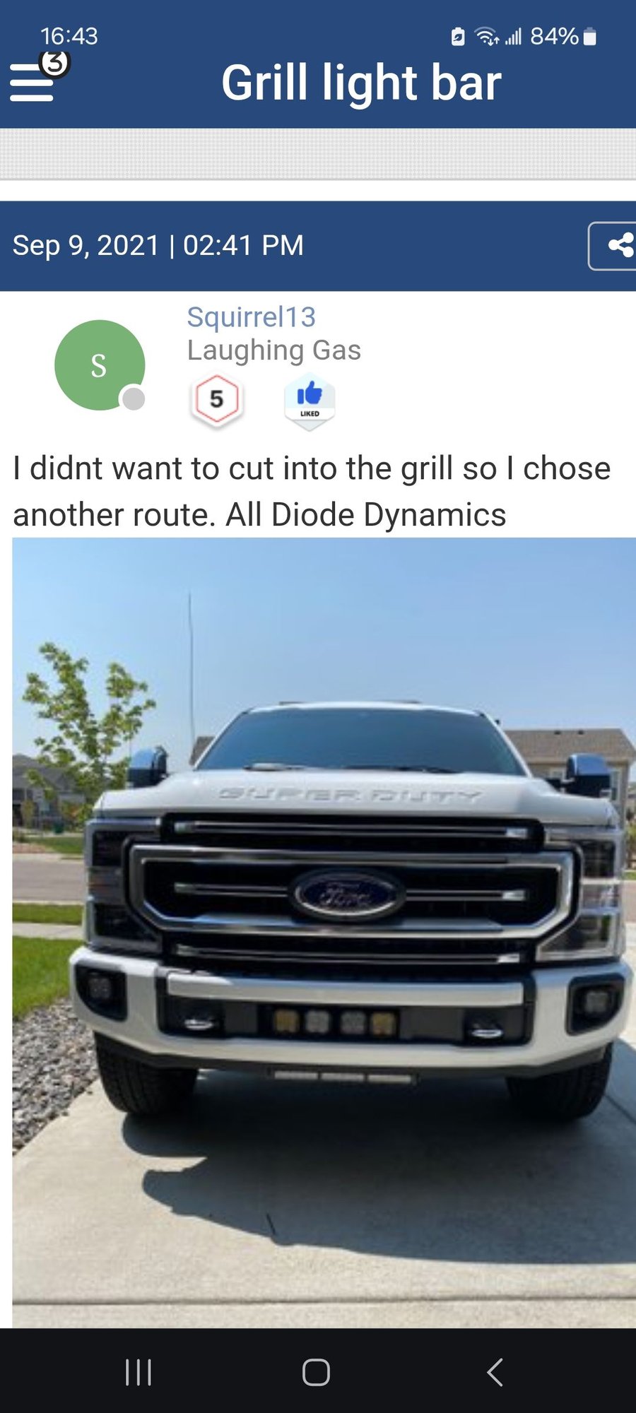

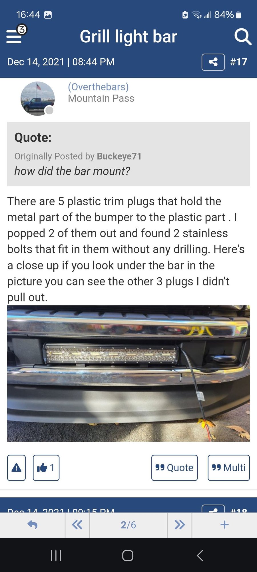

Depending on which grille your truck has, you may be able to cut and notch out the lower part of the grille to have room for the light bar. There are a few threads with photos for this on the Superduty forum.

Sorry for the same answer... there are some trucks over in the newer superduty section with lights in that same spot you mention.

A few from that same thread

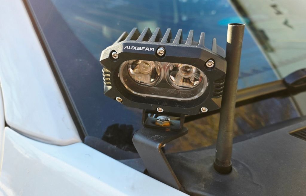

For "Ditch Lights", I installed an inexpensive set of Auxbeam 4" X 2" LED Flood Beam Pods (Pt# ZD000658-CA) from Amazon on a set of Nilight Front Hood A pillar pod light brackets (Pt# 91084B), also from Amazon. Easy installation - ran the switch wiring through the firewall under the dash and mounted the tiny 3/4"X1/2"X1/2" switch, on the left side of my steering column, right in front of my light bar switch (where the previous owner had mounted it)! One is push button and one is rocker - easy to remember which is which! I'm going outside now to put some stuff away in the garage - I'll take some close-up shots and post them, when I come back in!

Drivers side light - I aim themjust a touch forward and a touch down. They have great range and light up both sides of the area youre in, perfectly! I love them, even when out in my poorly lit neighborhood!
Driver's side light - I aim themjust a touch forward and a touch down. They have great range and light up both sides of the area you're in, perfectly! I love them, even when out in my poorly lit neighborhood!

That's a nice clean install. I used that bracket for a CB antenna and it's solid and won't move.

Yeah, I was shocked how solid they were for the price... you really can't go wrong - they'd hold a much larger light than the ones I'm running, easily, for sure!
