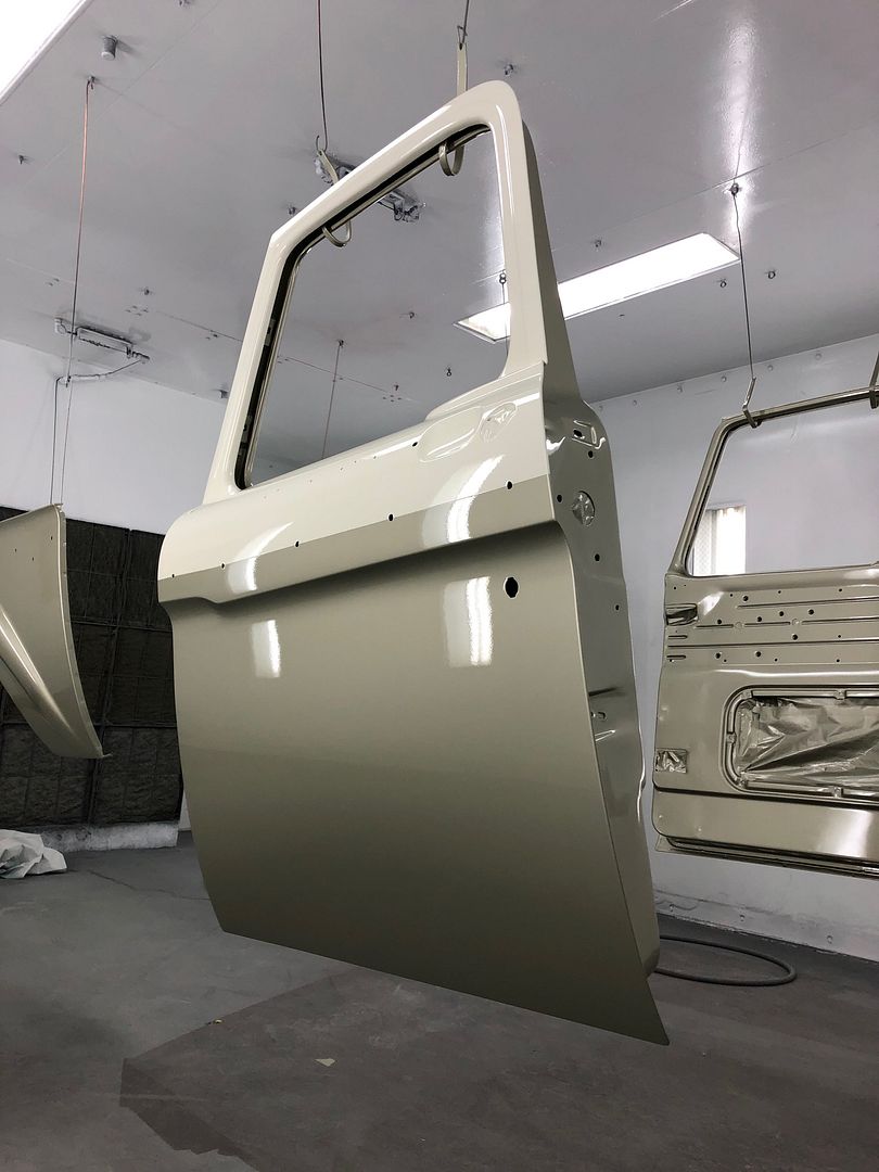

205,001 through 209,999 were built in August 1961 for the 1962 model year. Your F100 came with a 223 6-cylinder engine and was built at the Chicago, Illinois assembly plant. If that's a short bed, then it's fairly desirable. Appears as a Standard Cab not a Custom Cab but that's just from the lack of trim around the windshield so not 100% certain. The doors are unique to the unibody trucks - the body line down the side below the door handles is straight compared to the conventional cab trucks that have a dog leg in that same body line like in the picture below.
If no rust it could probably fetch $10,000 to the right buyer. Maybe more depending.
