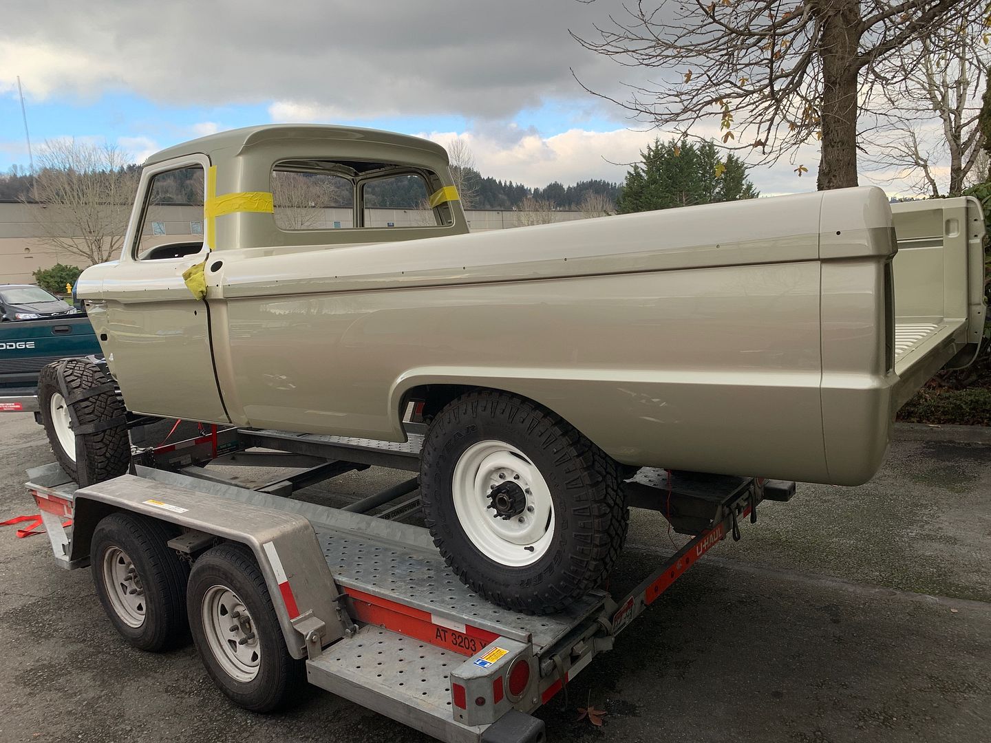

I like my tires. Goodyear Wrangler Mud + Snow LT235/85 - R16. Right about 32" tall. They are mounted on period correct 16" x 6" one-piece "innie" wheels - powder coated but need to be paint matched to the Wimbledon white.

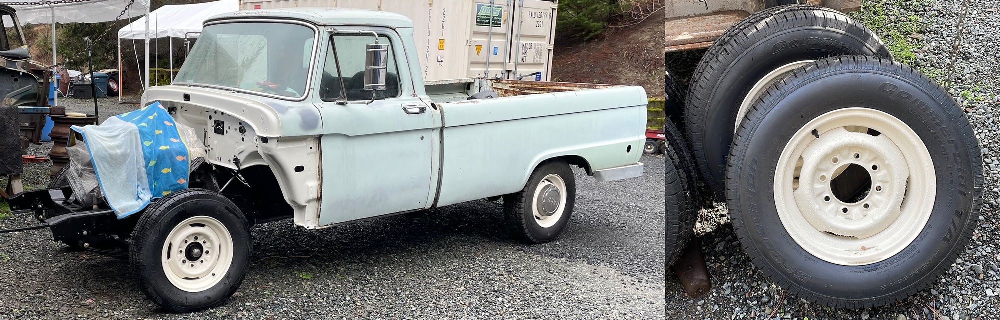

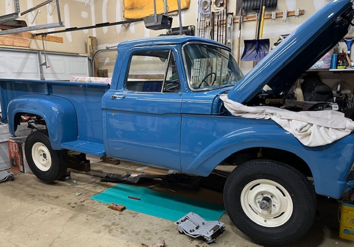

Not the best pics but here is before and after. Had rims powder coated Wimbledon white.
With Hubcap

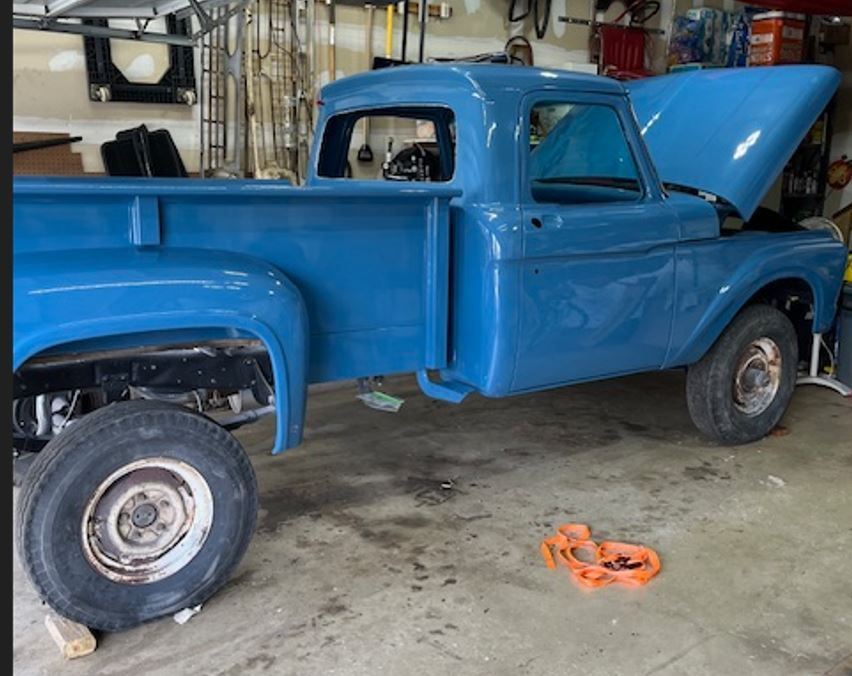

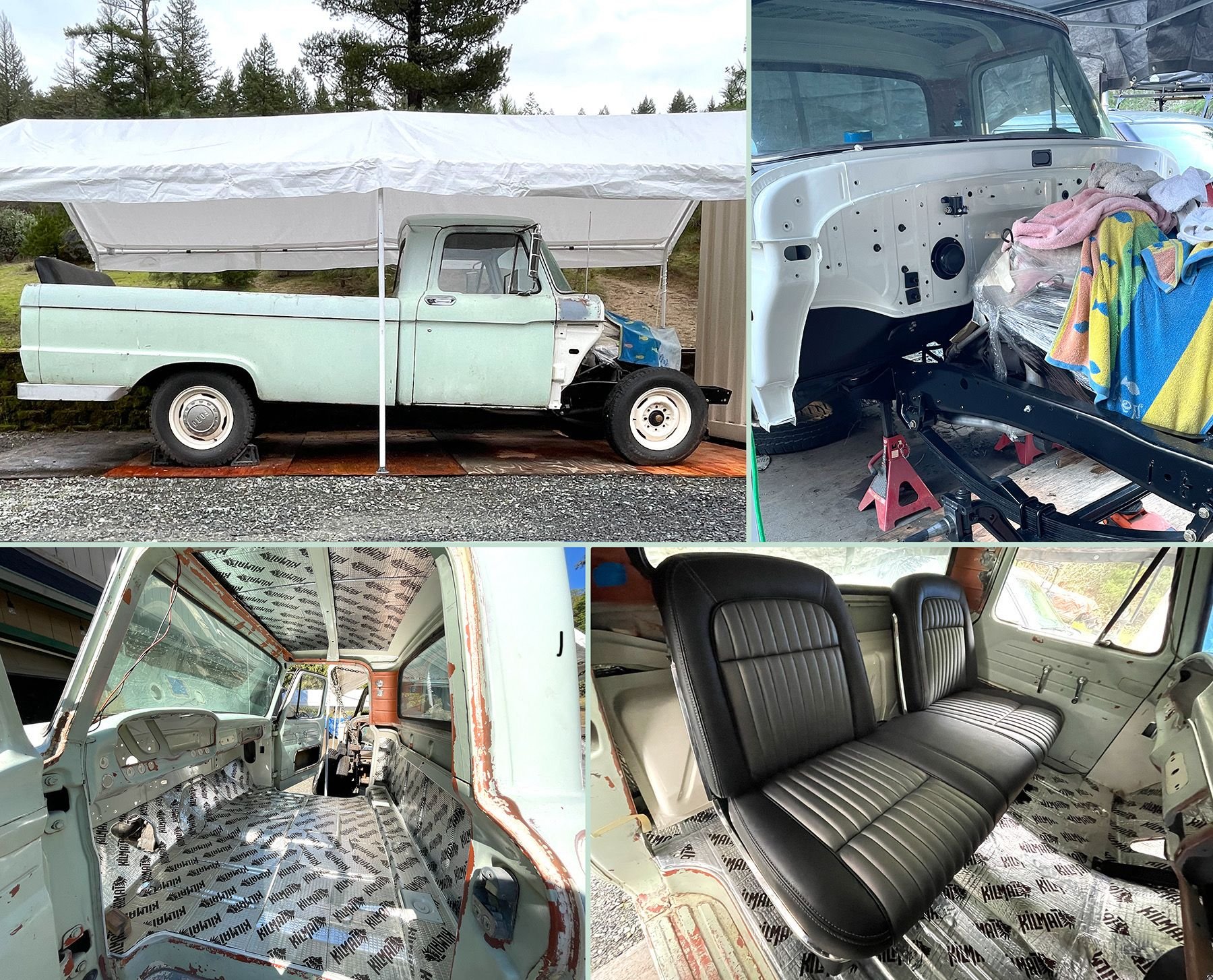

I have lowered my 64 3" so I like the slightly shorter 225's and their skinny look. I think the stock size in 64 was 7.00-16, so Im close to that. In this pic, just the front end is down... The rear will get lowered this Spring.
I think I said this before in another thread, but just in case I imagined that...that bench bucket looks awesome!! OR is It bucket bench? Either way, it looks awesome.

Thanks! It's a '67 T-Bird bench. I just haven't finished modifying the center console/armrest.
Here, here to a peaceful '26. Happy New Year to you and yours!

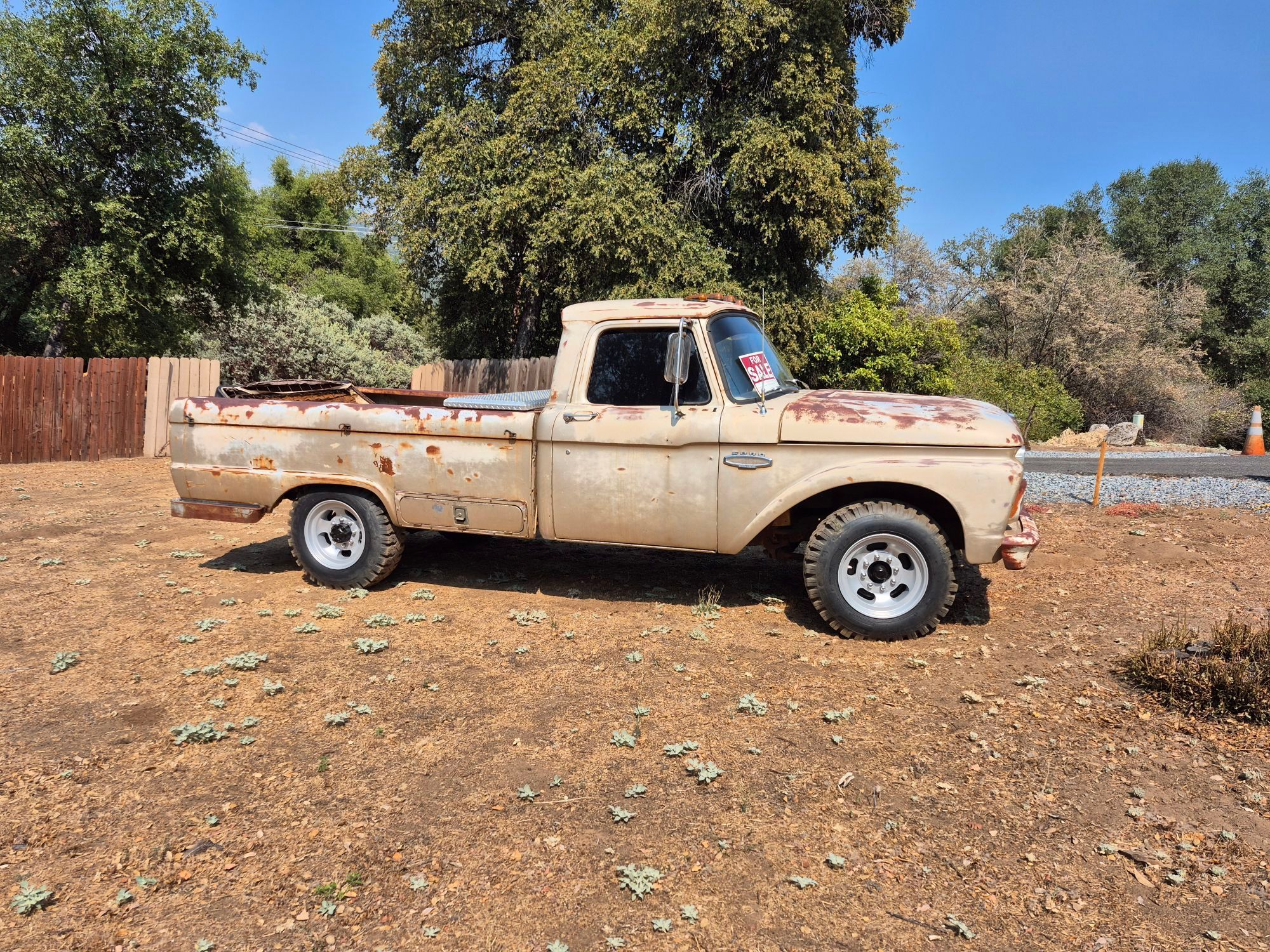

265/75-16. I don't think they could be any bigger and not be in danger of rubbing in the right situations. It's hauled literally tons of firewood and no issues ever.
I should add that is a rear end out of an '81 and is slightly wider than original which means the factory '65 rear end should afford more clearance.

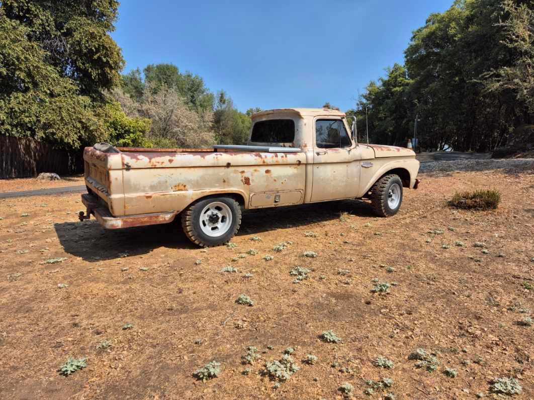

Have had these for a while, had them on my 79 F250 4x but they were a tad small, ended up putting them on my 66 F250 and they fit great, haven't really driven with them much, but on my 79 they were great for wood truck, hunting truck and off-road, decent on-road manners but they are bias-ply so a bit stiff in cold weather initially. They are the STA Traxion 9.60x16.5
