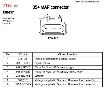

I just dug this up
I know it 05+ but IIRC tgey all same and also the IAT sensor located within MAF sensor for further trouble shoot
