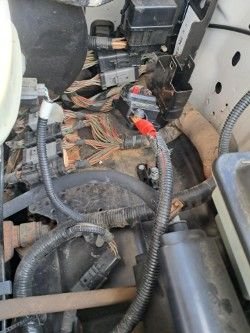

I just purchased a 2003 with V10. It had corroded the junction box on the driverside fenderwell. The PO cut the cables and installed a 150A breaker. It looks like it had 2 12GA fusable links in the circuit. If those were removed will the breaker be ok or will that allow to much amperage and burn something up? I went to Ford dealer and parts dept couldnt find anything? Said harness is obsolete to find engineering # and he could maybe find a wiring diagram, i dont see any #s on the cable. It is from the + battery post to the aux fuses

I have a 99V10 myself. I'll look later, however in 99.9% sure there is no battery cables of the like on the dr side like you have. What or where is it going? thru the dash or?? I dont see why both were necessary on the same line, if I understand you. The link will melt leaving you dead in the water. The breaker will pop and you reset it and go. Obviously if a 150 pops you have a problem, but none the less. Working in a municipal environment with cops cars and fire trucks all of the lighting systems were on fuses or circuit breakers. Either self resetting or manual like the one in your pic.
That wire didn't appear until 2002. It feeds power to the CJB.
