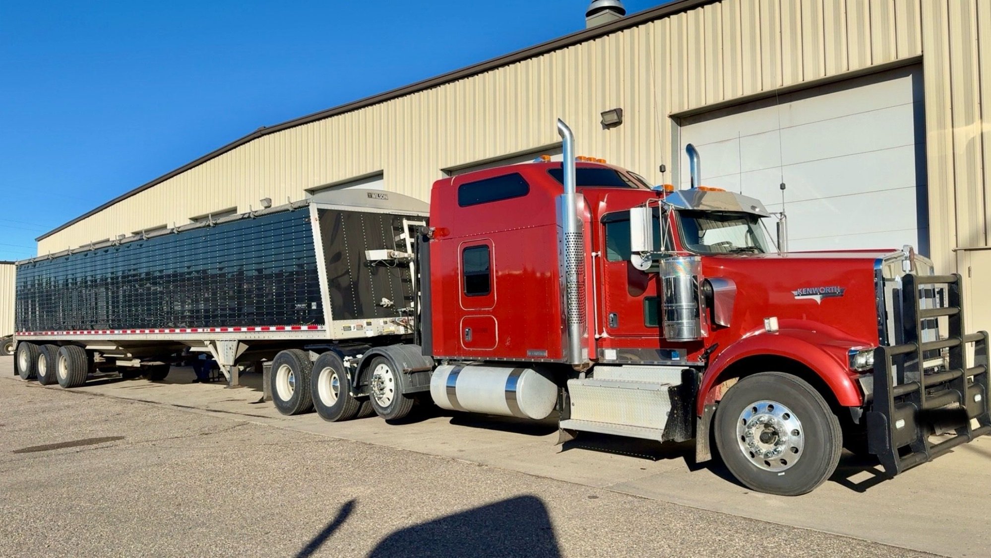

Trying to figure out what you are doing different on your farm compared to our farms?
Rather large ranch in Montana and 7k acre farm in North Dakota.
At the Montana ranch, hardly ever seen pavement, but hard packed dirt roads (lots of off-road).
ND is mostly off-road through field roads and pavement.
Only time we would air down a little was during hunting season or when chains would be needed. 60/80 was the norm with heavy loads which was pretty much constant with fuel tanks/trailers.
We never ran dually trucks. If that kind of truck was needed, the semi's got fired up. Recent addition to the other 7 trucks.
