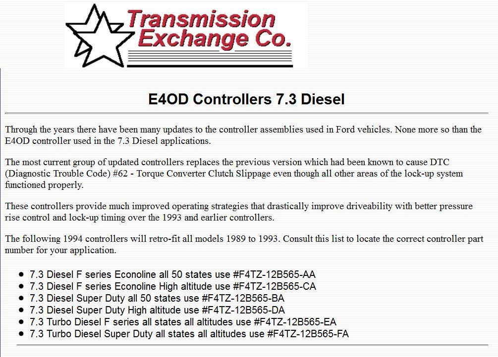

E40D: The Importance Of A Clean Trans Harness
You could also upgrade to a factory '94 controller, which work fantastic and are direct bolt in.
