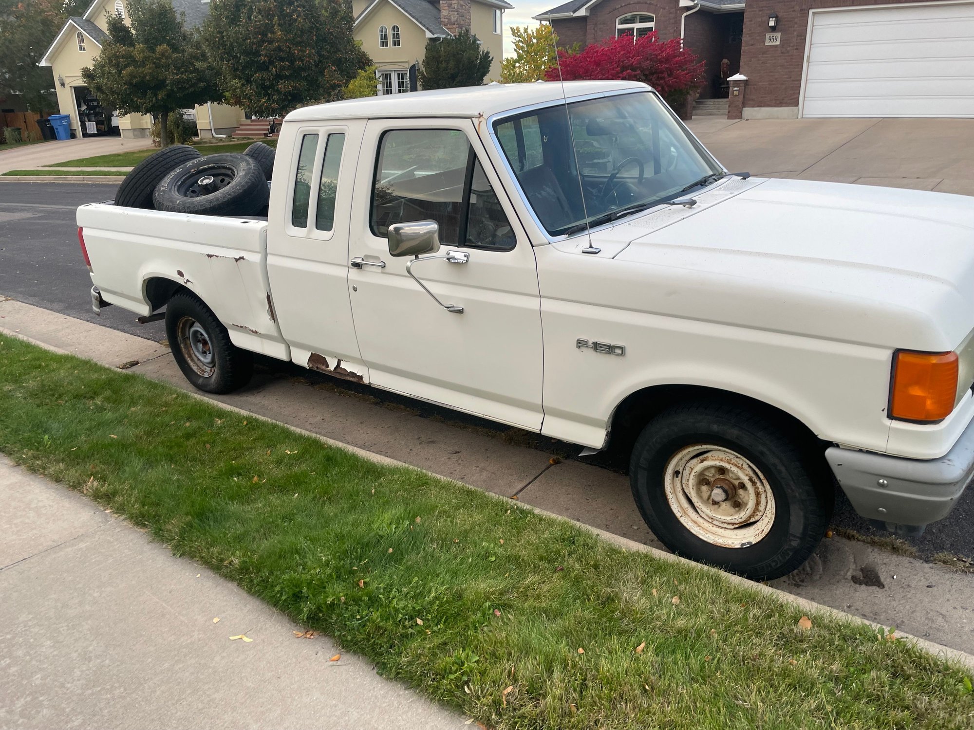

I have a 88 f150 with the m5r2 5 speed that I need to replace the input shaft bearing for and I can't seem to find anything online on where to get a correct sized fit. If anyone knows where I can get one please let me know. I have seen some on eBay that might work but I just have no idea on the sizing of the ones on eBay.
picture of the truck for eye candy
