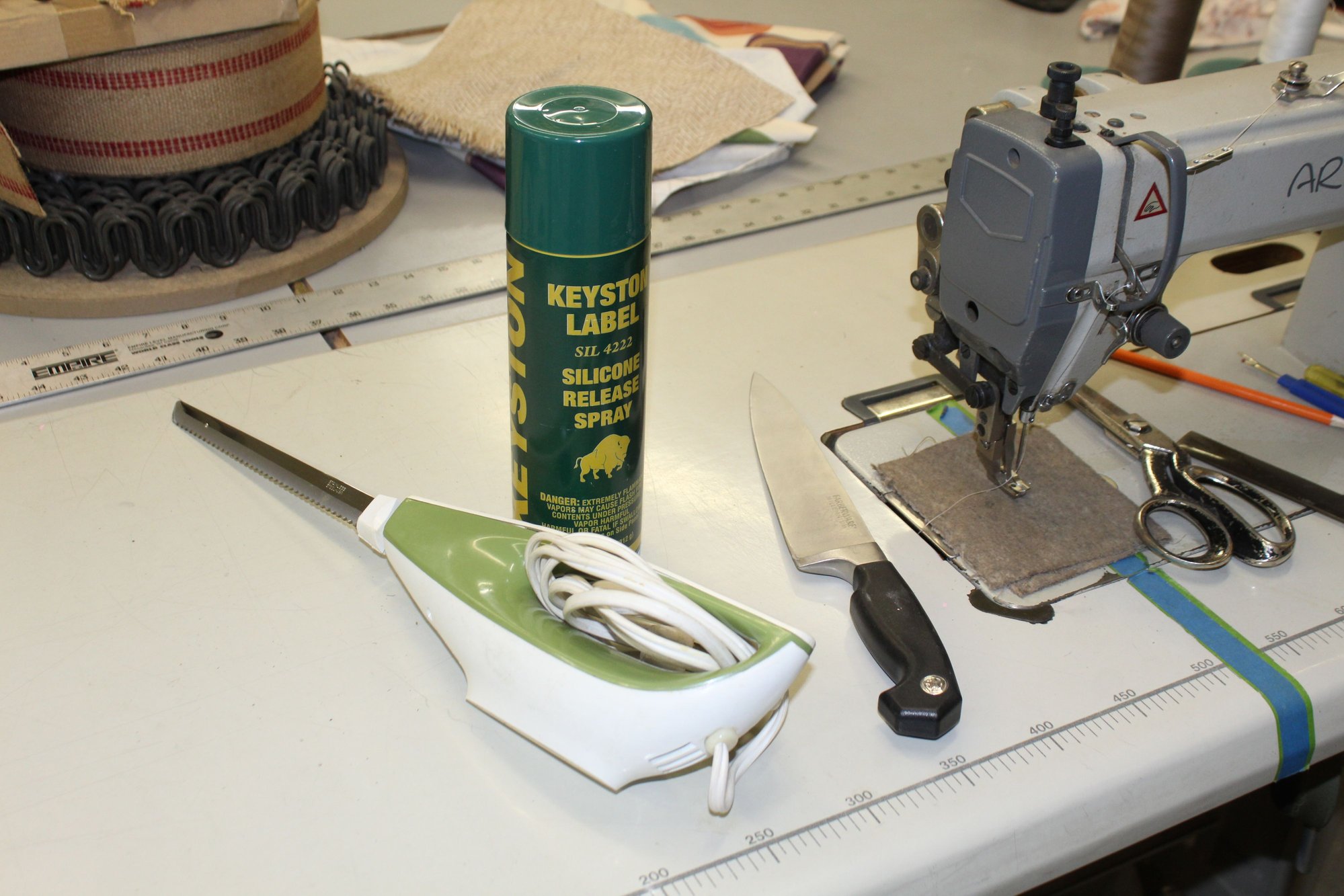

I do mostly furniture upholstery, but Mikey's got the right idea. Don't waste your money ordering a "kit". For the same price you could do your seat 5x over. Here's an example https://www.thefoamfactory.com/openc...m/HD36-HQ.html
You can pick up an electric knife at your local thrift store for about 5 bucks. I've got about 6 of them. Grab a can of silicone lubricant spray and spray the blades every so often. It'll keep the blades from "grabbing" the foam. You can also use a well sharpened chef's knife but takes a bit of practice.

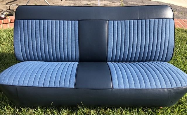

I put a little polyester batting over the foam to take up some of the imperfections before putting on the exterior upholstery. This is a 1978 seat that is in my 63 Uni.

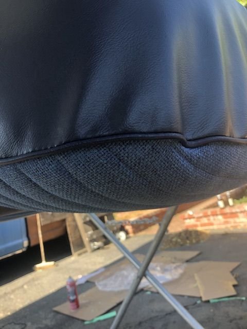

You will put the upholstery on and see the wrinkled areas that need more foam.
This is a pic of the upside down seat bottom with a test fit of the upholstery. I wound up using the Camie 303 spray to attach more foam and then the flap wheel to shape the corners.
Make sure you repair any issues with the steel seat frame and springs.
