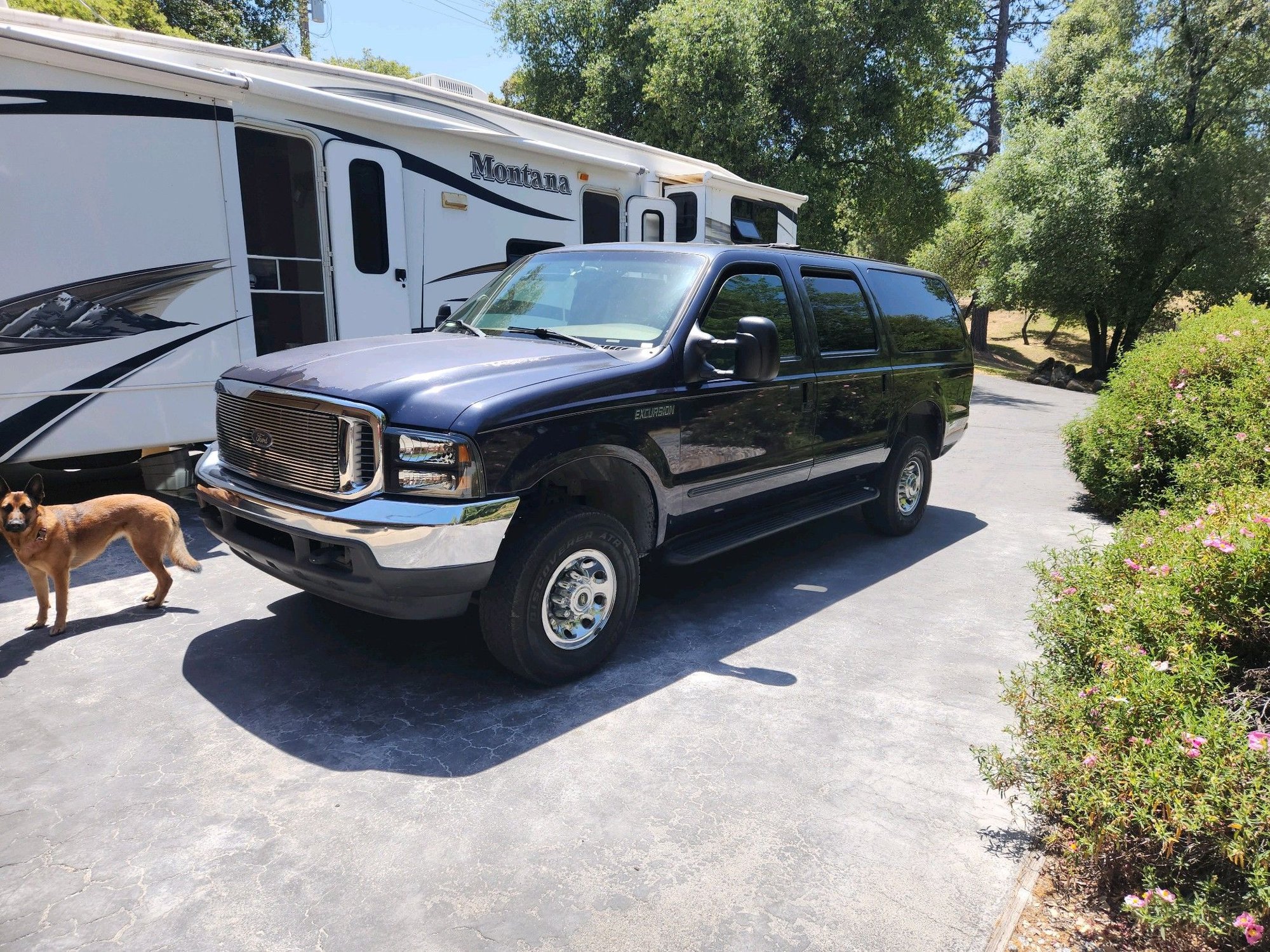

Personally, I would re-gear first, especially since your looking at lifting it, once lifted you will want bigger tires, and then you'll be hating it with the 3.73's...
I have a 2000 Ex/2wd/5.4 the PO had I believe a 4" lift, when I bought it, he had taken off the 35's and put the stock 265 tires/rims on it, looked like a scared cat... I knew I was going to go back to 35's, and I had already found new, unused rims for $300, so I drove it home and around for about a week with the scared cat look and it did ok, got the 35's installed and the lil ol 5.4 was working to get big Dory moving, ended up going with 5.13's and a Tru-trac and it really woke her up, she will chirp the tires taking off, it's still a 5.4, but the 5.13's/35's completely changed the driving experience.
Big Dory
