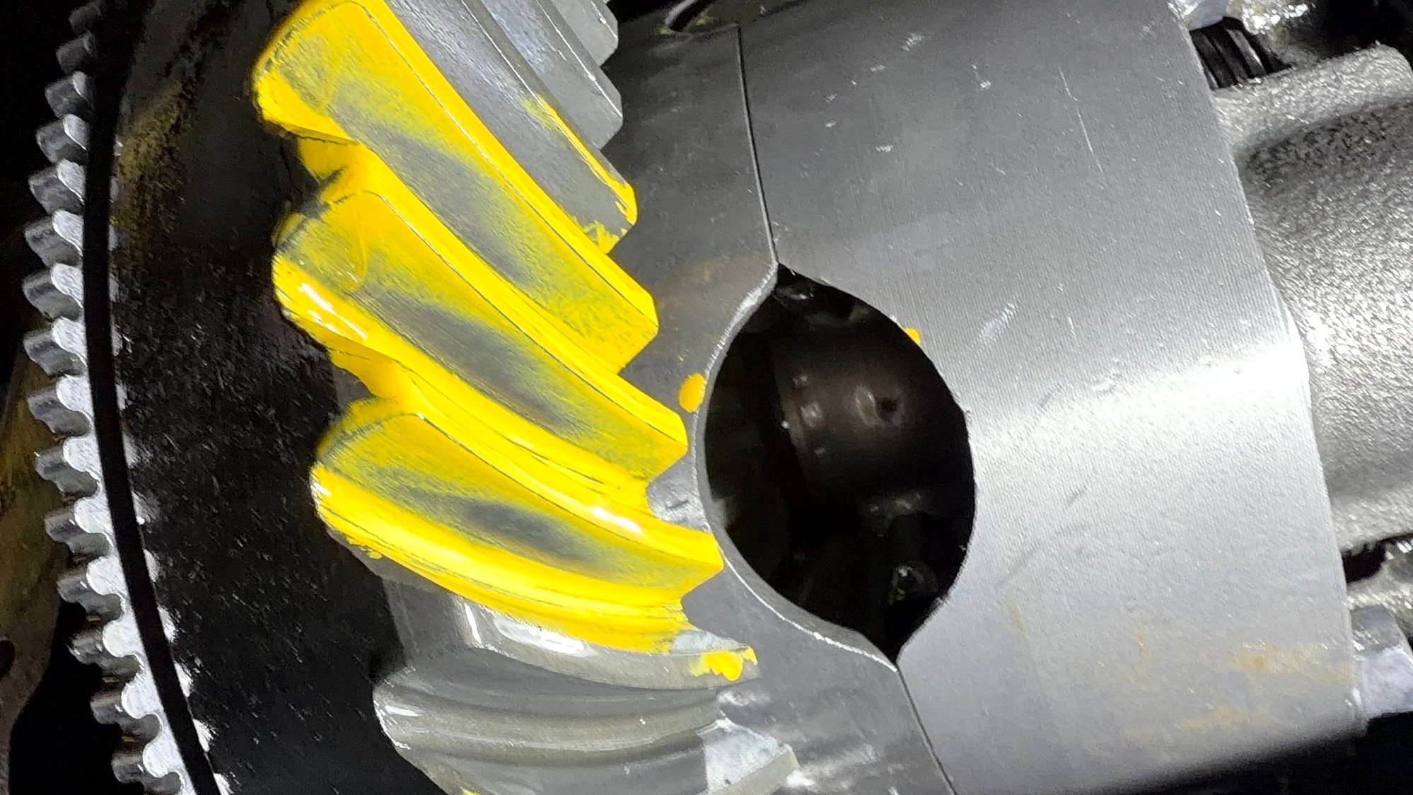

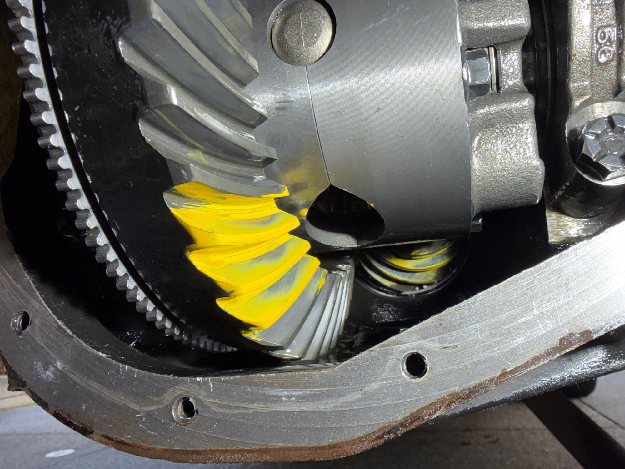

This morning, I jumped back into this. The LubeLocker gasket came open nicely. It’s nice not having to clean old gasket and RTV off of anything. The actual wear pattern on the gears was easy to see in the attached photo. Even though the pinion is not running off the face/edge, it is clearly on the shallow side and appears to me that it could be moved towards the flank/root.

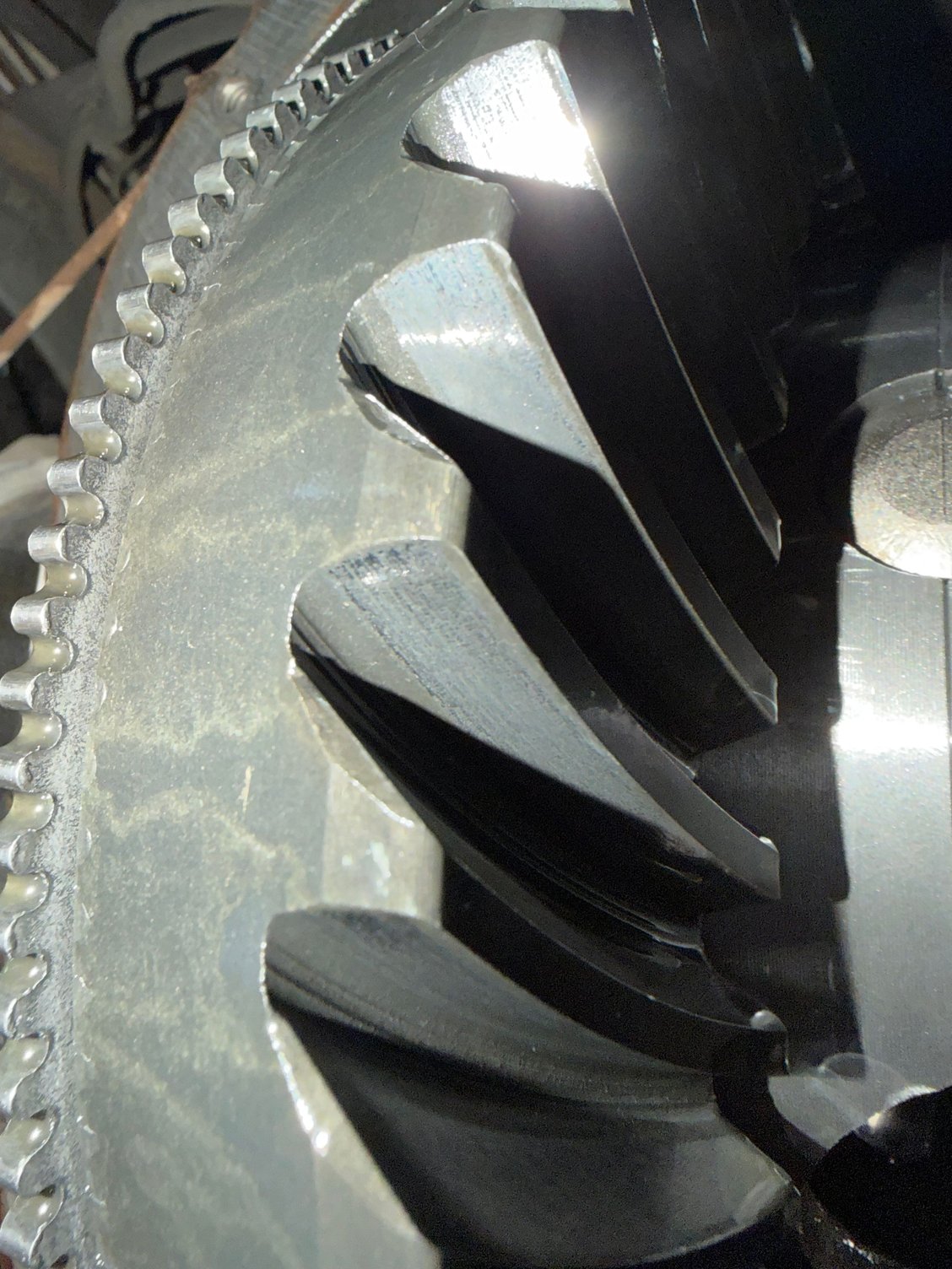

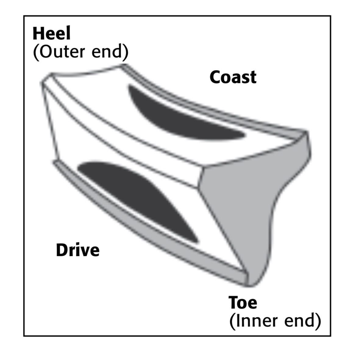

The OE pinion shim was .036 and left a classic half moon, the pinion being too close/deep. I didn’t take a picture, but I’ve attached the image from the Yukon install manual that depicts it.
After 4 setups, I’m at .028 right now. Even though the pattern appeared suitable, the whine on acceleration suggests the pinion is still too far/shallow, so I’m going to split the difference and add .004 to see if I get a decent pattern. If not, it’ll be narrowed down. Even with the worst case scenario, at .001 increments, I only have a few setups left. There’s light at the end of the tunnel.

.028
.028
.036 (OE Pinion Spacer)

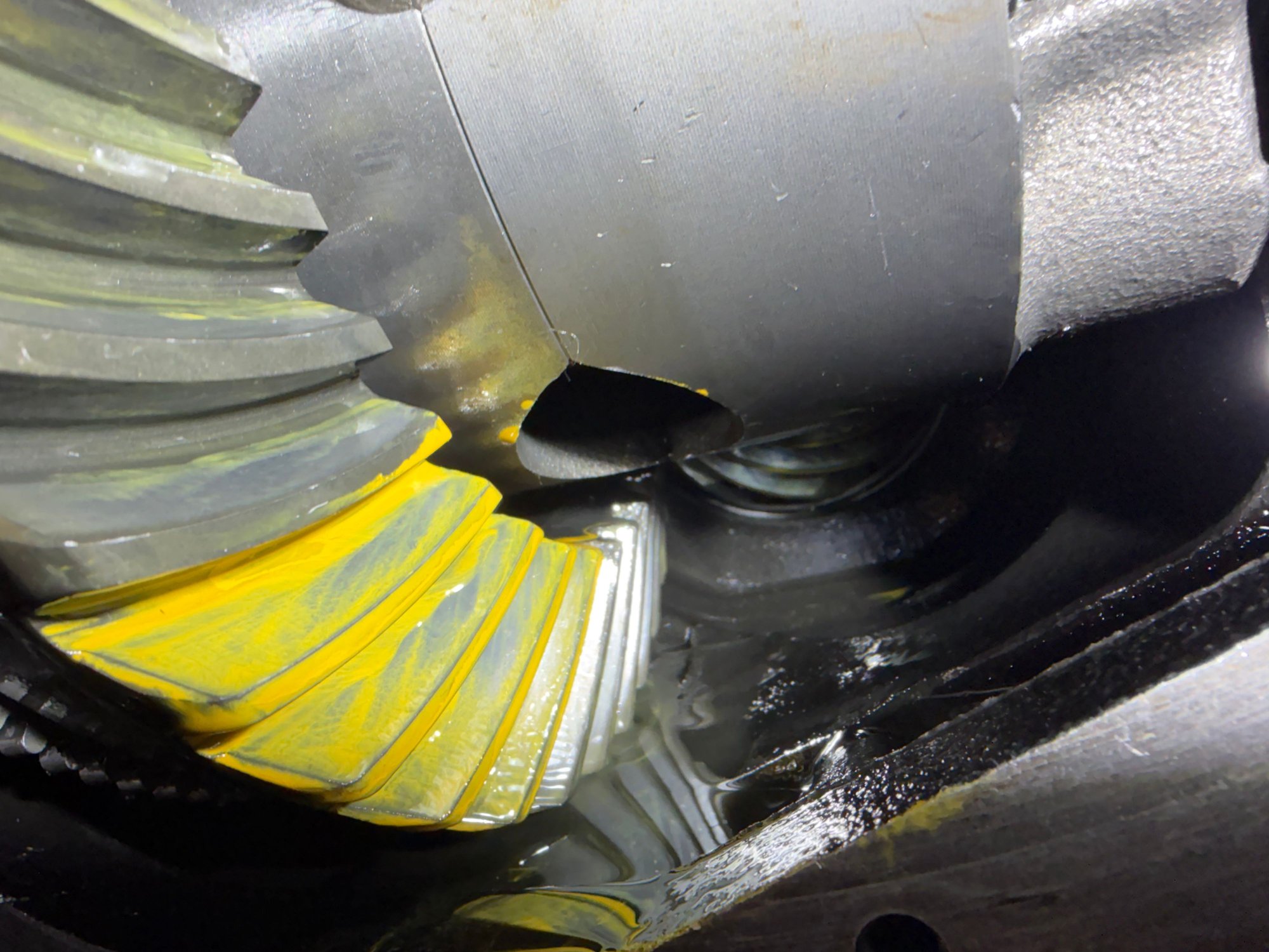

.032 appears to put the pinion too close/deep. Next up, .030.
.032
.032
.032
.032

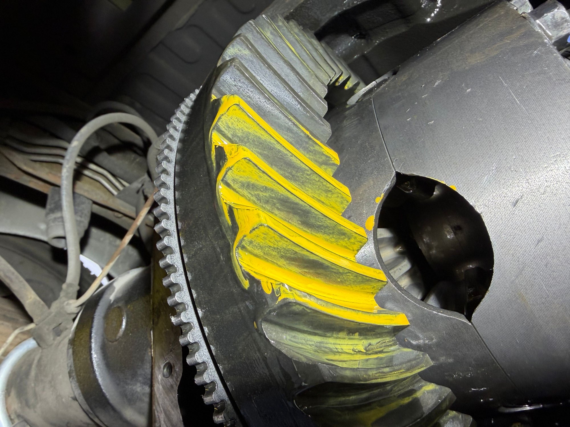

.030. Appears suitable. Not much different than .028, which was whiny at 55mph+, but hopefully the extra .002 is the fix for the whine. I'm going to button it up and give it a try.
.030
.030
.030
.030

No dice. Now it whines briefly at takeoff, then is quiet until 50mph, then the whine returns. The whine is still only on acceleration. Basically, no change. I guess it’s not surprising, given the similar pattern between .028 and .030. Backlash was set at 6 again, within the range of 6-10 from Yukon.

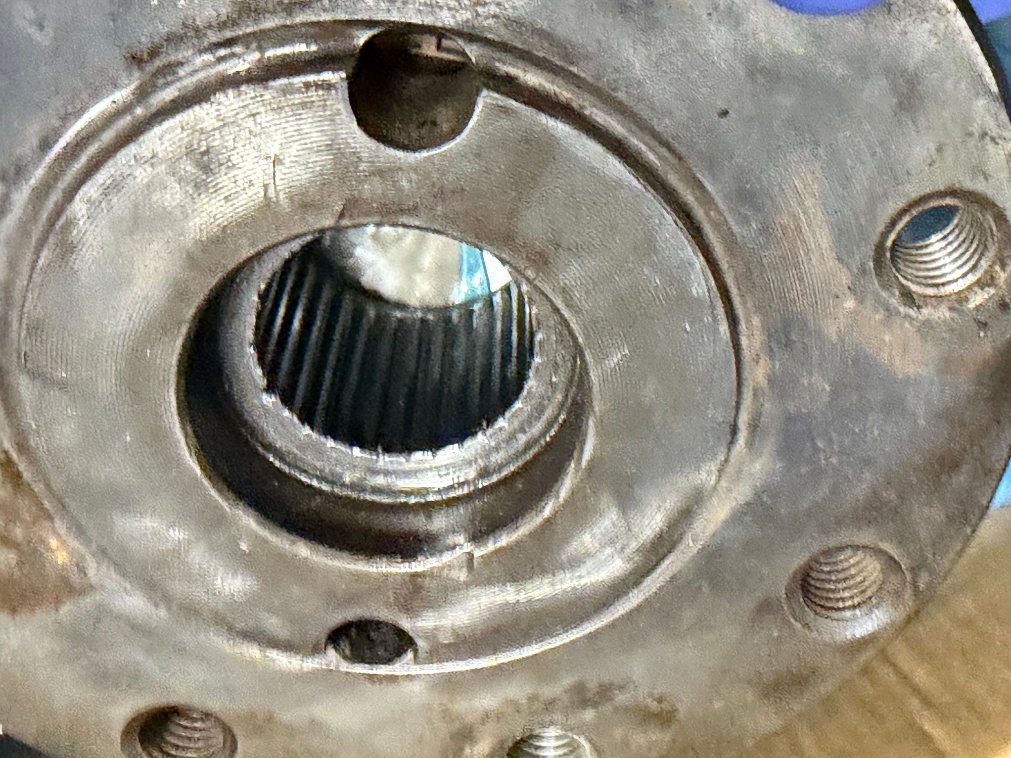

The day wasn’t a total loss. I replaced my tired looking flange/yoke with a new one while I was in there. I had previously noticed the OE flange was shedding metal where the pinion nut clamps down and the splines were looking worn in spots.
Looking forward, I’m inclined to go back to .032 which I posted previously. It appeared a touch on the deep side to my eye, but left a much more defined pattern in the paint. Maybe that will yield different results. I’m also considering just putting my original Ford 3.73 gears back in.
If anyone has any thoughts on those patterns, I’d appreciate it.

OP, you're likely wasting time (and gear oil) continually resetting the gears. IMHO that last drive side pattern you posted (in post #18 above) is fine. If that's where the gears still are, then I say run-em, do the recommended break-in procedure, and reevaluate noise after the break in.
