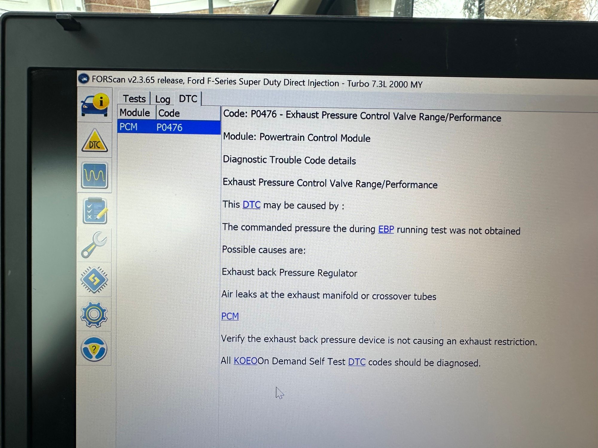

I now have Forscan. It is indeed saying possible ebpv regulator? So has that been it this whole time and I just wasted a bunch of time and money? If the ebpv solenoid is faulty would having the block warm make a difference since it's oil related?

The pic above is from the forscan KOER. I think it said on demand test maybe? This is the only code and there are no check engine lights on.

When you ran the test, did you hear the valve close and open? It would have sounded like you were choking off the exhaust with a pair of vise grips. If you didn't hear that, it's probably seized open. If that's the case, it's really nothing to worry about fixing immediately.
