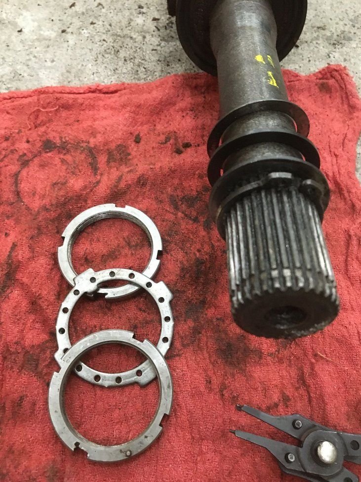

Auto hubs need a special hub socket. I’ll post a pic below. As JS30 said, the lock ring can get buried in grease.
If swapping to manual hubs, you’ll also need the manual hub wheel nuts, two nuts with a center lock ring. You will need the socket for the nuts as well.

Manual hubs wheel nuts and lock ring. You will also need a set of snap ring pliers to remove the axle shaft thrust washers and circlip.
Auto hub nut with lock ring installed.
Auto hub nut lock ring.

That little keeper got me when I did my front-end last month. I didn't know about it and everything I looked at showed the double spindle nuts for manual hubs which is what I have. Turns out when the previous owner had it changed from auto locking hubs to manual the shop didn't use the double nuts. They left the original nut and keeper in place then used the inner ring of the auto hub to hold the keeper in place. There was actually nothing holding the keeper in place but grease and luck. I knew the previous owner and remember him having the manual hubs done. The receipt was in the glove box and sure enough the new spindle nuts weren't on the receipt.
