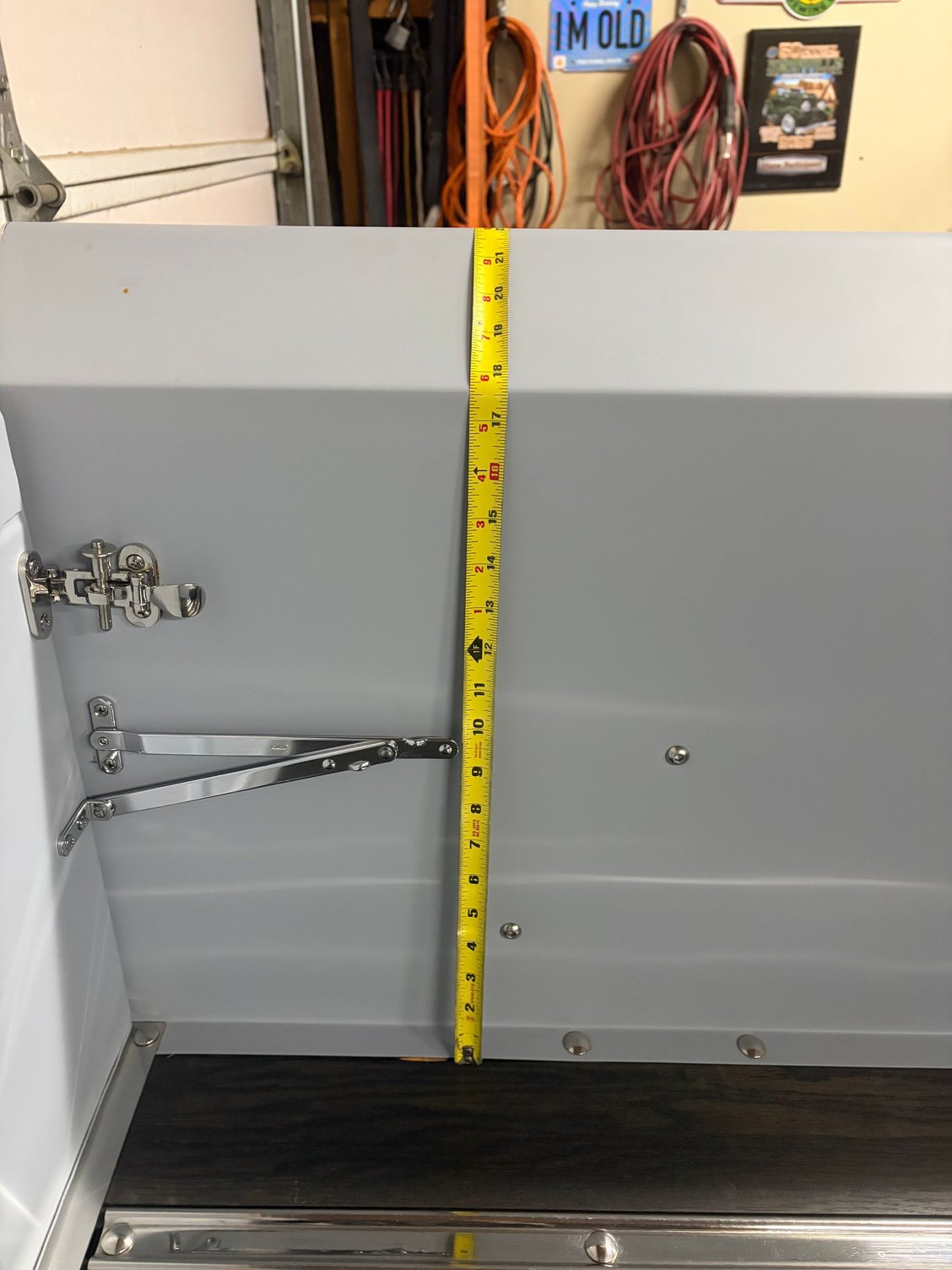

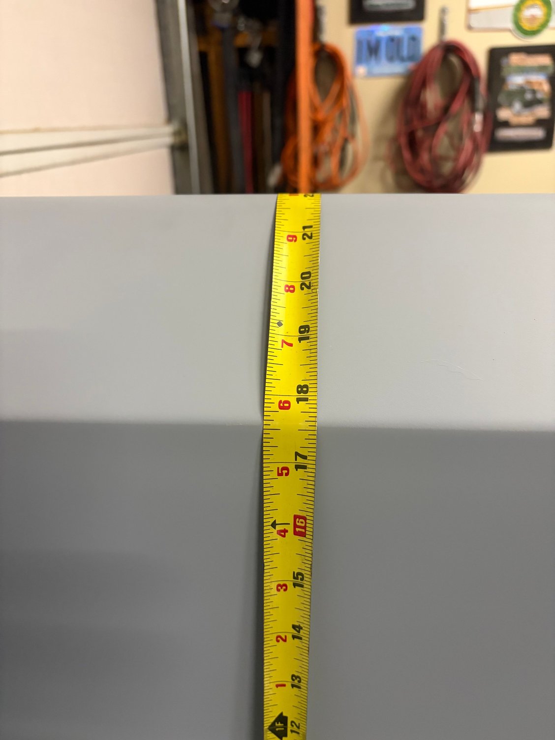

Just purchased a 1956 F100. The previous owner welded in a steel bed floor from a later model. I'd like to remove and replace with wood. Would someone please measure from what appears to be a 1" ledge for wood to set on, up the bedside to where the angle bends outward. I'd like to check that against my bed to see what I am up against. I think the steel bed is welded in above the ledge, but it is such a hack job I can't be certain.
Thank you!

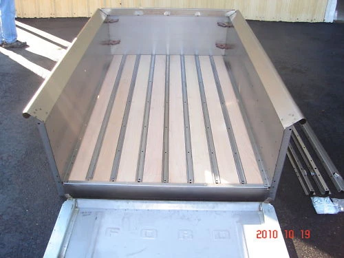

The wood sits below that 1" ledge. The outside boards need to be routed for the ledge to sit on. If the PO hacked up the bed by welding the metal floor in you might be better off buying a new bed.

Old Dec 8, 2025 | 07:06 AM
avf100's Avatar
avf100
Joined: Oct 2010
Posts: 2,091
Likes: 599
From: Lancaster, CA.

If it were my truck I would keep that bed if you feel it’s original. This would be tedious but cut out that steel sheet. It can’t be that thick. Use a cutting wheel the wood as the guys said attaches under that lip. After you have done your cutting you can back drill the holes. I bought my wood and wear irons from a company in OKC really nice oak and stainless. They also sell beds but the originals are much nicer and made from heavier steel. I did this with my 1954 F-100 I bought in Oklahoma it was an oil field truck, and a piece of steel was welded. It was thin steel and served its oil field purpose. Don’t get me wrong it’s hard it not difficult to do. But I was glad when I seen the final result.
