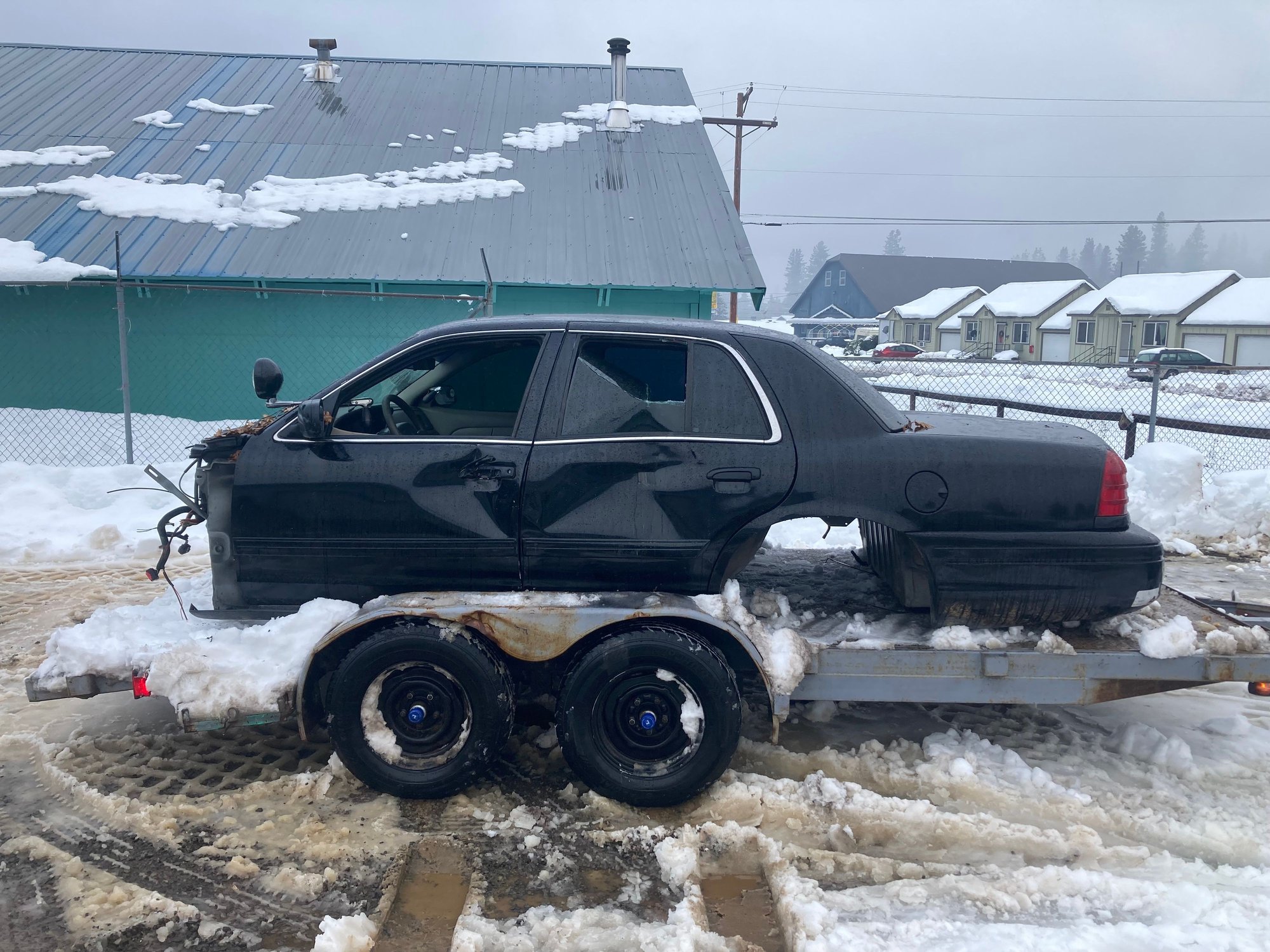

The bolt pattern on a 55 322 Nailhead is it's own. Nothing will work without an adapter to the tune of about 6 or 7 hundred bucks. I know some of you are going to be pissed but. I just happened to have a free low mile Crown Vic PI my cousin gave me and a buddy that is the crew chief for a pro 4 off road team and he had an idea. And I knew he had the fab talent to pull it off the right way.

You are correct the wheel base is wrong the track width is also wrong. So most guys that attempt this swap start with a long bed and cut the bed to the correct wheel base. Ok I can live with that. It's now a what? not a short bed not a long bed it's a new model a medium bed. Now for the track width it does not fit. No worries pie cut those beautiful canted in fenders pull them out and fill in the pie cut. Right......Wrong. First you have to take 4" out of the length of the frame simple, Then have the rear end narrowed, We took out 3/4 of an inch on both sides should have went 1".So far no biggie. Here is the tricky part. As you said off set wheels well the offset on the Vic poverty wheels already have a heavy offset. Ok but we want to run them because they almost look correct on the truck. That's when a talented friend comes in well unless you have the skills your self. I'm a pretty good mechanic but not that good. So my buddy says I'll just narrow the A arms. He made a fixture and brought them in an inch and a half both sides. I could put them on a table in front of you and you wouldn't be able to tell they were ever touched. Here's the part that made me cringe. You have to cut the inner fender wells and I mean a lot, And the fire wall a lot. Where the step is when you open the door it gets smaller. And the bottom of the back of the cab. But in my case it had some bad rust anyway. Could have been the salt.
I will post some pic's have to find them. Oh I forgot 2011 PI

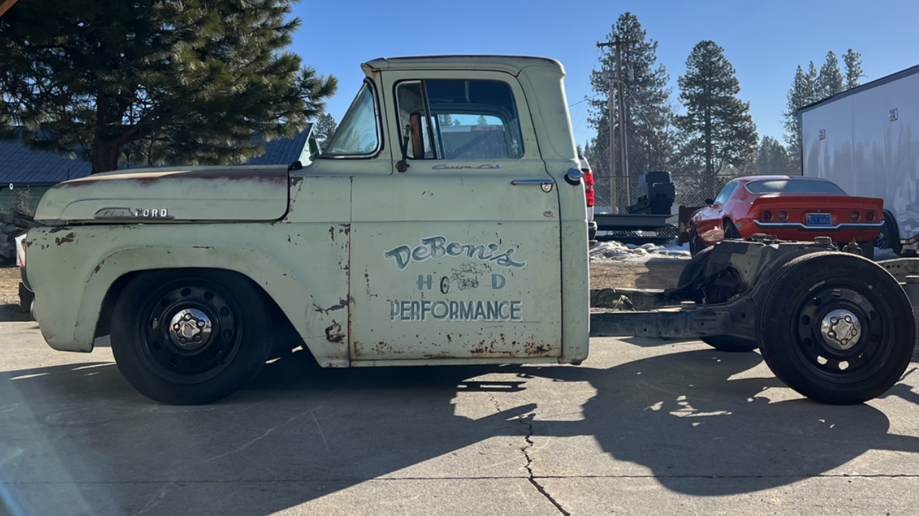

im getting my dads f100 going too same year. It’s got a i6 223 I wanna keep. I’ll be grabbing a cv front suspension from a 2006 i traded beer and burrito for.
How it started
How it started
Big step notch so I can lay frame
