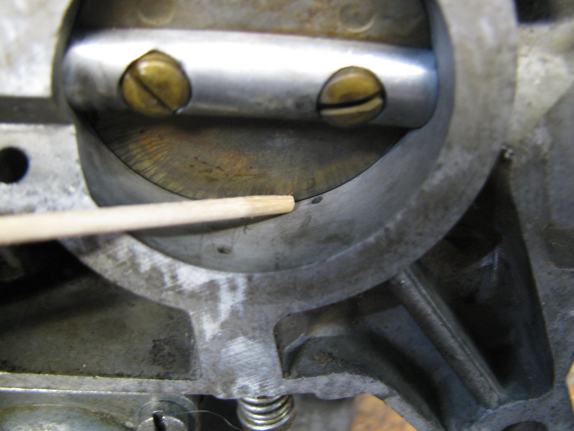

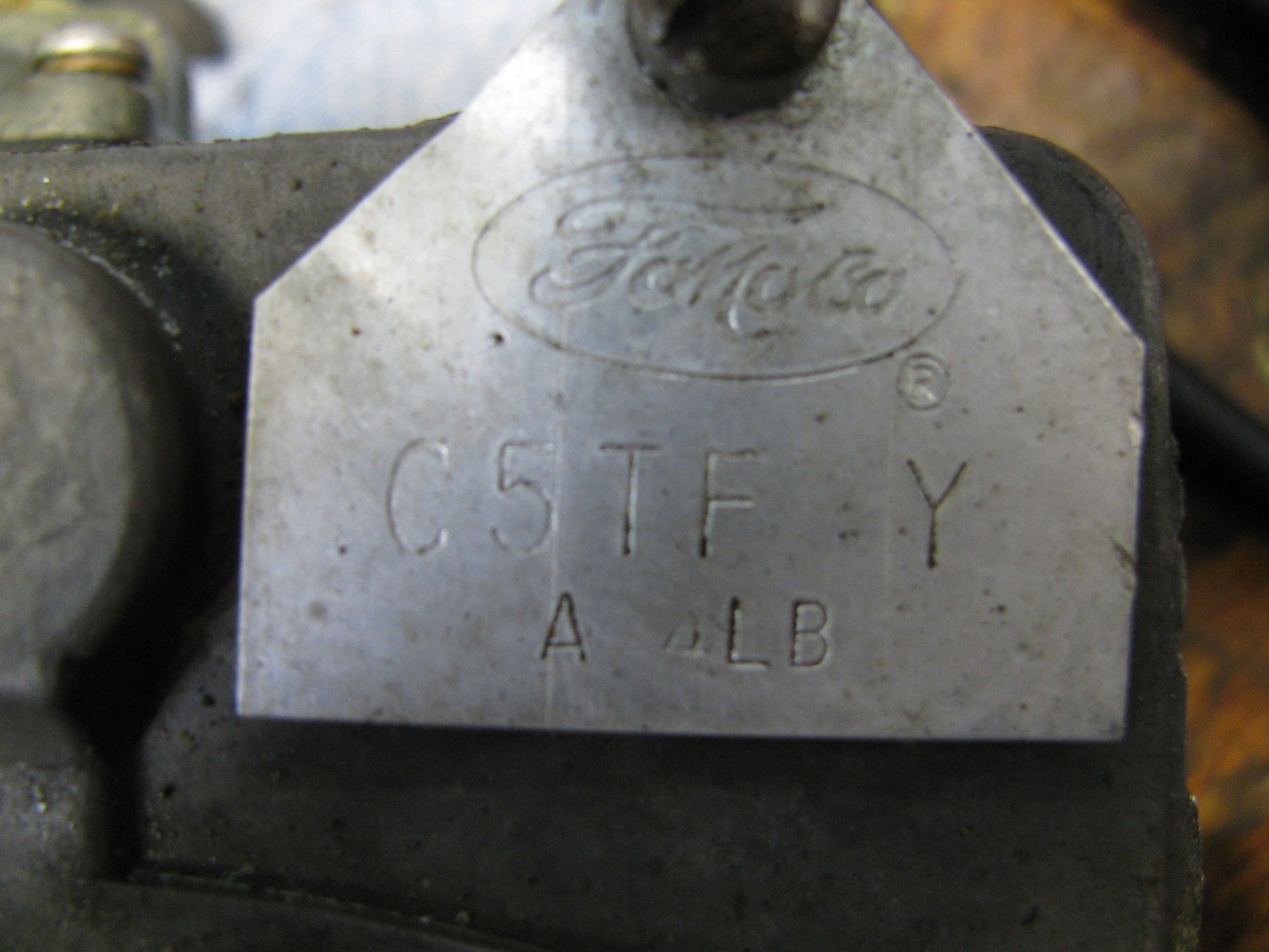

If hooked to manifold vacuum, it will give full advance at idle. That is a GM thing. If you decide to go that route the DIST needs to be re-calibrated..
Not true! This is an original 65 carb it is essentially the same as a 66 and is what his truck would have come with. As you can see the vacuum port is below the throttle blades. (Full manifold Vacuum). There are no other vacuum ports on these carburetors. The only reason to connect a distributor vacuum can to ported vacuum is if you have to pass a tailpipe sniffer test.
