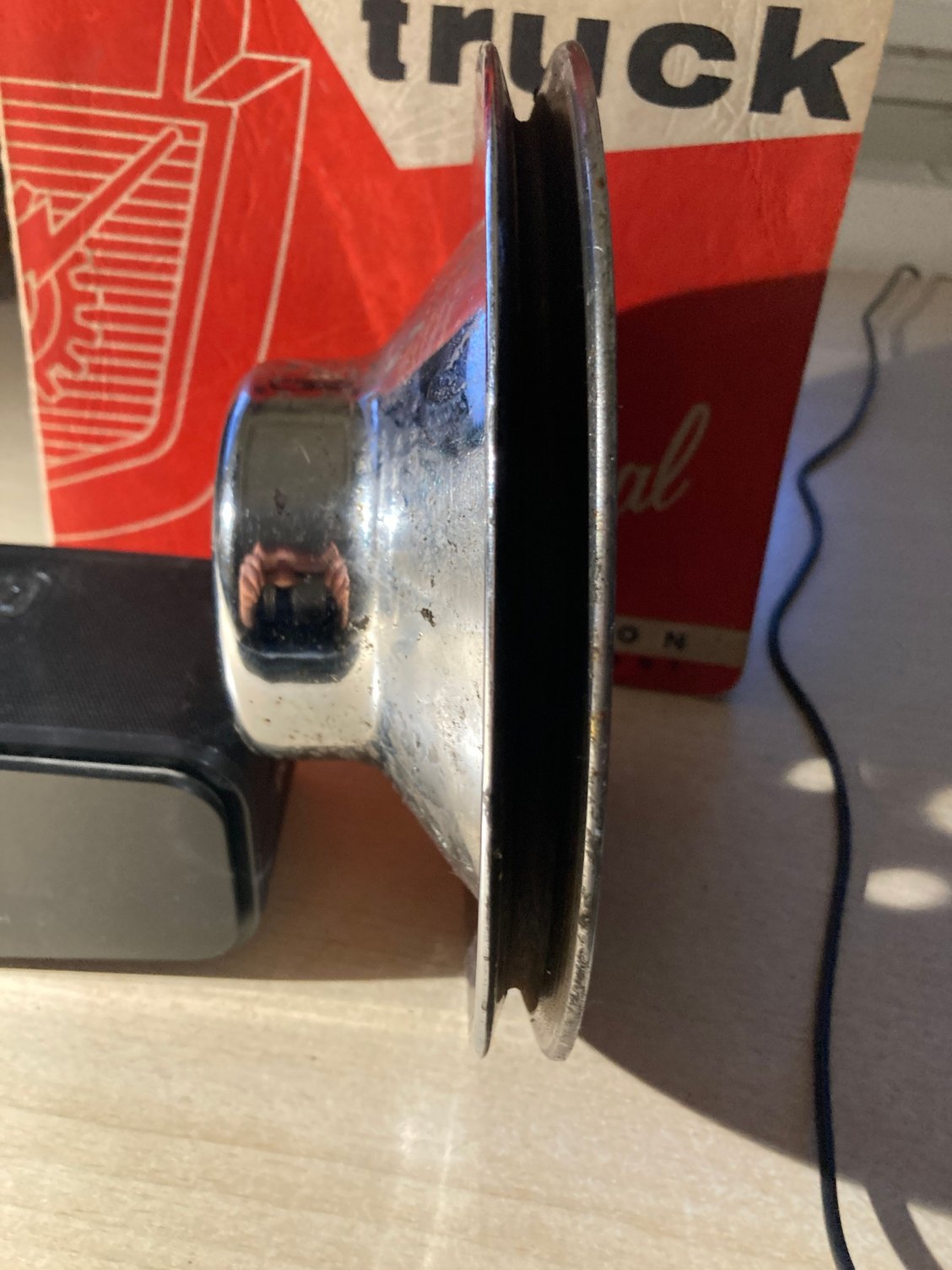

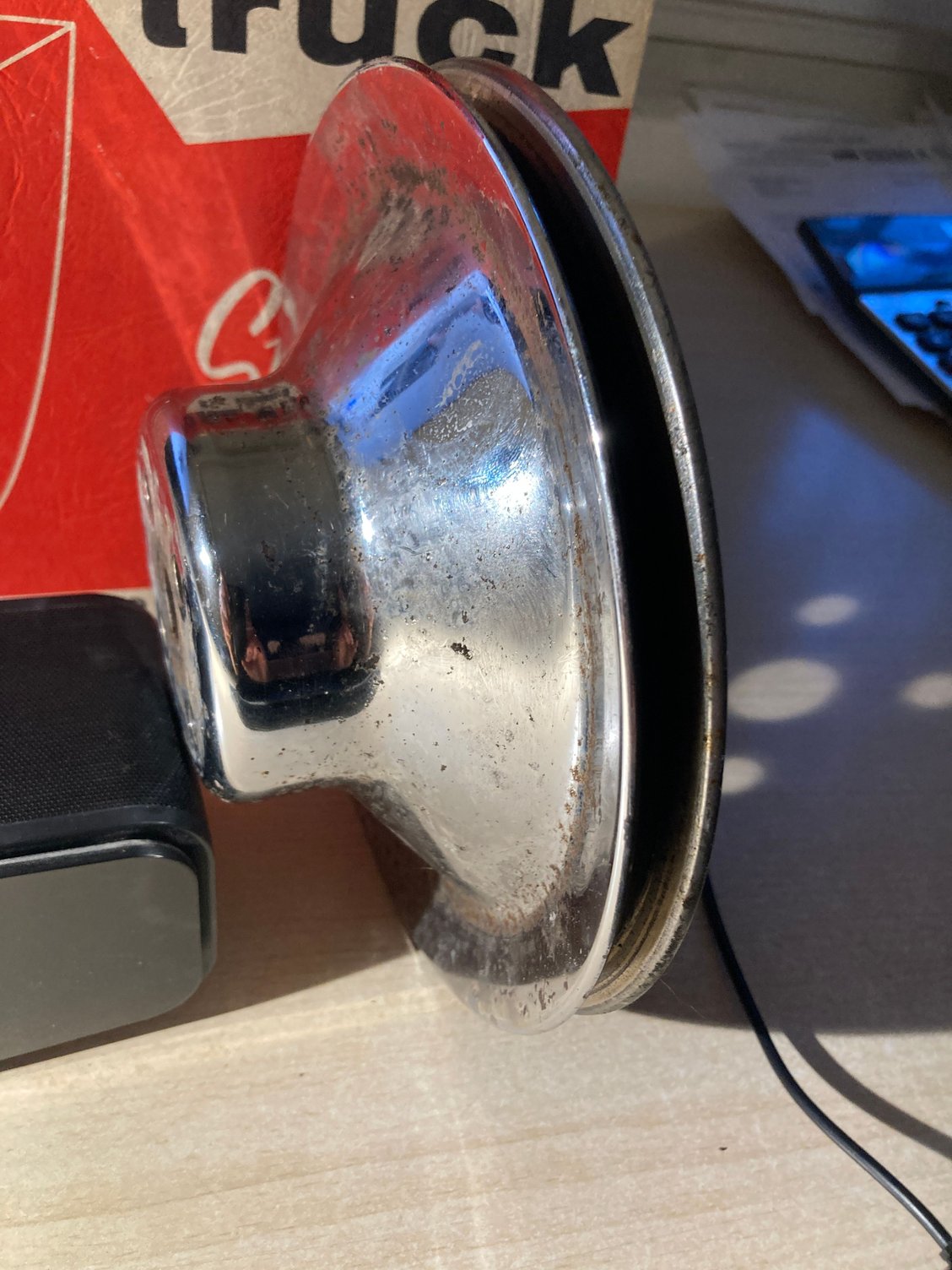

Hi I cant find anyone who supplies a new water pump pully for my F100 292 Y block . Anyone who can help please. I have pictures below. Its 7 1/2 inches wide and 2 3/8 (may be 2 1/4) deeo single V see the pictures attached

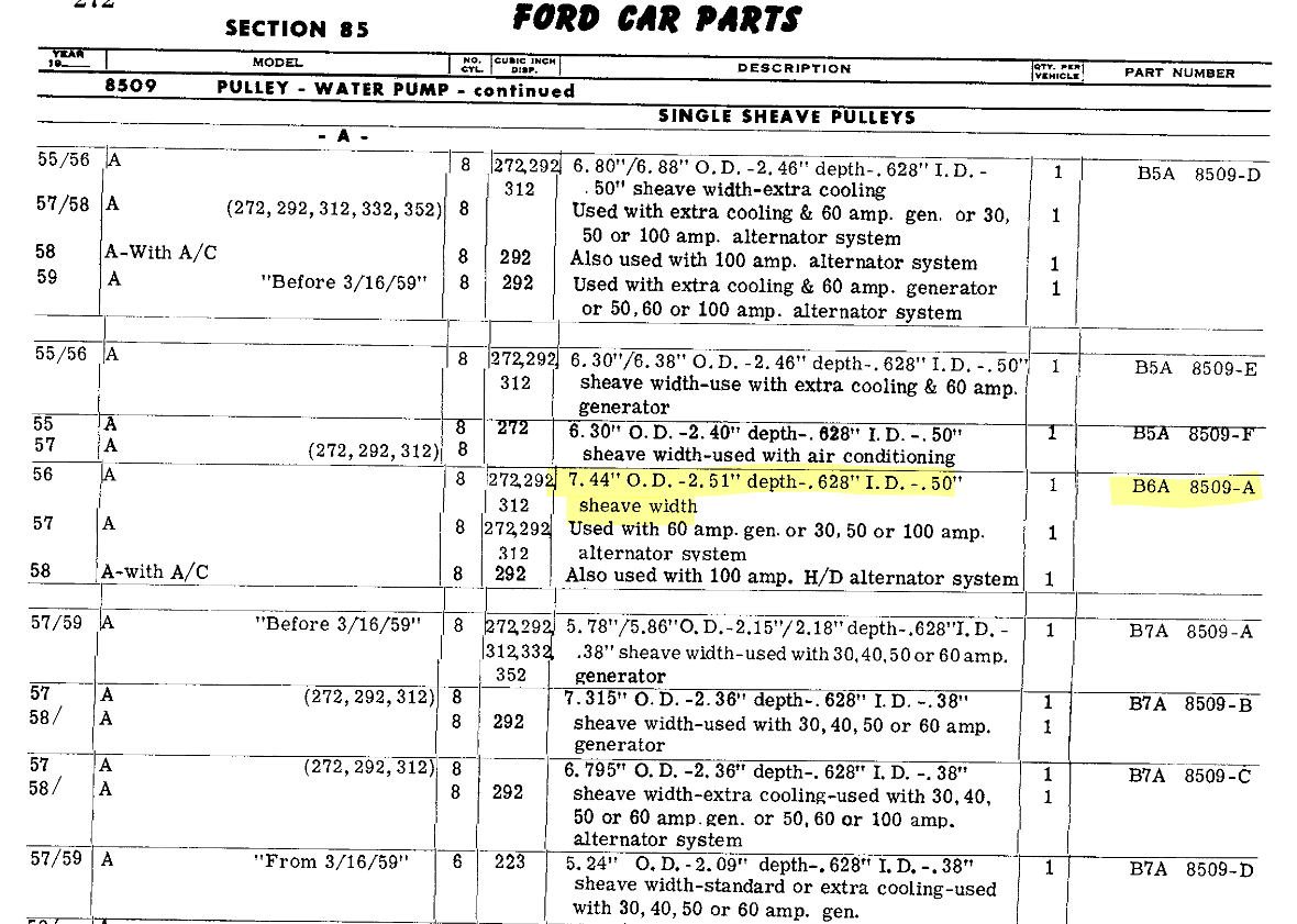

The closest factory offering from the 272, would have used a pulley that doesn't measure up to your measurements:
B6C-8509-A - Single Sheave Water Pump Pulley that has a 6.51" outer diameter, 6.28" inner diameter, .2.67" depth, and .50" sheave width.
Looking at your measurements, I found no exact match in my quick search, but the passenger B6A-8509-A comes closest at 7.44" outer diameter, 2.51" deep, .50" sheave width.
There are numerous aftermarket offerings that follow the typical 4 on 1.75 bolt pattern. Check your shaft width with 3/4" for trucks vs 5/8" passenger offerings.
after looking at OP pictures again that appears to be a car pulley. Looks like 5/8" shaft hole in the center

Thanks. I cant say where the engine came from as the truck originally has a si according to the VIN plate. It's definitely 7.5 inches wide and no more than 2 1/4 deep with a 1/2 inch width at the top of the V. Any suggestions as to where I can get a match would be appreciated Thanks

As stated before, it seems you have an aftermarket pulley. Ford used the 1 3/4" pulley bolt pattern on many engine families. You can scour after market vendors and suppliers to find something that meets your needs: Jegs, Speedway, Spectre, Racing Power, Mr. Gasket just to name a few...
You may also consider going back to a more stock setup, or adapting other pulley geometries to get a functional result.

the chrome is quote corroded and was probably cheaper to buy new vs rechroming

... but the passenger B6A-8509-A comes closest at 7.44" outer diameter, 2.51" deep, .50" sheave width.
If you GOOGLE PN B6A 8509-A you will come across a NOS on EvilBay.
You can call the seller and ask for dimensions.

Bead blast and paint.
You could bead blast the chrome and paint it. It will look like the factory made pulley your going to buy.

That's what I will do as the replacement is elusive!
