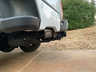

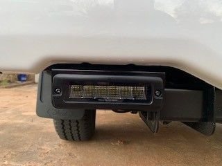

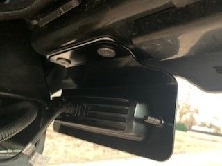

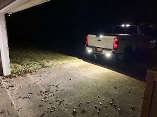

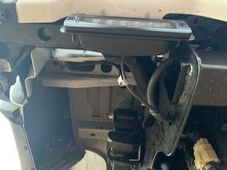

I finished installing some Hella Mini Lightbar (Flood) lights (P/N 358176221,
Amazon Link Amazon Link
) on the rear of the truck and wired to upfitter switch #1. I designed a mounting bracket to mount the lights using existing bumper bolts. If you're interested in having a pair of these brackets shipped to your door, at cost, send me a message. The price for the pair of brackets, shipped directly from the fab house to your door, is currently $45.80. If you want them deburred and powder coated (I did not), looks like they charge an additional 34.14 for the pair.
If there's enough interest in an install supplies kit (excluding lights), I'd be willing to look into putting together a kit (brackets, 10 ga SXL wire, wire loom, step down butt terminals, ground lug, fir tree bundling clips, and adhesive-lined heat shrink) and shipping to you.
- Nathan
