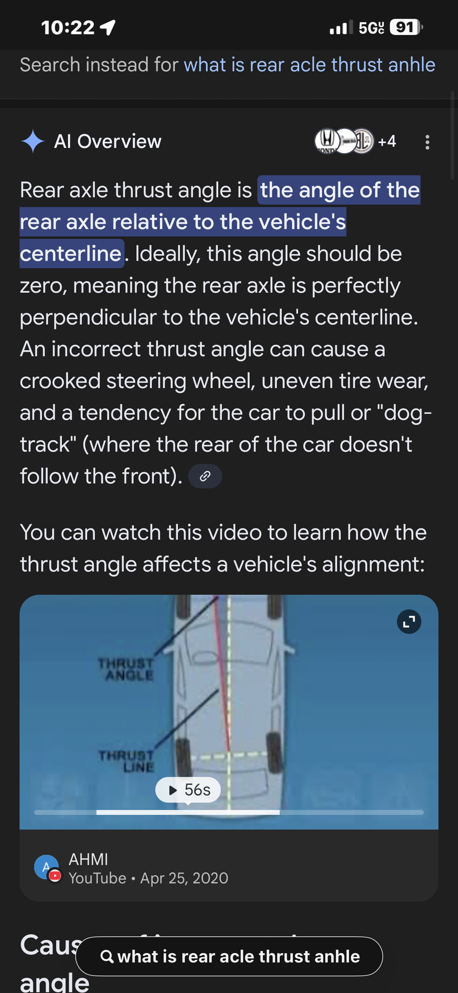

Interesting you mentioned the measurement of 3/16" being off and a pull to the right or left. I actually developed a pull to the driver side a month ago but was thinking the front end alignment was off since I live in Colorado and live out and travel on some rough roads. The passenger side tire is sitting within about an 1" of the mudflap now. The other side is about 3-4" from the mudflap. I guess this goes back to the importance of performing a walk around of the vehicle often and looking for any issues which I have been neglecting to do for a while now. Looking back, I feel pretty confident it must have broke when we were coming home from Idaho driving I25 through Colorado pulling the RV. There was one section of the freeway that damn near wrecked us with all the whoopsies.

Yes
its called rear axle thrust angle
most ignored alignment factor
and you should do both leafs because a new leaf on one side and a worn leaf on the other will make keeping a good thrust angle difficult.
