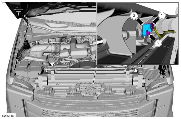

I bought a crashed 2022 F250 Lariat Tremor that was wrecked in the front. It was disassembled by the body shop and the parts were discarded.
that being said does anybody have a picture of the exact location of where the front crash sendor should installed. I know it’s on the core support near the hood latch. Seems critical to put back where it belongs. Thanks guys

Thanks. Found the spot on the inside of the upper tie bar. Its really hidden.
