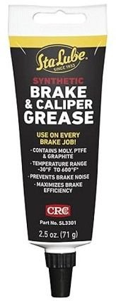

Original rotors on my truck have 273,000 miles on them...so far!
Also, one of the MUST DO items on a brake job for these trucks is to SERVICE THE CALIPER SLIDE PINS, grease the heck out of them before reassembly.

Got it covered
