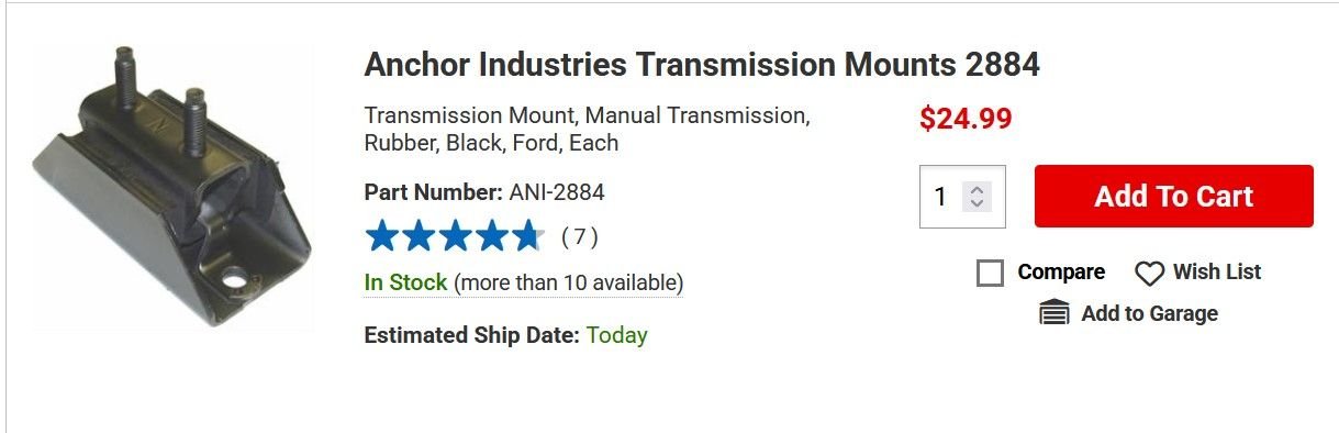

I'm needing to replace the engine & transmission mounts on my winter rig, 96 F150 5.8 E4OD 4x4. I'm finding 2 different part numbers with little to no descriptions on the difference. Mainly 2884 or 2969, through various brands. I thought maybe 4x2 vs. 4x4, but info I find is conflicting. Anyone know the difference or what I need? Thanks.

What is conflicting? RockAuto shows the same part number for both auto and manual transmissions. To me, that means they use the same mount.

What I'm finding is different part #'s even for the same brand. RA list different #'s too.

2884 is on my manual trans 4x4

From what I am learning/seeing, both will work but technically the 2969 is for auto/manual 4x4 and 2884 is for auto/manual 2x4. The top plates that the studs set into are visually a different design, maybe a bit more stout for the t-case weight?
