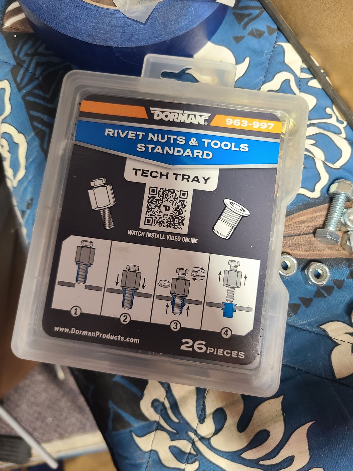

My mounting holes were messed up used a rivnut to fix them. Other than welding to repair

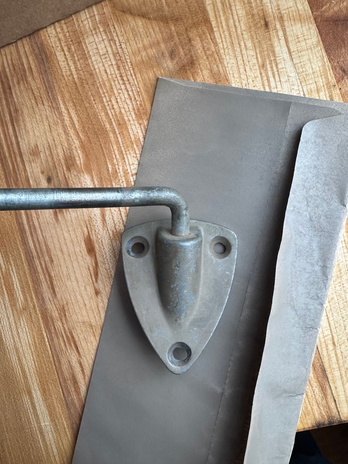

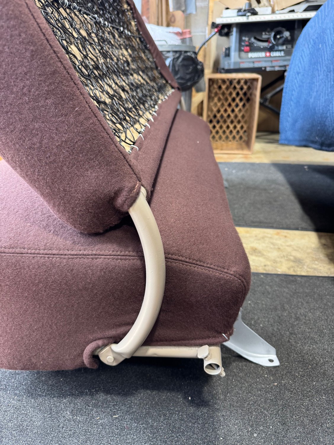

From my research in 52 they were a basic warm medium gray color like both the hood springs and the bench seat tubing in 51/52. The interiors then switched from a brown palette to a gray one in 51/52. Argent silver is a metallic color. This gray was was not metallic . They were not to the best of my knowledge in an argent silver, although this would make sense and would not be a terrible choice.
In 48-50 they were of that brownish grayish taupe color the OP has in the picture. I have matched that taupe color in a paint, taken from NOS examples. And even that taupe color varies from one example to the next.

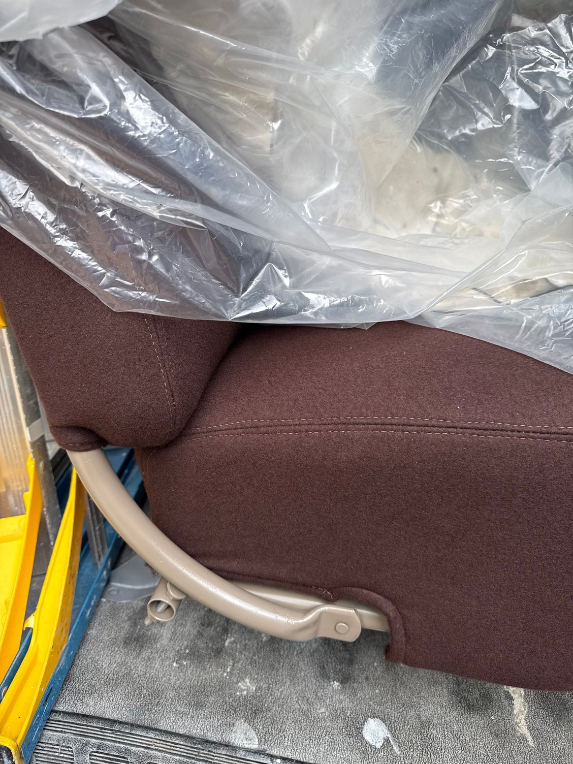

I used the taupe color on the seats tubing
Tube color is the same as paint sample below just different lighting

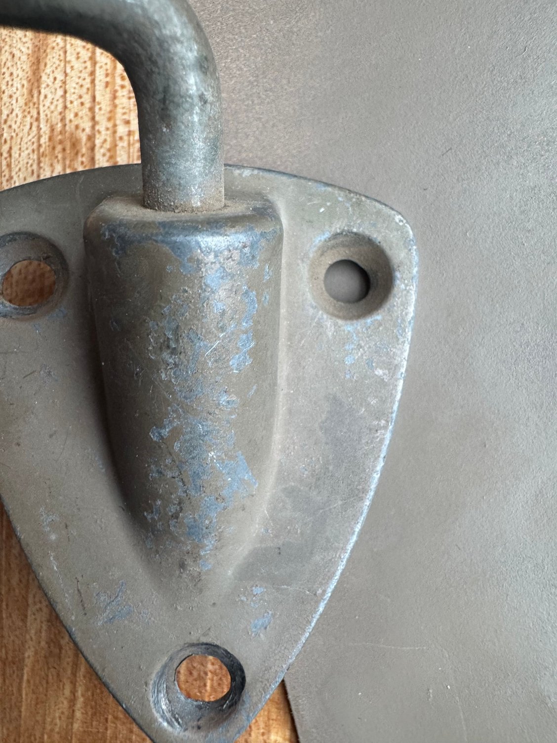

Based off of this NOS visor bracket
Which was 48-50. 52 was gray. But I have the brown cardboard interior.

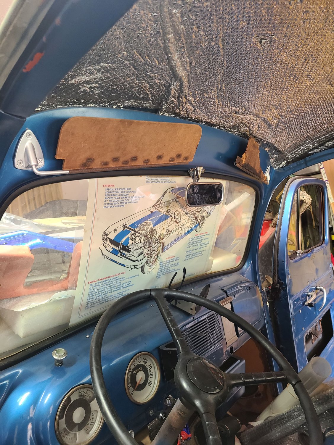

Well I installed both visors
yes will have to replace the visor part sometime.

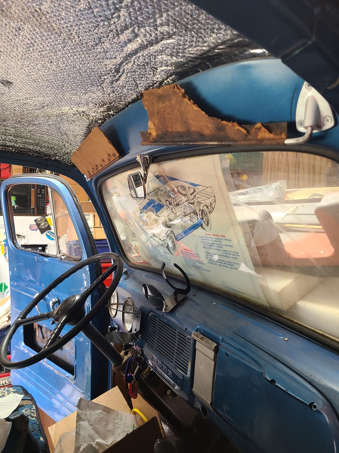

Have installed visors.
On to the next project.
