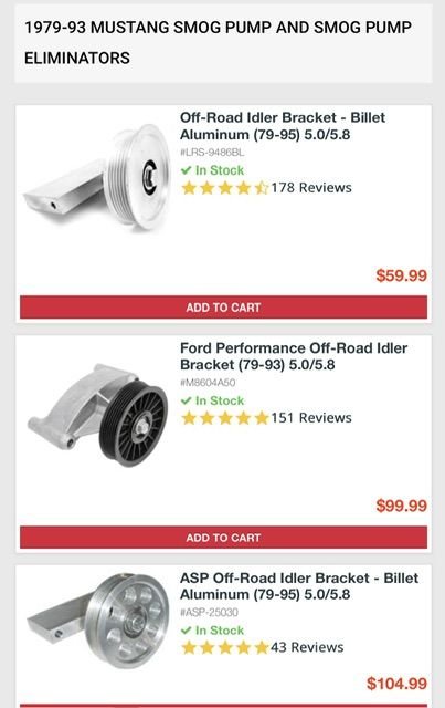

You do not want to use the ‘92 alternator since, from what I see on RockAuto, is a 2G and you currently have a 3G which is a much better alternator. Since you said that the tensioner is also in a different location on the ‘92 then I believe you would also need to change the driver’s side bracket. Why not keep what you have and use an idler pulley in the air pump location?

Yes. You already stated that a PO deleted the air pump. Why do you think the tensioner should be relocated if the air pump is removed? There are several people using the newer serpentine belt system that you have without the pump. As I mentioned you could add an idler pulley and use a regular belt and routing. That is what I have on my truck.

I now see what you are talking about. I am going to order that pulley that takes the place of the smog pump. I never thought to see if there was such a thing. Thanks alot.
