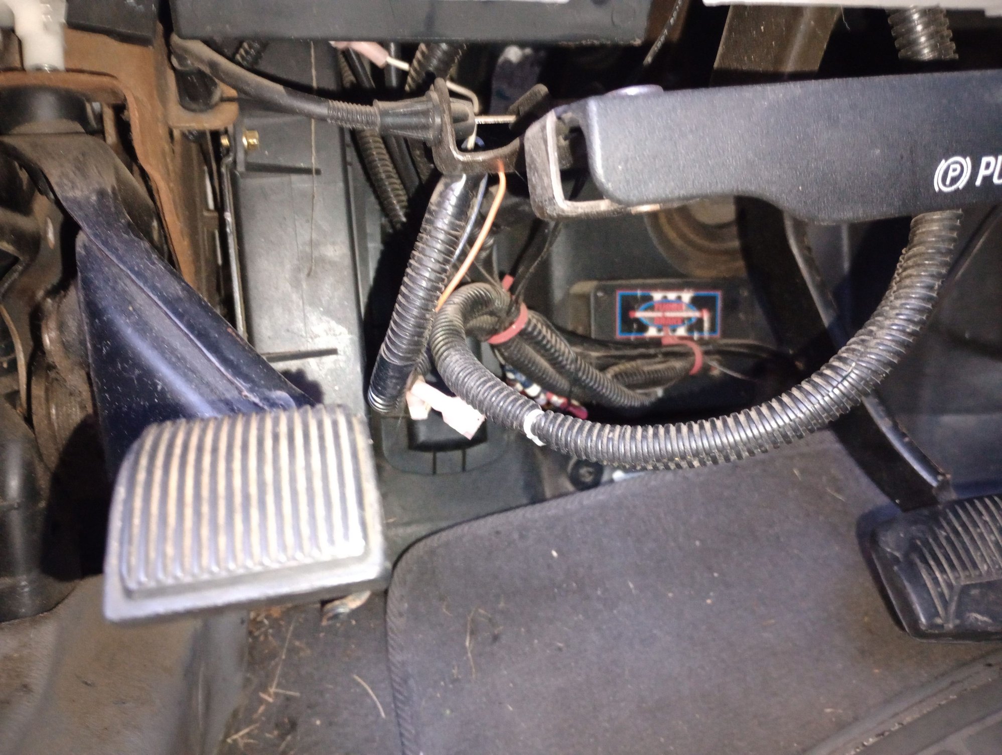

Question Automatic Transmission Brake
New to "Ford Truck Enthusiasts", great site, I've learned quite a bit from.
I have just acquired a 2000 F250, 7.3L, 4x4. Getting to know my way around it, however I've run into something I know nothing about really. I've attached a photo of it, maybe someone here knows something of this branding of an Automatic Transmission TURBO BRAKE, logo appears to have an arrow style design of it.
I'm guessing this wasn't factory installed.
Thanks, Kurt

I think this will give you an idea of what its for. How to use it I couldent say. https://us.bddiesel.com/products/7-3...30073631768640.

Thank you for the link over to that B&D Brake, it seems by looking through their manual, I should be able to confirm it's usage/purpose and do a test of the system. That's a good start for me, really appreciate your response.

At first I thought it was a trans brake for drag racing. But the more I look into it, it looks to be a no-longer-produced exhaust brake system.
With a fixed vane turbo like the 7.3 has, I'm not entirely certain how it would work...because usually you need to either have a valve added to the exhaust after the turbo, or a variable-vane turbo, to increase the back pressure.

The 7.3L does have a valve after the turbo. It closes when the engine is cold to help with warm up times. This unit probably controls that valve, and may also apply the coast clutch in some gears to provide engine/transmission braking.
