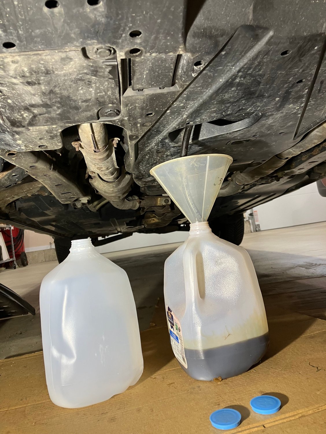

Here's my homemade funnel and other details, including a Fumoto drain valve. Works like a charm:
https://www.ford-trucks.com/forums/1...er-change.html
For filling the oil, I recommend one of these kits:
https://www.ford-trucks.com/forums/1...unnel-kit.html

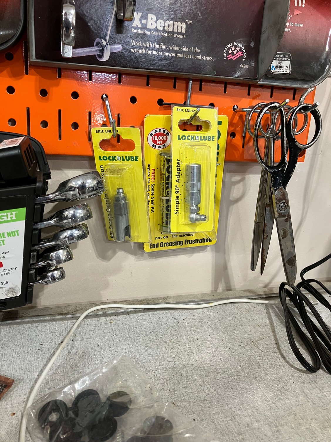

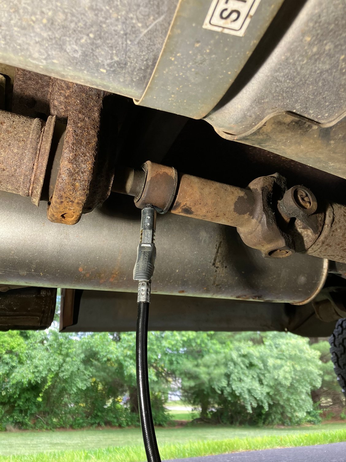

lock n lube makes a tip for your grease gun that locks on the zero. Works great. I’ll post pics tomorrow.

I have one of the cheaper ones and it works pretty good were it will fit
I know it will not for the over drive shift linkage and 1 other place but cant remember where ATM.
I think L&L makes a 90* one I thought or I can change the grease fitting(s) to 90*

Thanks for reminding me,
I have a selection of LNL attachments.
I know some of us have seen this photo.
