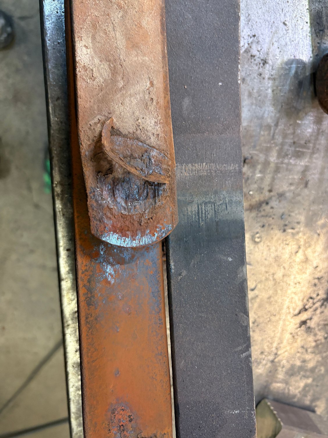

When I disassembled the spring pack on my 62 Uni there were the remnants of a "button" that I assume was to make the spring work better by sliding. The leaf has a stamped recess to retain it. The 61 parts book doesn't have any break down of the spring pack (that I can find)

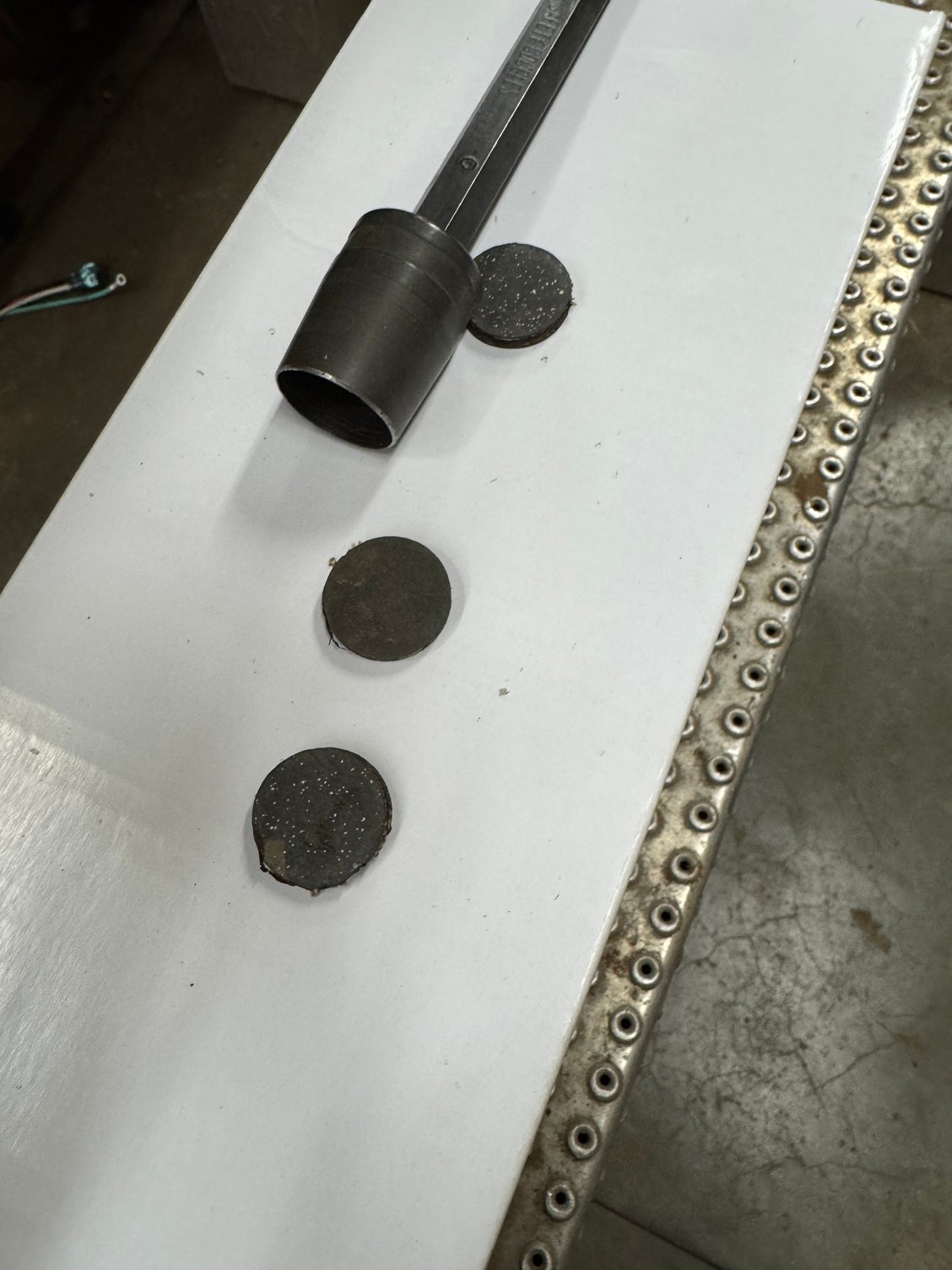

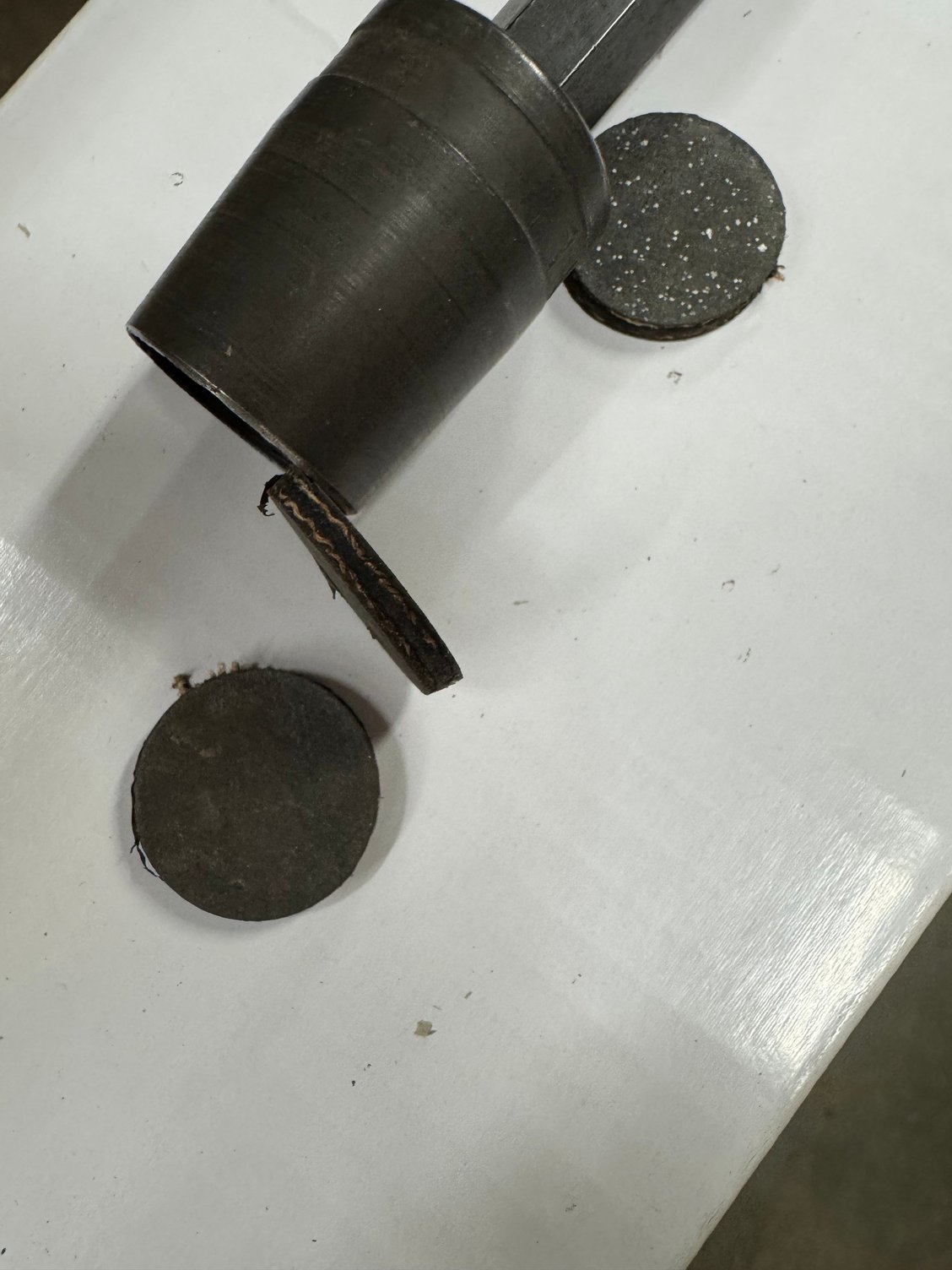

I made my own from some rubber belting I had. Doug.

@Muppy1840 I like your thinking, plus using some adhesive to keep the button in place. Thanks!

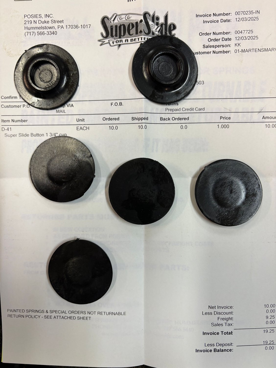

For what it is worth, I was able to purchase four of the correct "buttons" from Speedway Motors, that was all they had. I next called Posi's since it appeared they were the vendor and bought the balance from them. It appears that Posi's replicated the Ford design for the slider buttons??? Maybe other manufactures had similar springs.

Here's a picture of the spring buttons if you are interested.
