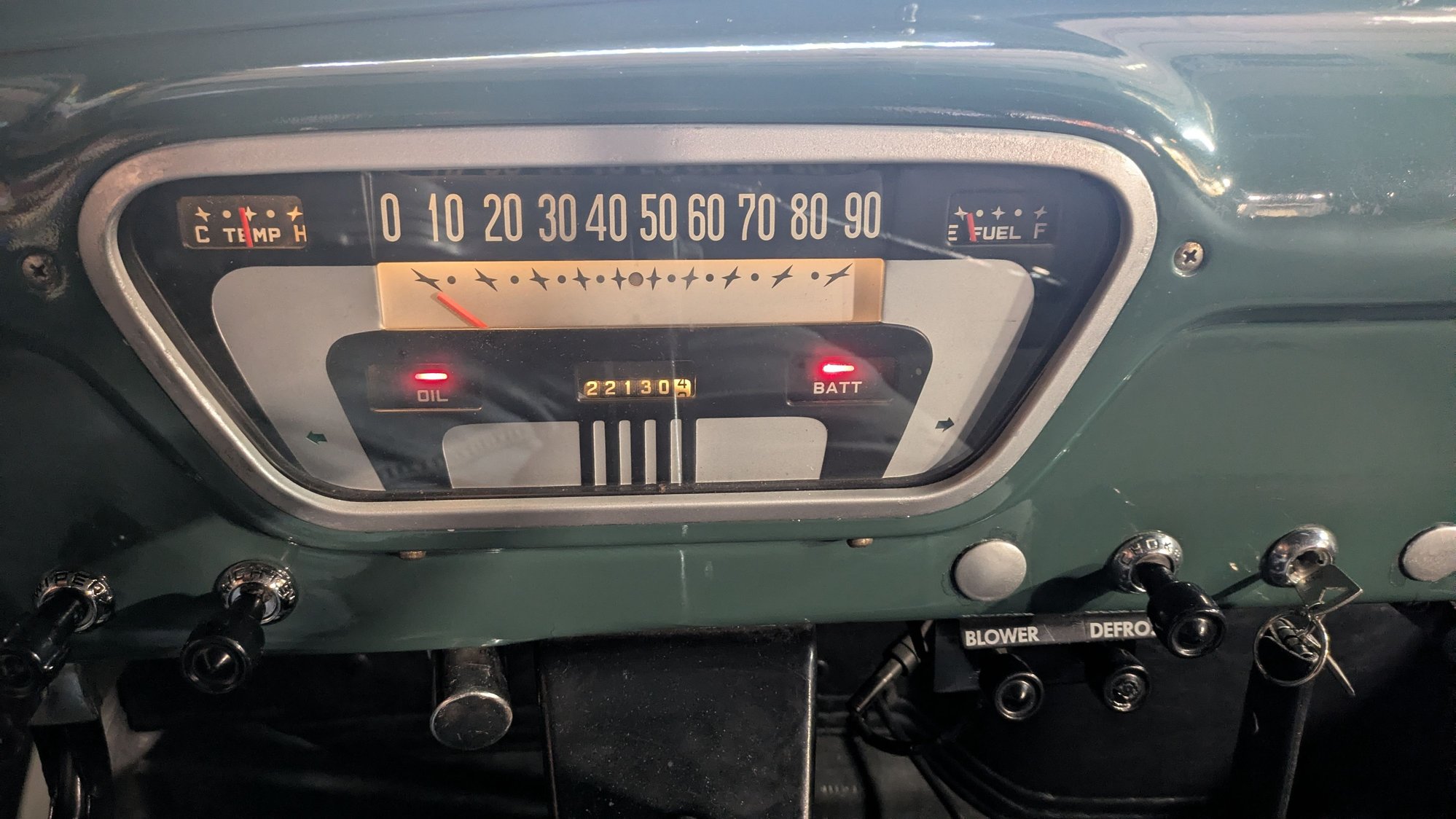

here is the dash of my old 55 F350.
Here's a picture of my 54 dash with the throttle and cigar lighter holes plugged off.

Thanks for the dash comparison pic. My 55 F250 has the blank like the bottom pic. I would really like to have the throttle cable though. My other two early Fords both have it and it's nice to have for warming up
