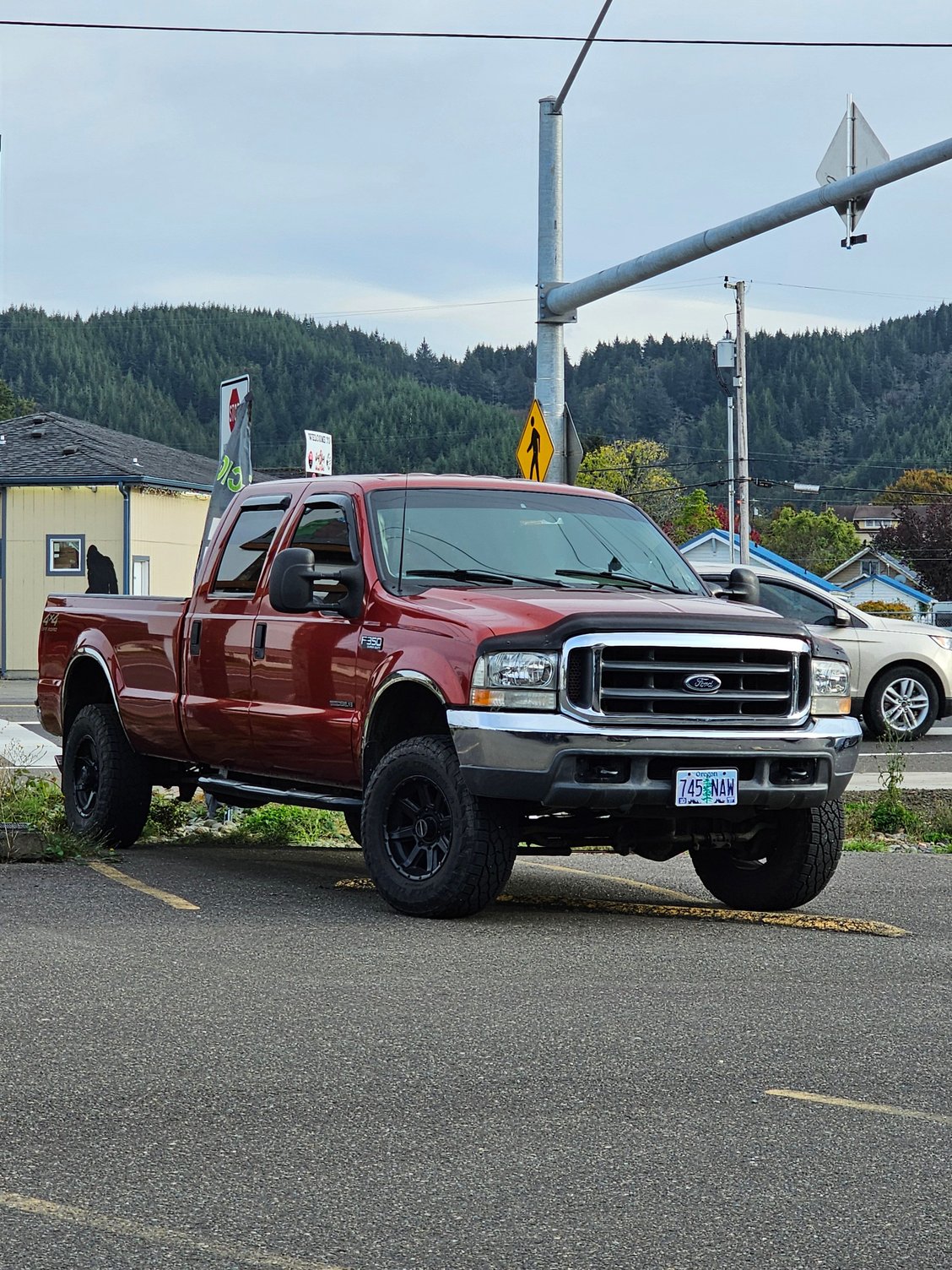

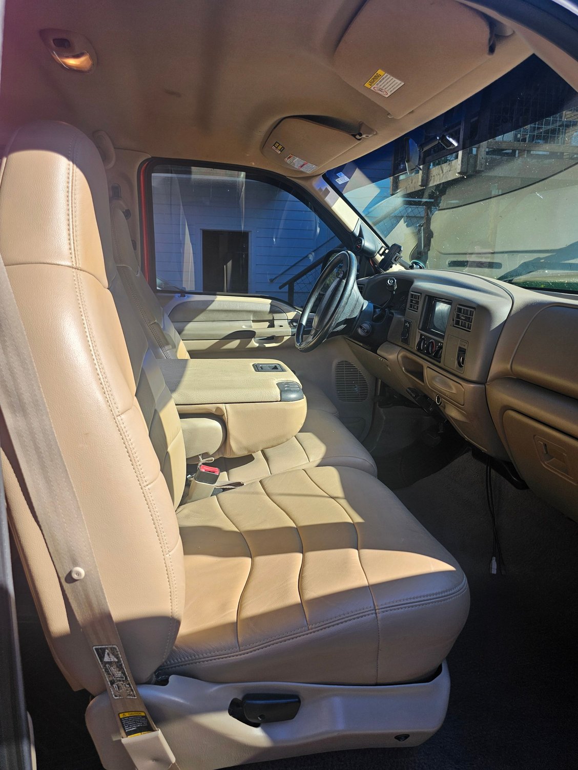

Bought 2000 f350. My dream pickup. Found decent one, had it gone thru, rock solid only 170k miles. My cousin says they're easy to work on. I'm mechanically inclined, intimidated nonetheless.

Congrats!! Good looking truck!

She's a beauty.
