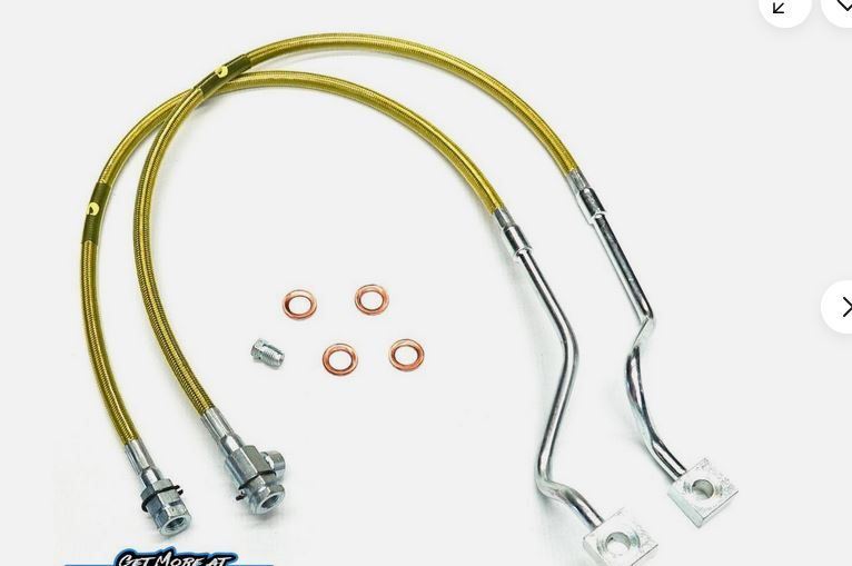

Originally Posted by DavenTn
I highly recommend upgrading the flex lines from rubber to stainless re-enforced lines. Both my rear-rubber OEM lines failed and acted like a check valve. In addition ... the hard/static rear differential cross-over line rusted through at the retaining clamp on top of the pumpkin. .Worth looking at for signs of rust.
I had recently replaced the steel rear axle tubes left and right of the splitter with OE, and all 4 flex hoses were replaced with stainless when I redid the lift, those came from Superlift. Not to say they aren't due again. They look like this.

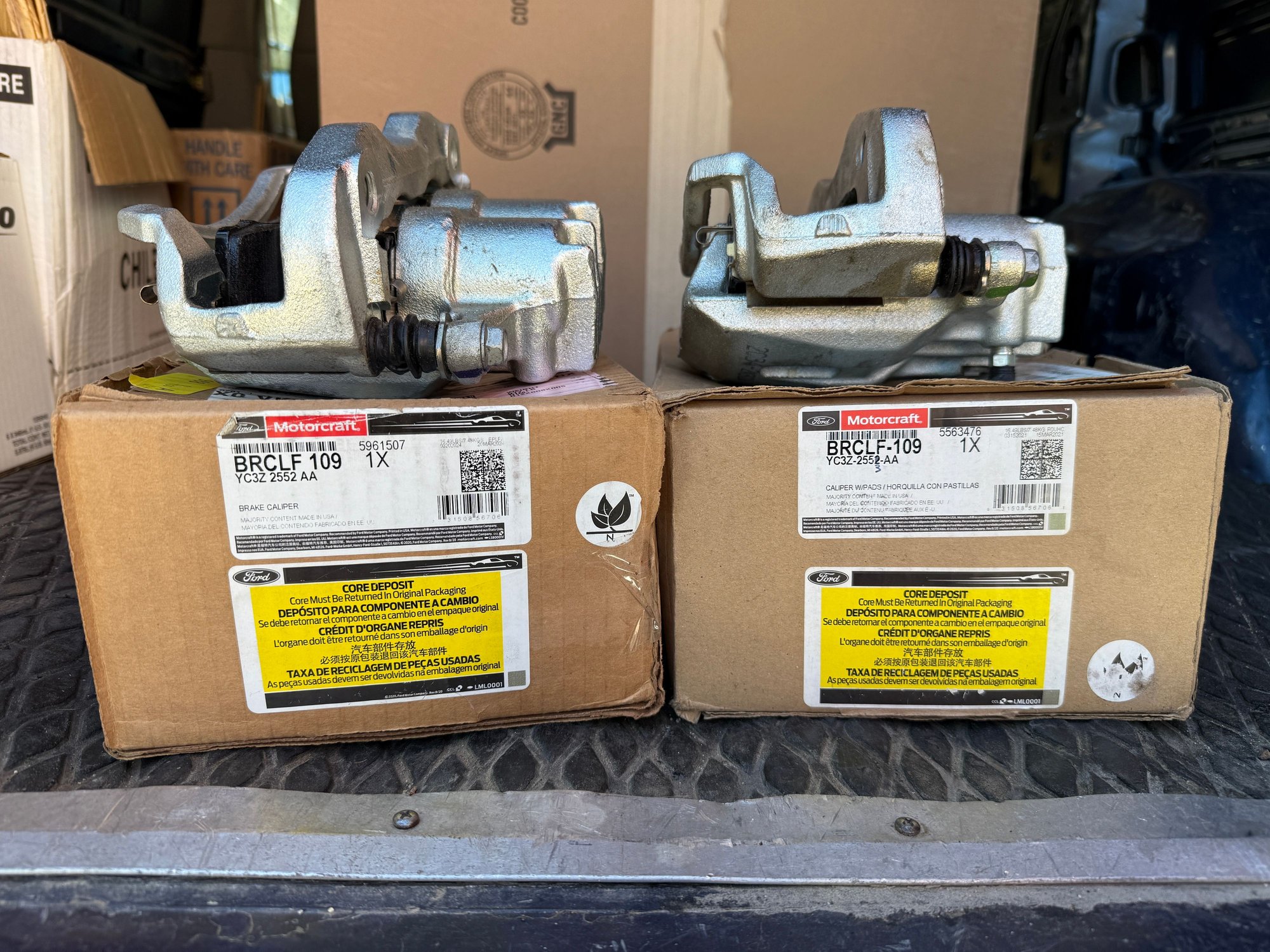

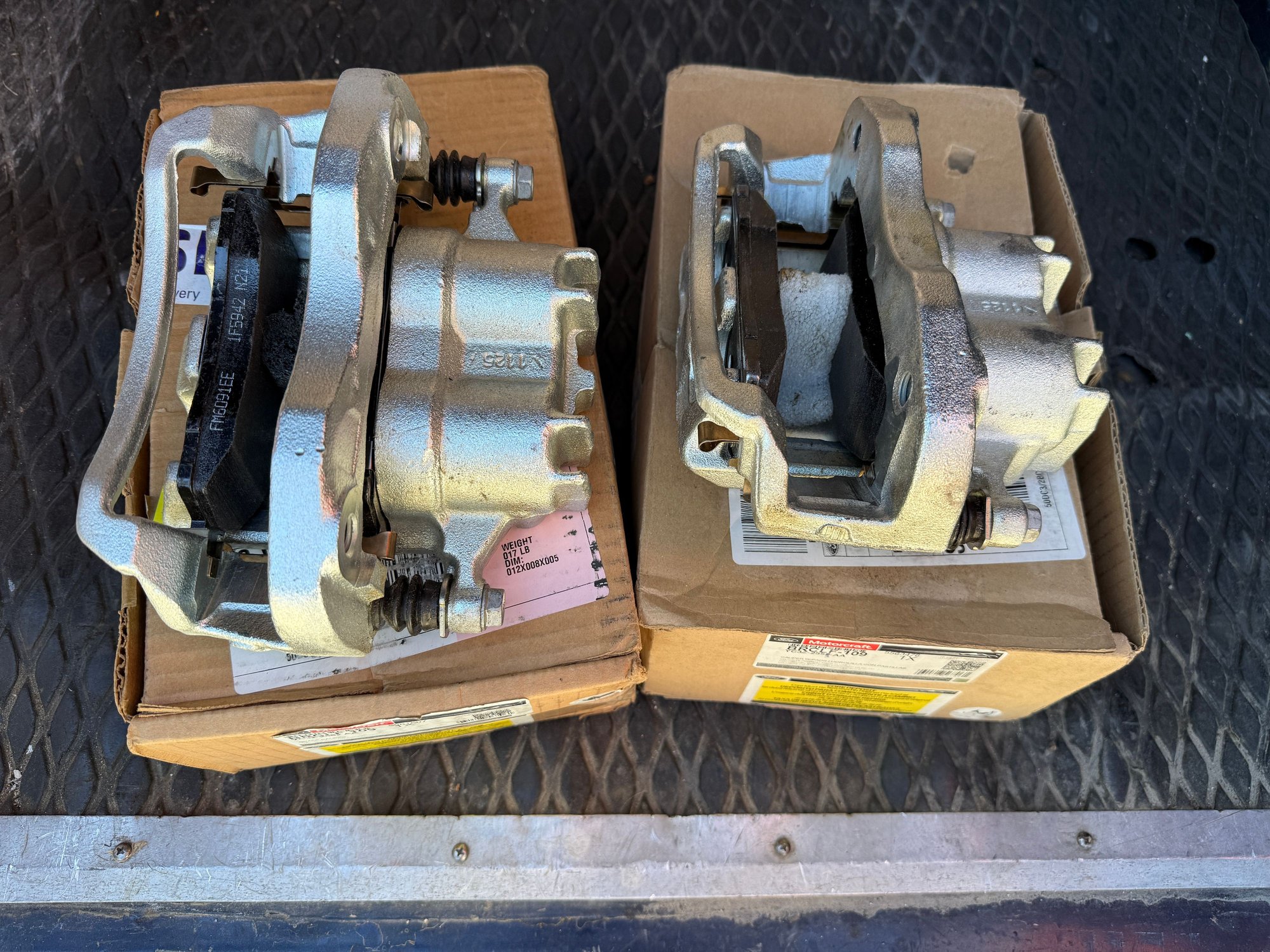

Originally Posted by ncheavymetal
No kidding. Those look almost exactly like the power stop calipers I have. Including the stamped symbols. Only very slight differences.
Those should be great with some decent rotors and pads and a good flush and bleed.
Not sure how much you paid and not asking but the OEM fords are $115 from Lakeland Ford. The PsZ are $142 from Summit.
I'd almost bet they came from the same factory.
And that's a s h i t ton less than the ssbc stuff.
I did a flush of a few quarts 3 years ago when I redid all the brakes, new hydroboost, master cylinder, and power steering pump. I will obviously purge a couple more quarts through this go round.
The dealer out west sold me the new rears as a pair for 90.00 each. My dealer here sold me the ones pictured @ 139.86 for the fronts, and 105.42 for the single rear one, with no shipping. I'm also tax exempt.

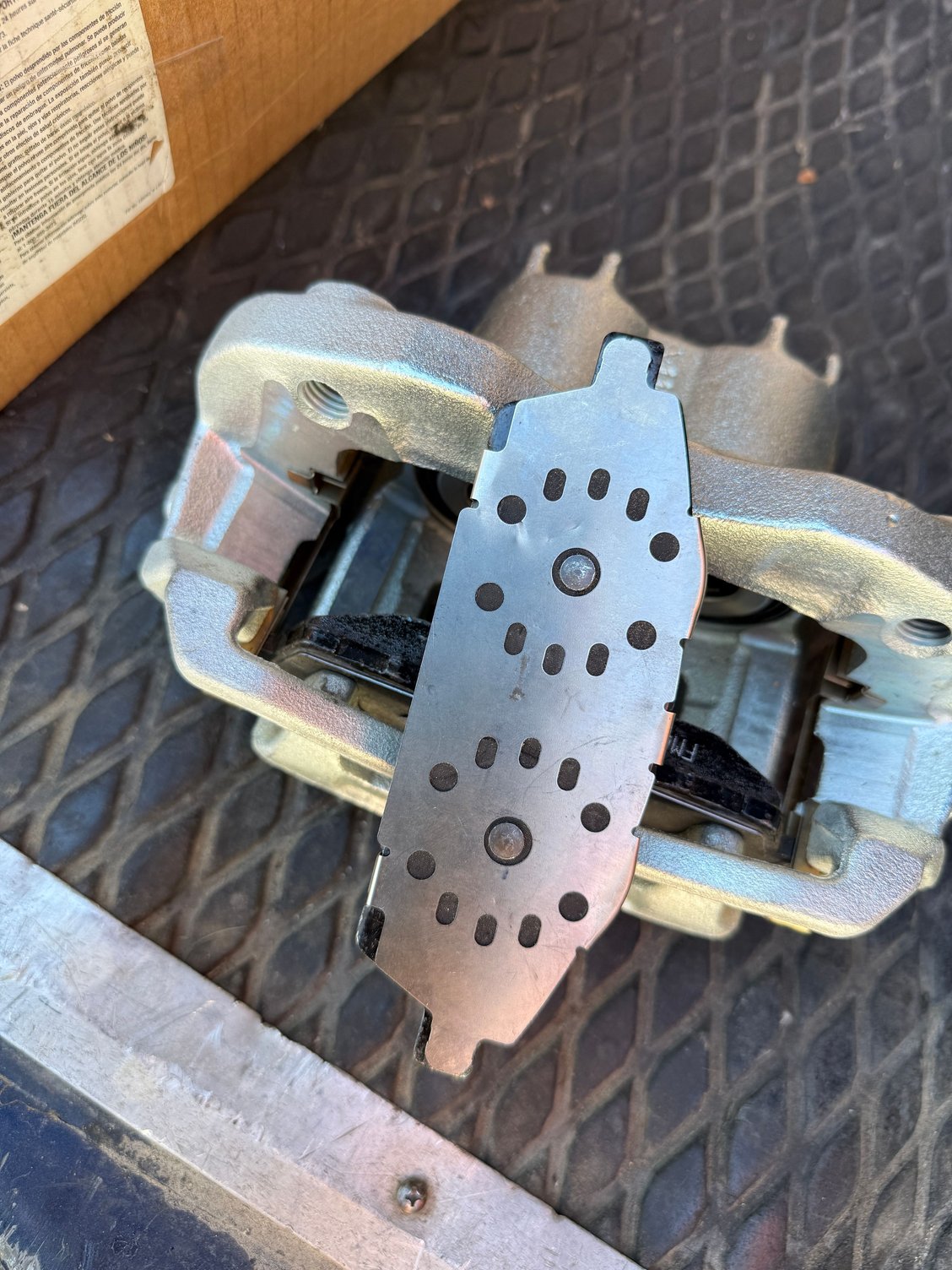

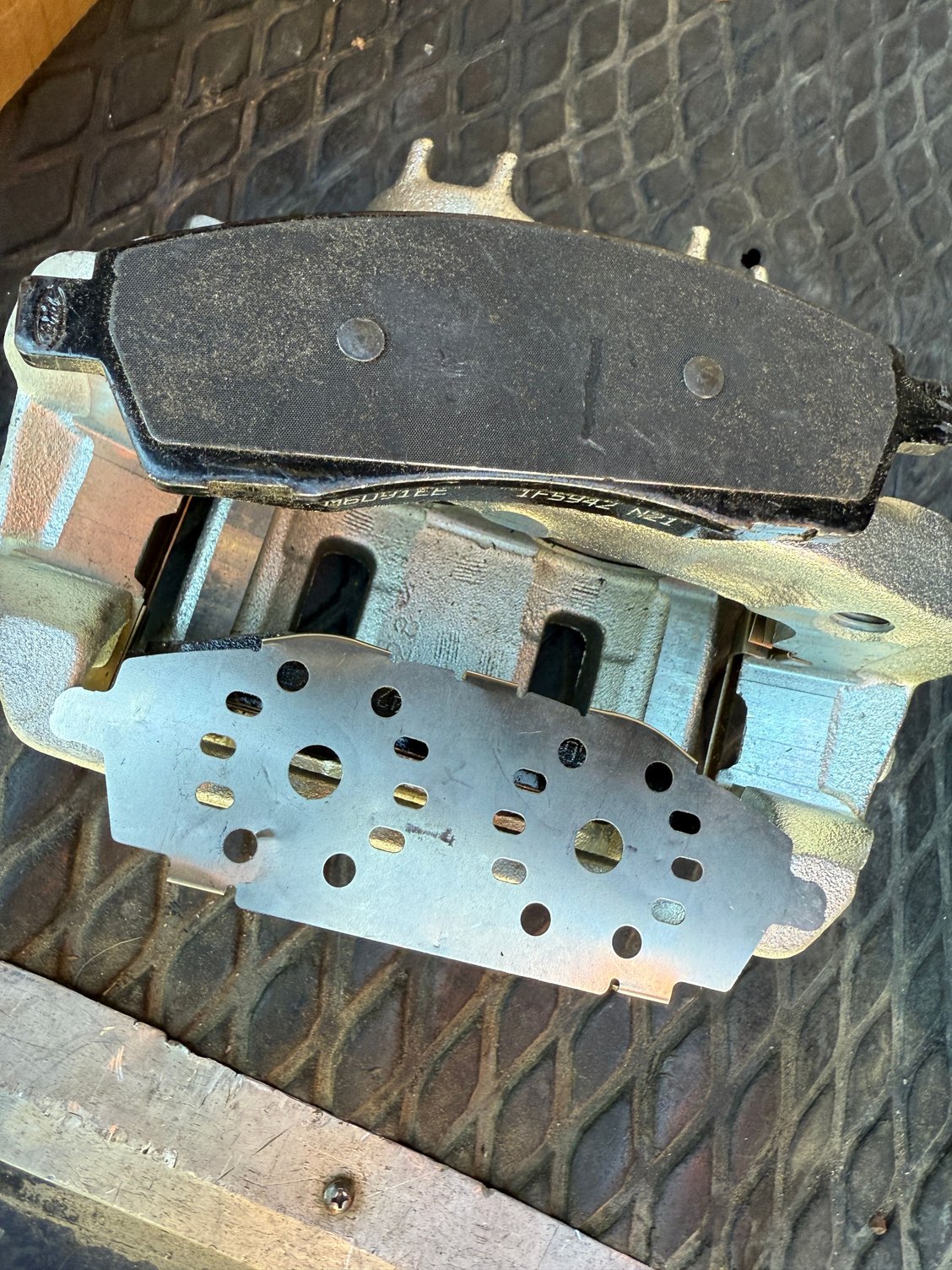

The final new pair of rear calipers are here. I noticed they have a snap on metal plate between the pistons and pad, never seen that before.
On to pads and rotors..

I did not know the OEM replacements use metal pistons. Previously they used phenolic.

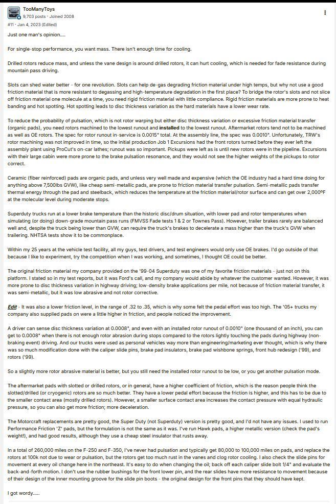

I found a post from @TooManyToys on PowerStroke.org, it is a well informed read. For me anyway.
