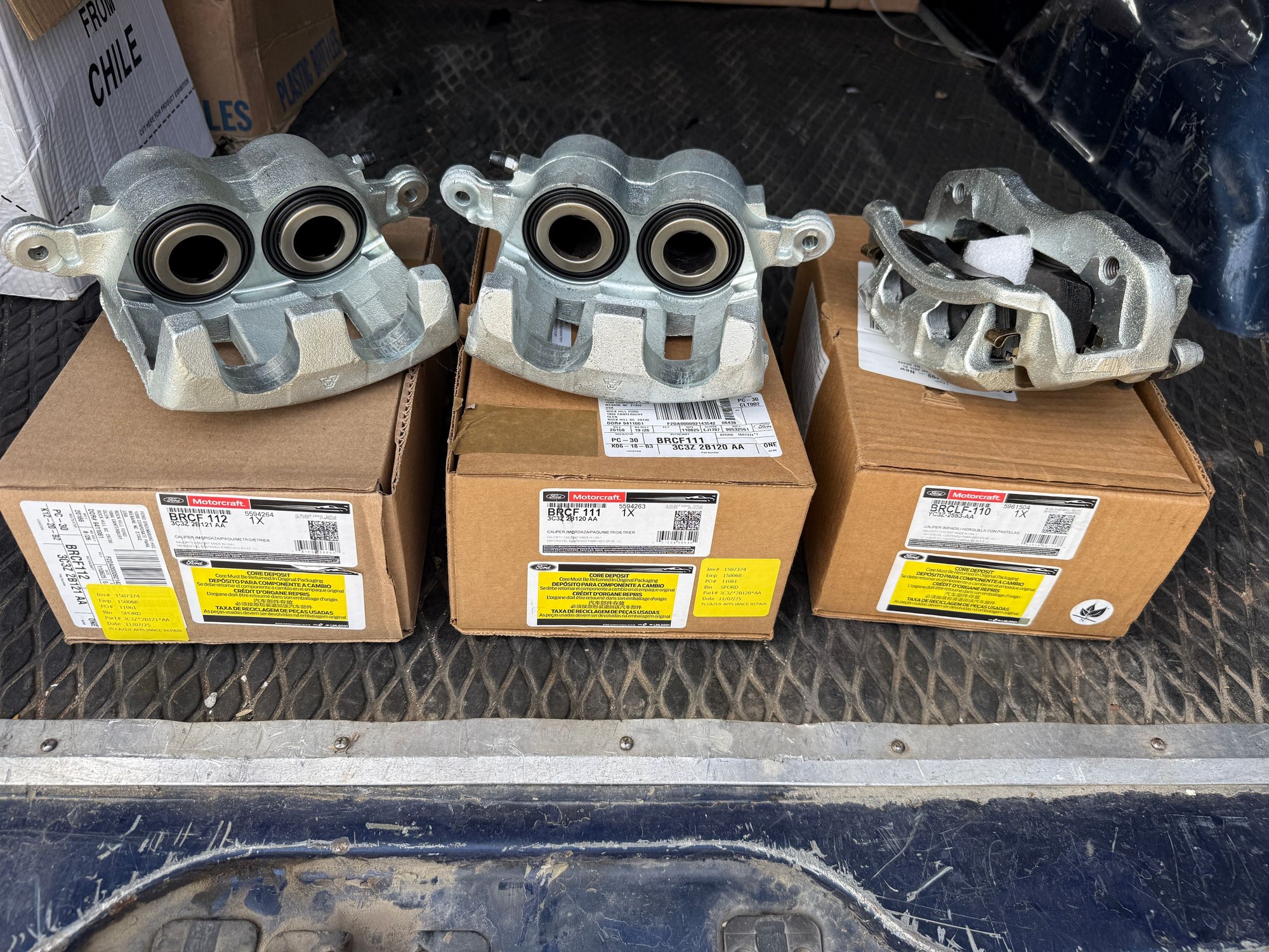

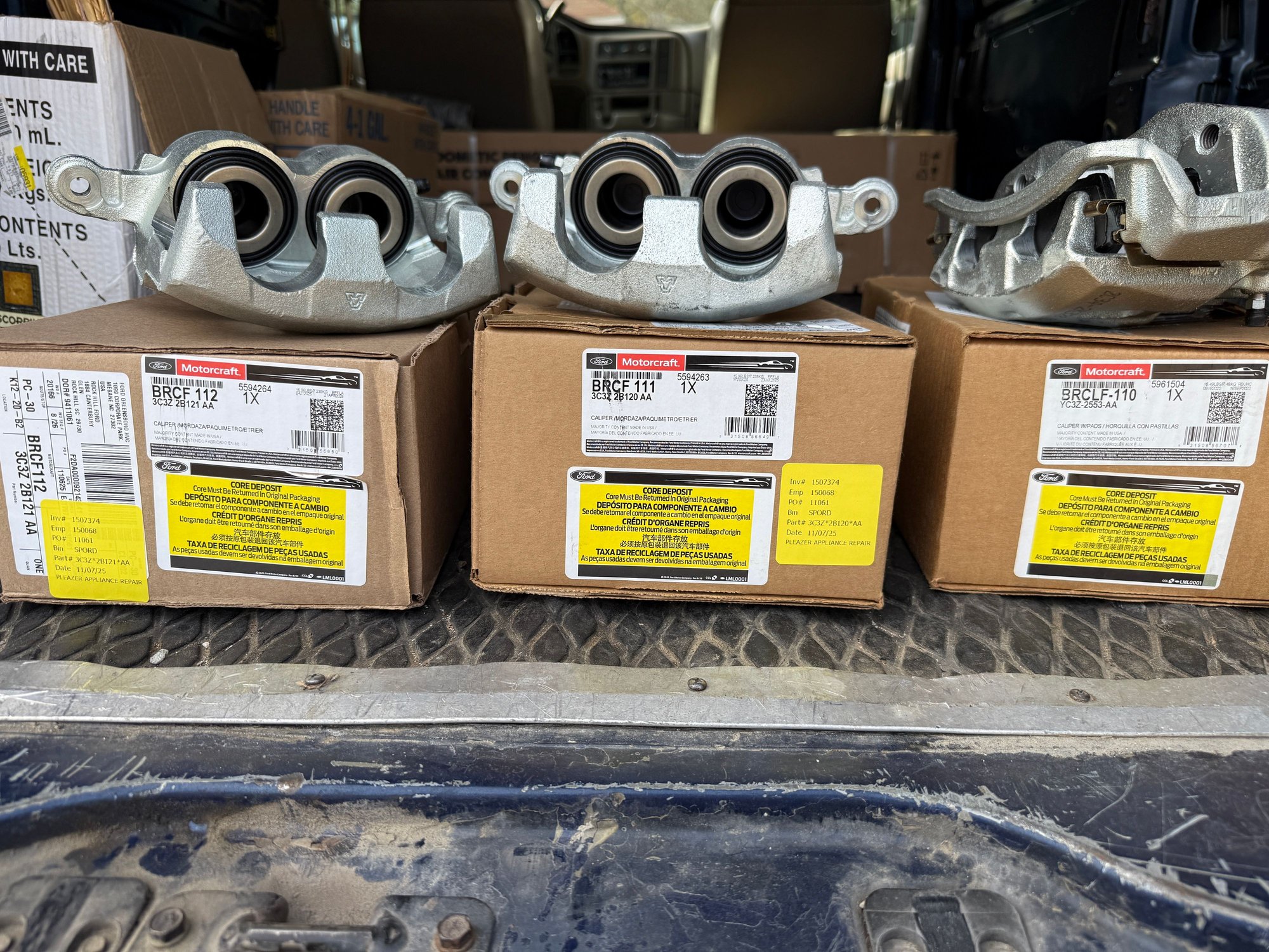

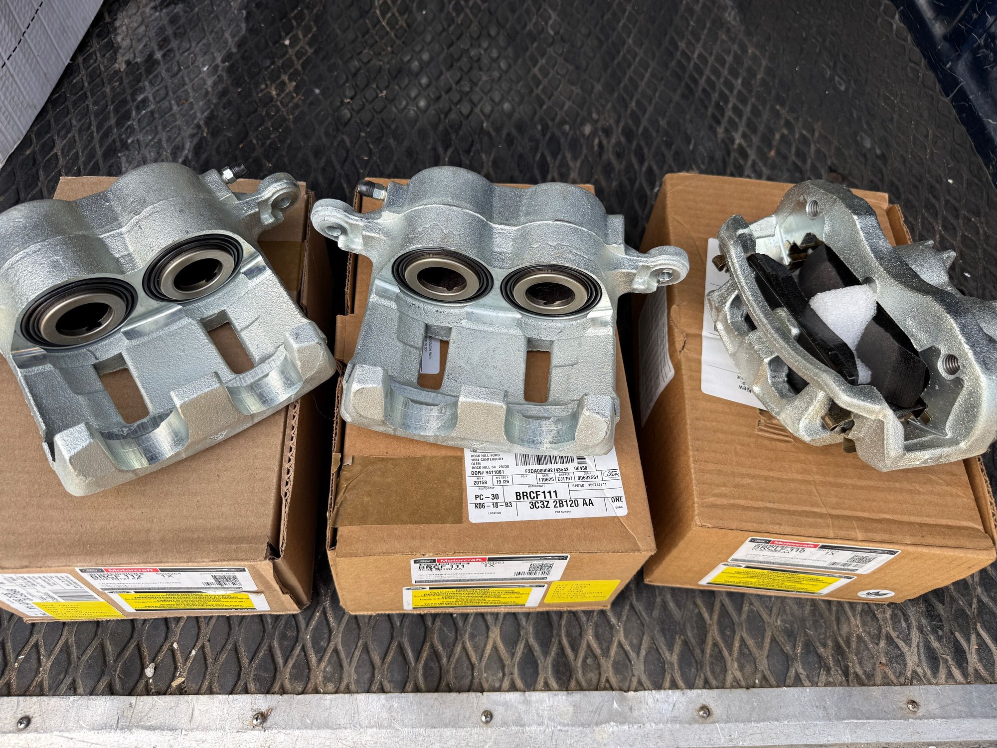

A few parts have arrived.

Are they 'new' or rebuilt?
These are New, not rebuilt. The left 2 are for the front, and are still avail from Ford. The right one is the L/R caliper that I smoked, and is new, but discontinued from Ford. I have 2 more New rear loaded calipers coming soon, (left and right) from a dealer out west that preferred to sell only the pair at a give away price. Despite the core notice on the box, Ford requires a core for New or Rebuilt calipers, the reman calipers will have a "RM" at the end of the part number. When all is said and done, I will have 3 Ford cores, and 2 Chevy cores to go back.

No kidding. Those look almost exactly like the power stop calipers I have. Including the stamped symbols. Only very slight differences.
Those should be great with some decent rotors and pads and a good flush and bleed.
Not sure how much you paid and not asking but the OEM fords are $115 from Lakeland Ford. The PsZ are $142 from Summit.
I'd almost bet they came from the same factory.
And that's a s h i t ton less than the ssbc stuff.
