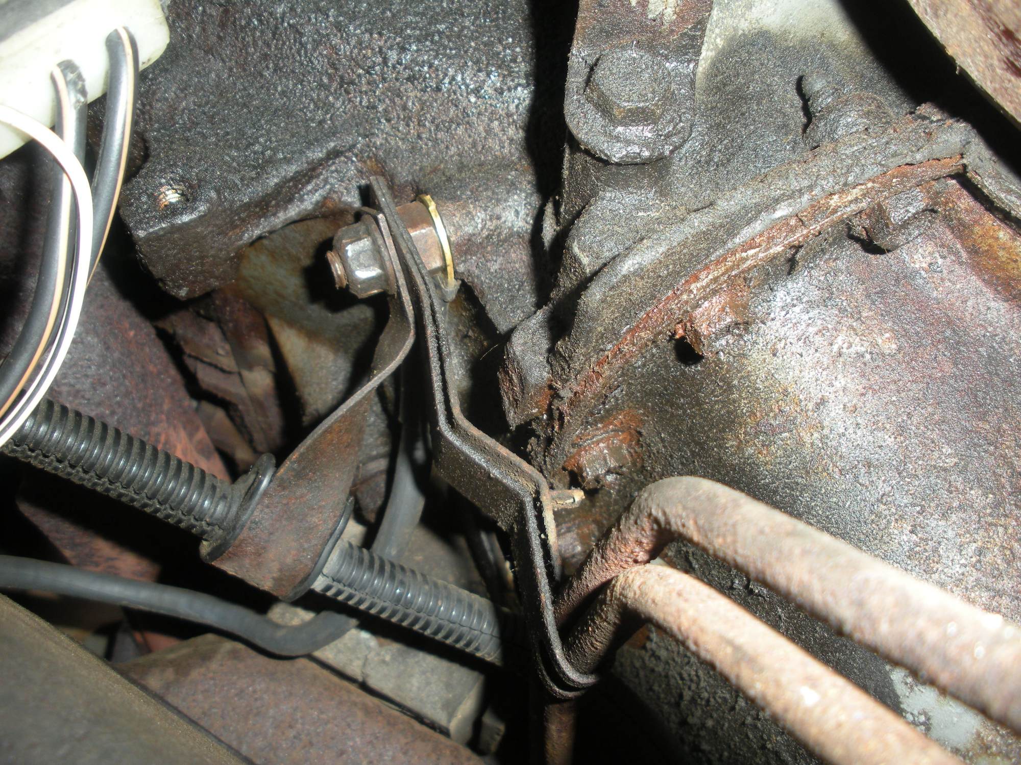

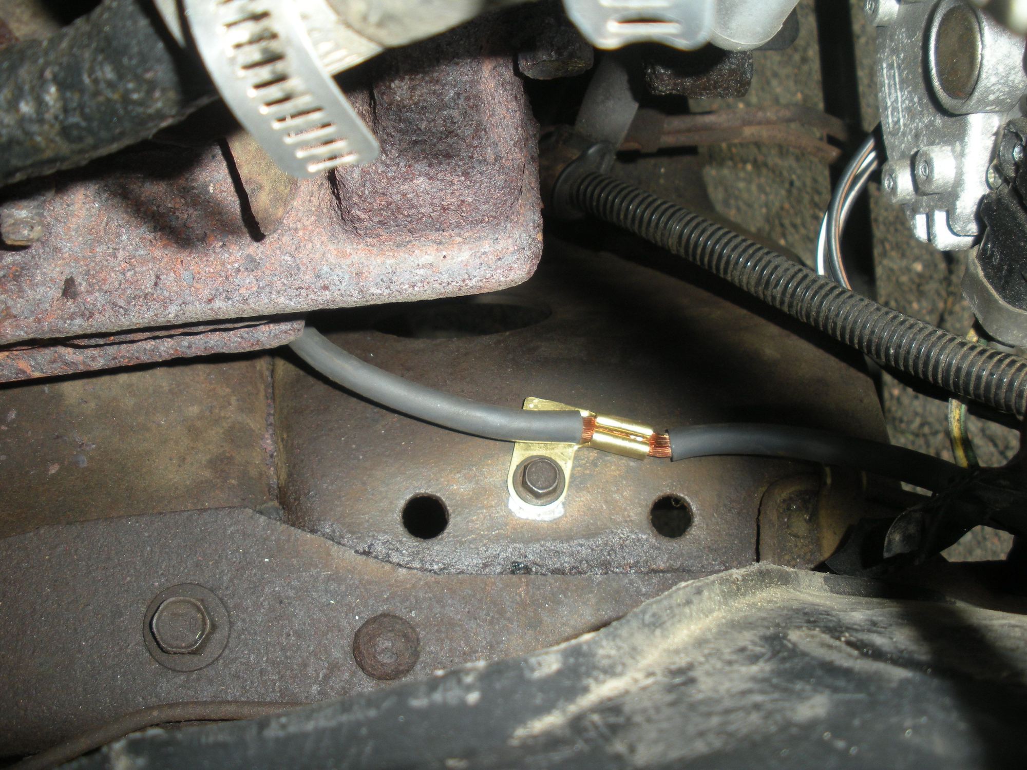

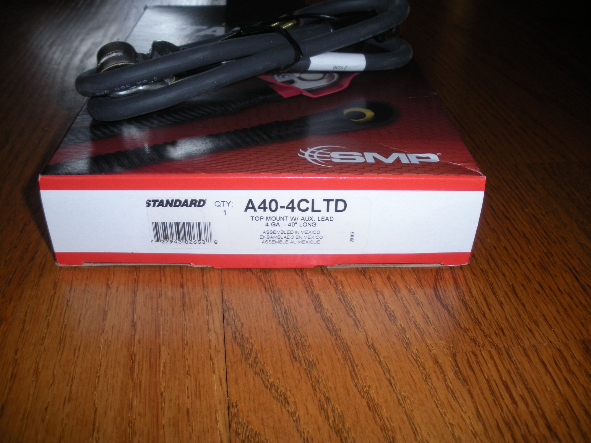

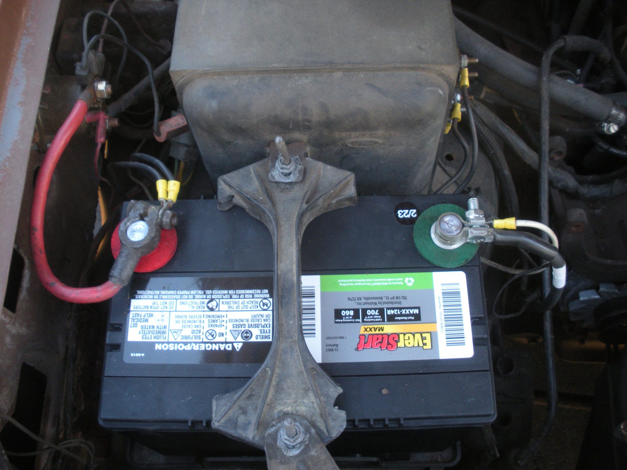

Can we assume that your battery cables look like these ? Or do your's have those cheap, clamp on ones ?

I think most of these trucks have a battery negative cable that connects to the frame and then engine block. Got mine from my local NAPA. I did have to open up the boltholes on the new cable.
