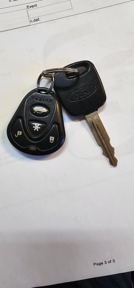

I have a 2002 F150. Is there an anti theft chip in the key? I only have 1 key so I had a couple made at Home Depot. The new keys unlock the door and the truck will crank but not start.
The truck does have an after market alarm and the FOB is with key. So I am curious if the original key has a chip in it or does the FOB need to be in the truck? ( Now that I am typing this out I could test this myself. )
If the original key has a chip do I need to go to a dealership to get another key and program it to the truck??

Yes, your key is chipped.
You can buy chipped keys online and program them yourself. Save that money and just get them carved up.
I did that with a new pair for my ‘03 not too long back.

If the THEFT light on the cluster is flashing slowly with the key out and rapidly after you turn the key to Start then your PATS (Passive Anti Theft System) needs the chipped key.
If there's no flashing THEFT light then PATS might have been bypassed/programmed out when the new alarm system was installed.

PATS was standard in the F150 beginning in the 99 model year. Anything 99 or newer has PATS.
Be aware that if you have only a single PATS key, you will not be able to add additional PATS keys without using a scan tool or comparable. The exception is if you go to a hardware, big box, or key shop and purchase a "cloned" key, about $70-90.
