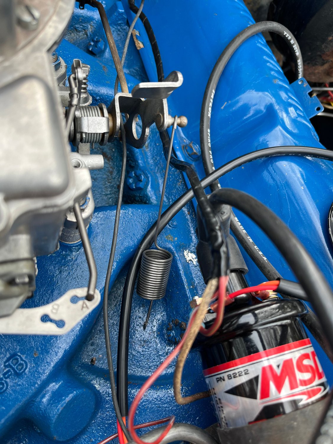

Can someone tell me where the other end of my carb return connects? I can't see anything obvious that it could go to. If someone has a picture I would be most grateful.

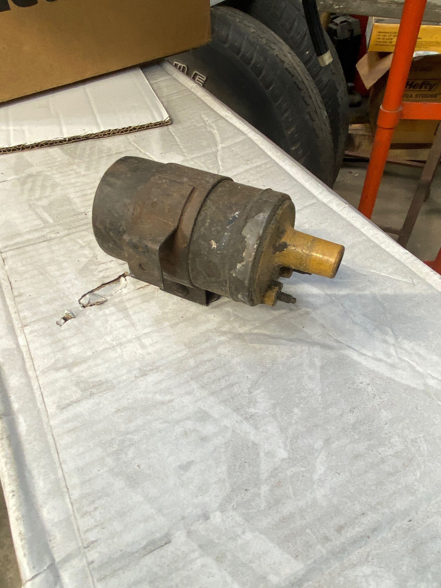

Here is what the bracket looks like. I found mine looking for something else.
68F100 coil and mounting bracket.

Thank you for the picture. But my bracket does not have that piece with the hole in it, or anything else to attach the spring to. I'll have to figure something out.

It's a 72 F250 with a 4 speed. I have all the correct throttle linkage. It's the other end near the coil I have no place to attach the other end of the spring.

Can you attach the spring to the lower part of the carb linkage and go back toward the pivot?

If my memory is correct it seems that some trucks had a short metal tab with a hole for the spring that was mounted under the coil bracket.

I'll take the coil off and see what I find. Thanks.
