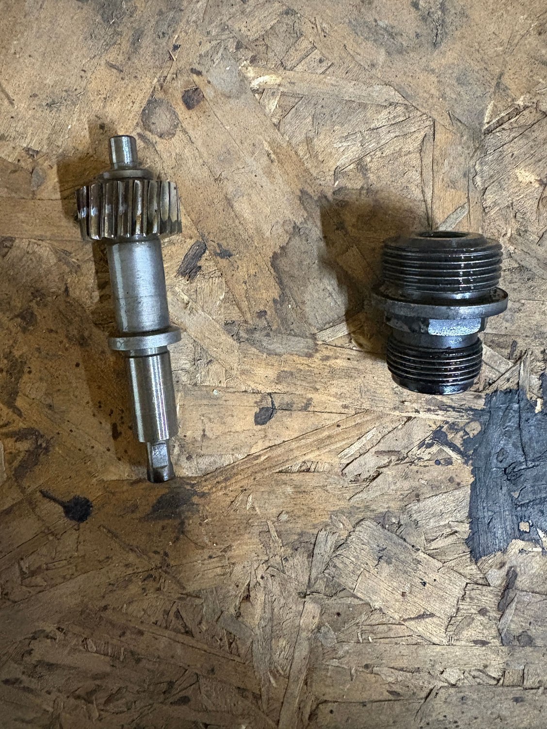

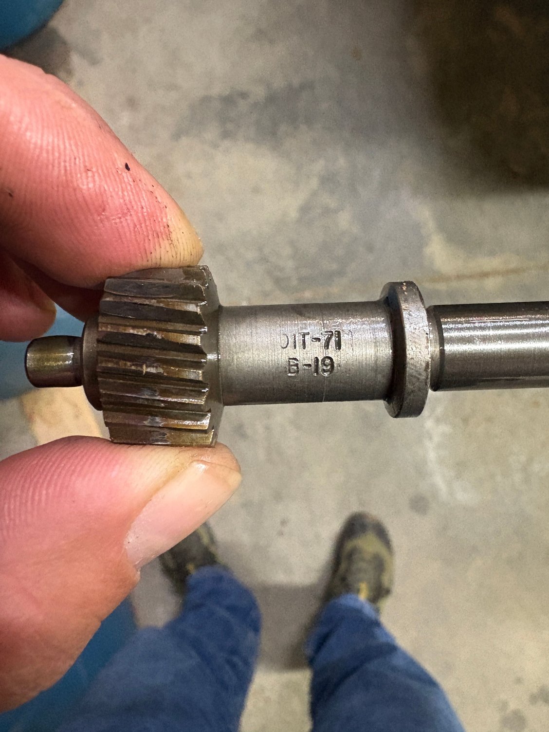

So looks like they are different as I pulled mine out of the transfer case and this is what they look like.
so I’ll be looking for a 16 or 17 tooth gear.
does the 6 in front of the 19 mean the driven gear is a 6 tooth gear?
