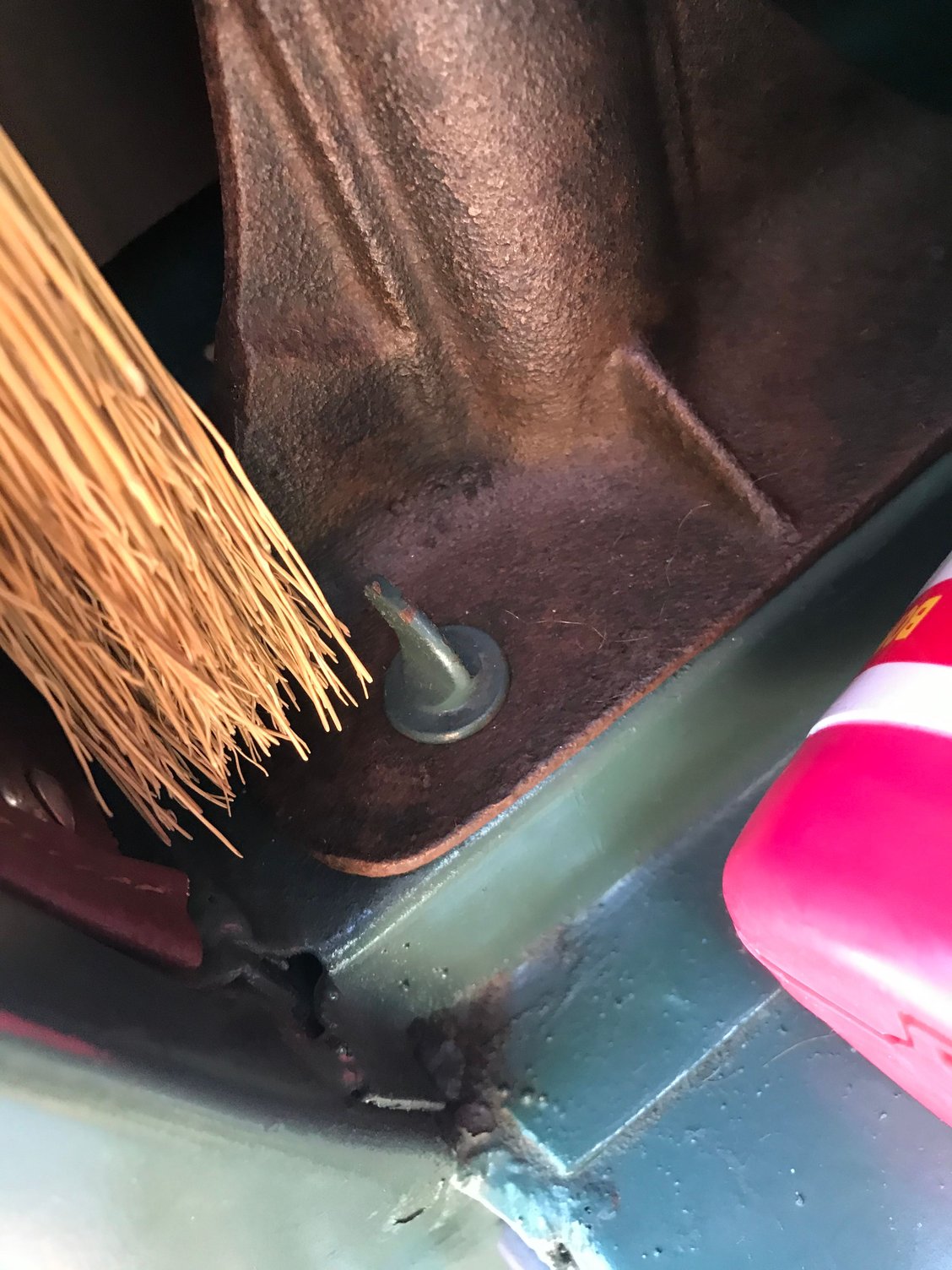

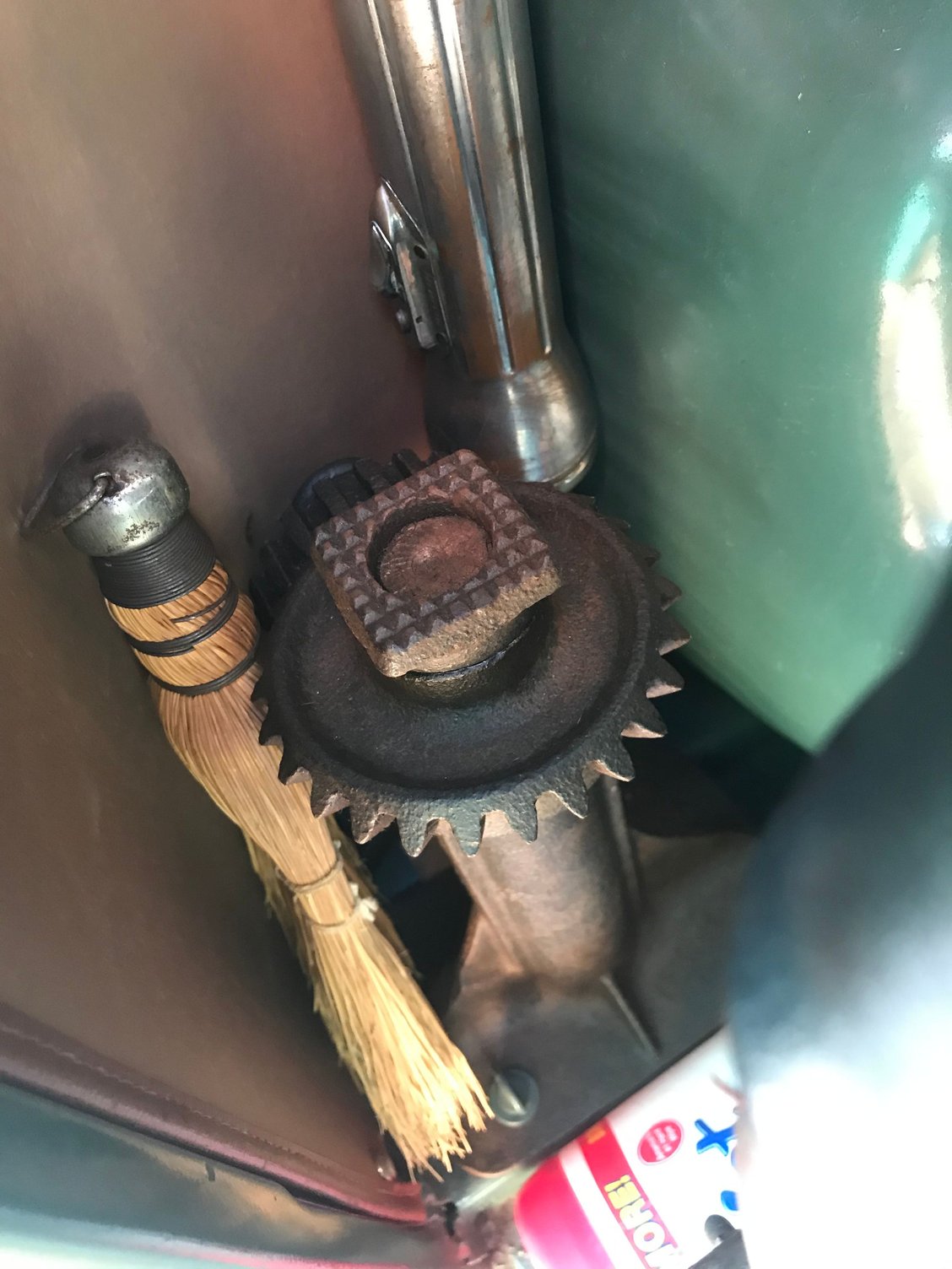

this is the larger truck jack f2 or f4 and above I’m guessing . But it’s secured with the same thumb screw as the smaller more common f-1 jack.

All of those spade handle thumb screws on the link do not have a shoulder on them though- that’s kinda what holds down the surface area.
I think Denny Dehale said he’s got a collection if original screws he’s collected that are for sale

I agree, would have to add a washer also.

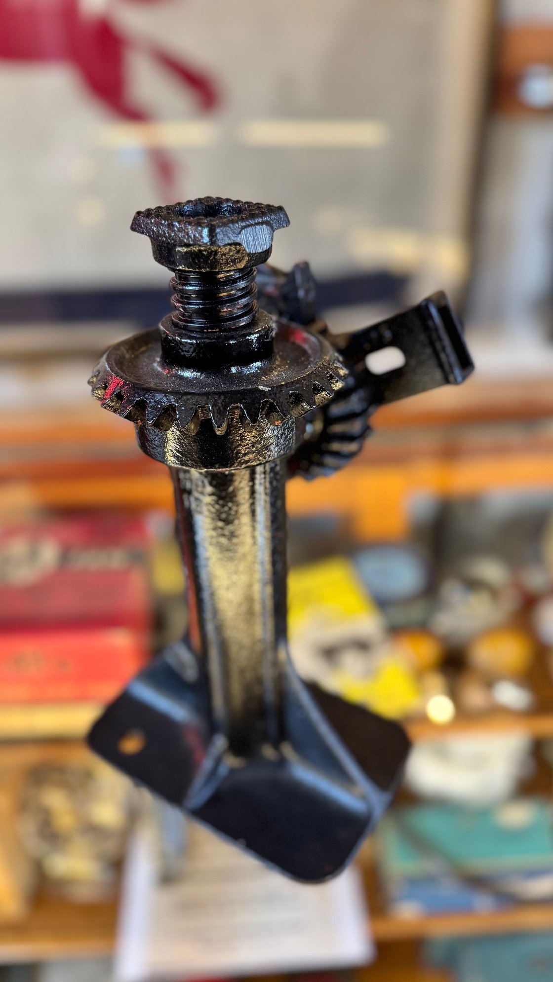

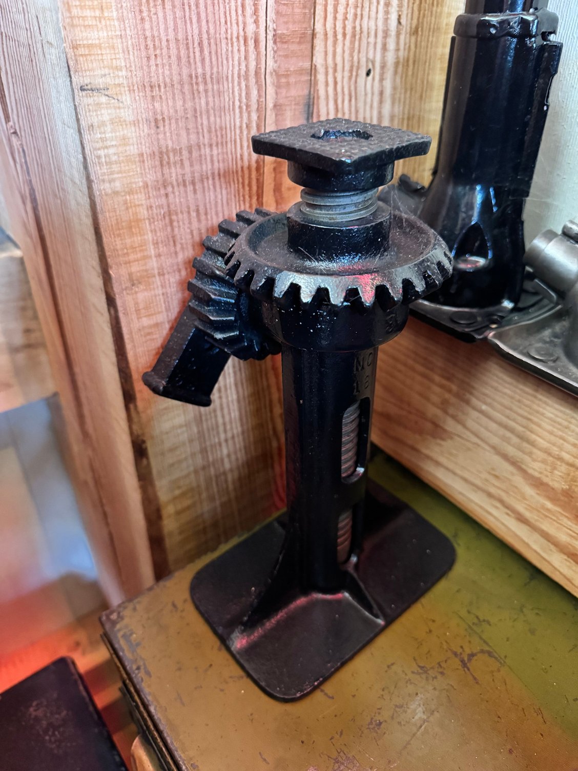

I don't know what jacks were in the bigger trucks in 1948-1952 but here is the jack that was in my original 55 F-350. It was larger and beefier.

It was the jack in my picture above 👆🏼

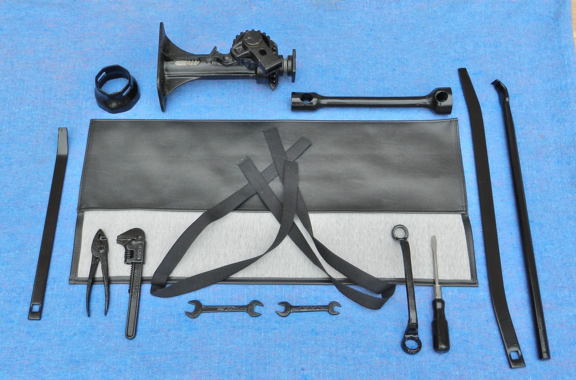

Big truck
jack 1942-
Here's another photo from Lin Stacey, restorer of all Early Ford tool kits. This shows the complete kit for larger trucks. I think he said from 1942 and up. One of the parts pictures is super rare and he didnt have on hand. I still haven't been able to locate it.

Thanks.
I learn something everyday.
I think I have a jack like that. On the farm we called it a tractor jack.
48-52 trucks sure did come with a lot of tools.

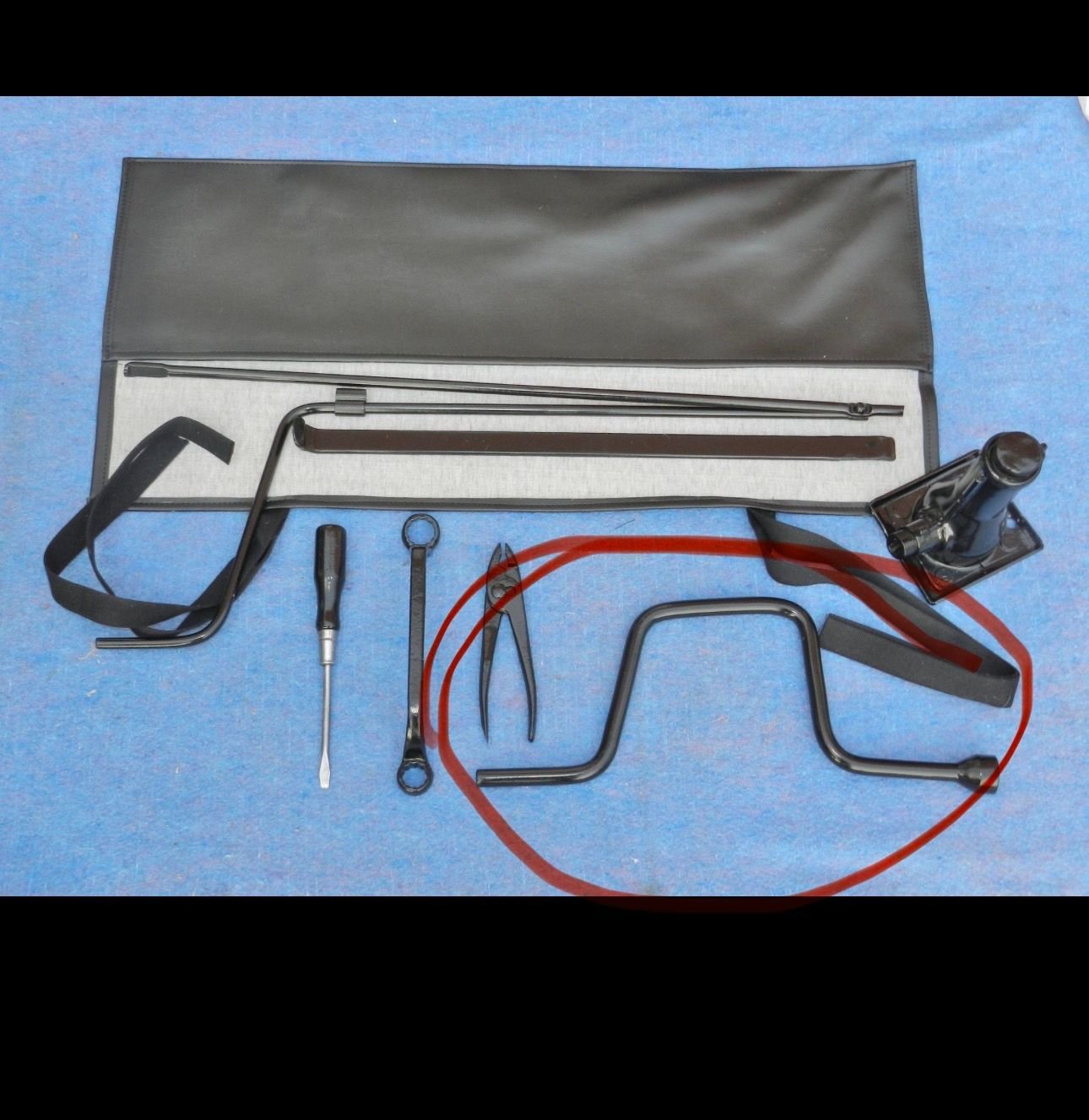

silver star. If you look at my pictures above a couple of the pictures are from Lin Stacey, who went into great depth of research to find accurate information about ford tools in the Ford archives. He advised the early ford v8 club just on tools and he also provided complete restored kits for owners of all various models of early fords both cars and commercial vehicles. He has recently passed sadly. His wife still has a large collection of his inventory however.
short answer; the tools came in a vinyl tool bag seen reproduced in said pictures , according to Lin’s specifications from Ford. They were then I assume placed in the tool tray at least for the Ford Trucks. Not sure what the cars did. The vinyl pouches did come in a few colors as they were made from scraps of leftover material from seat material. The most common I believe was black but Lin also told me about documented examples of brown and burgundy. One of the tool kits I had him make me was specifically a brown vinyl pouch.
I’m not familiar with the spare tire hanger rods.maybe you mean the wheel nuts?
these two tools would work;

The tools were in a tool bag 7RC-17010 like pictured above and stashed in the tool box above the gas tank behind the seat.
