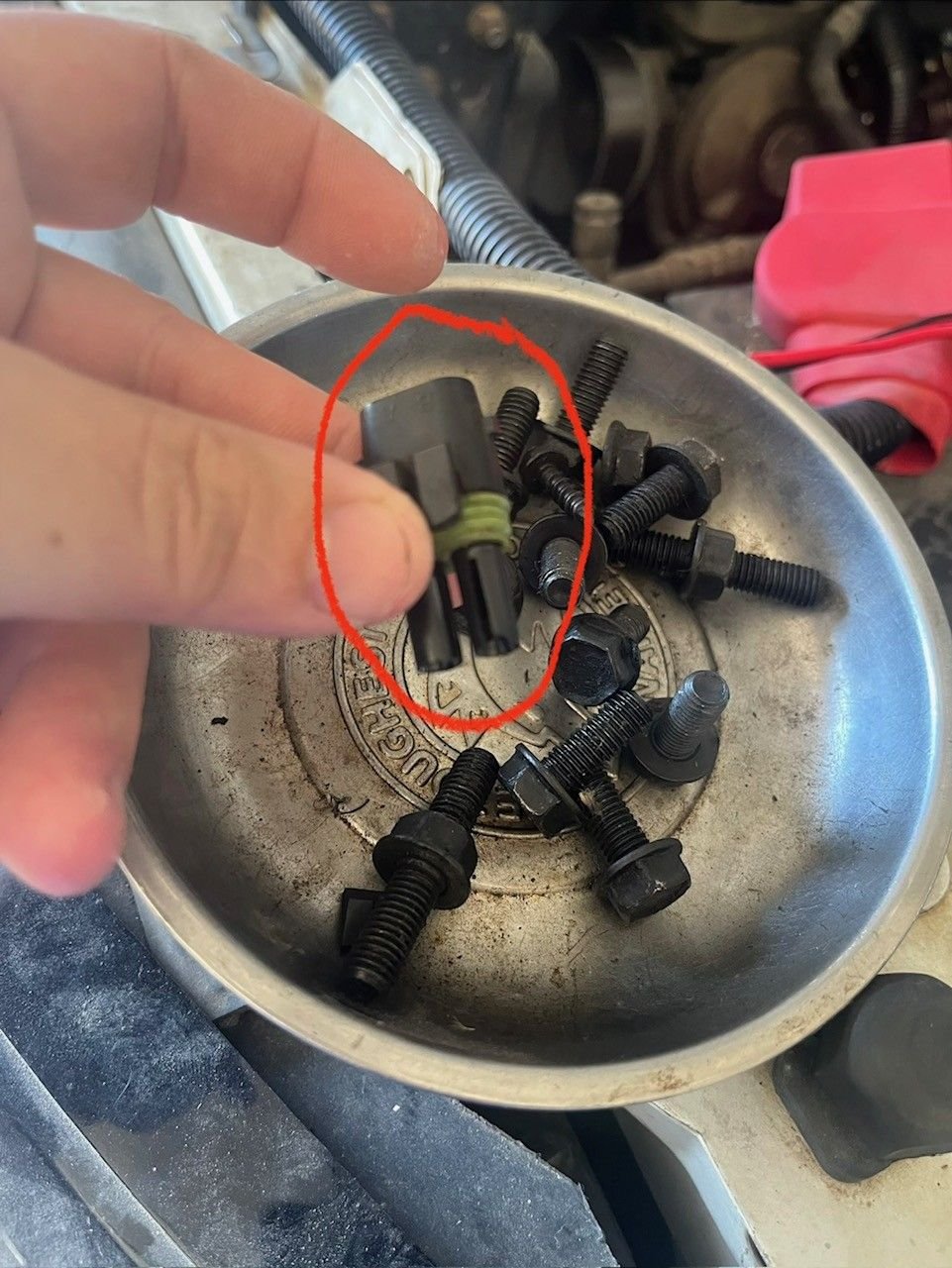

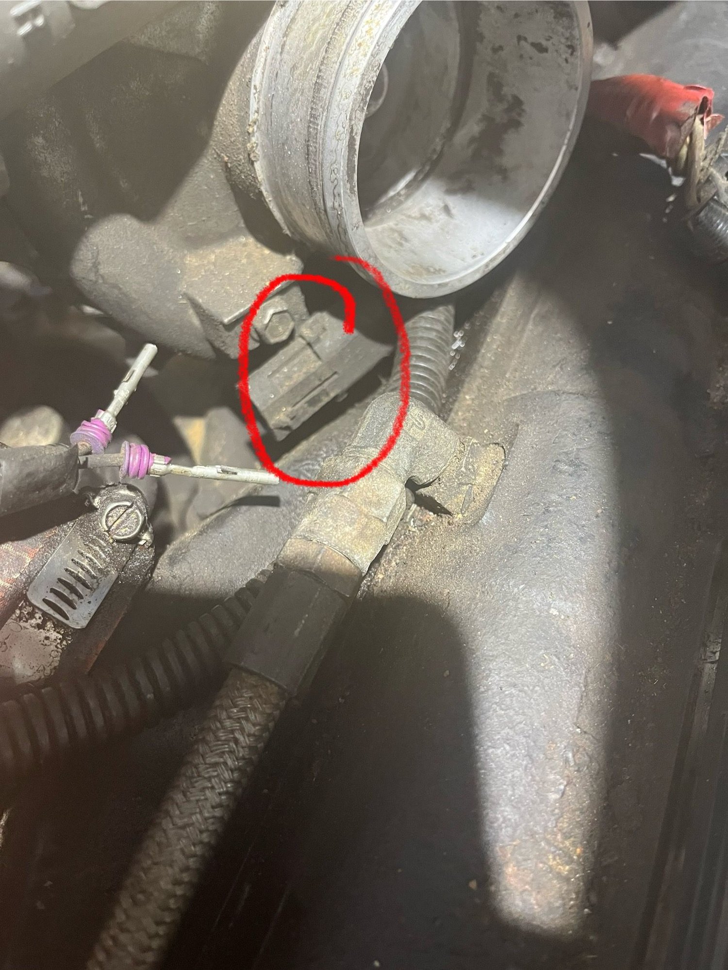

Hello all, I finally got my injectors rebuilt (from Rosewood) and installed back in the truck. I was putting the valve cover gaskets back on when I noticed one of the 5-pin plugs on the top side was damaged. While trying to get the tape/loom off to replace the connector (luckily the gasket came with replacements) these two pins pulled out of their connector. It's right under the turbo inlet but I don't know what it is. An old post I found on this forum said that it might be the EBPV but I am not sure. Either way, the clip on the connector that these two wires go into broke when I touched it so now I need to replace it too. Searching for EBPV connectors I can only find the female side, which is the one in the picture. Does anyone know where I can find the male side connector and how do I know which wire goes into which pin?

Looks like the exhaust back pressure connector. Depending on how cold it is where you live, you don’t need it. Many are unplugged with no impact. You could just tape them up for now, then if you decide you need it you can make the repair.

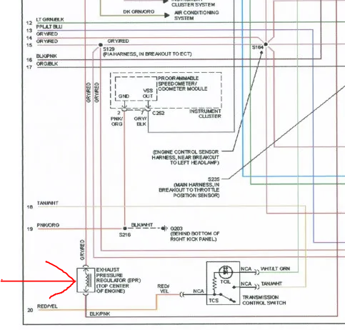

https://www.ford-trucks.com/forums/1...g-diagram.html
Diagram in there

That's not the right connector. Mine only has 2 wires. The diagram you posted also has 3 wires so maybe this isn't the EBP?

That is just a Weather Pack connector. Delphi Weather Pack 2 Pin Sealed Connector Kit 14-16 AWG | eBay If the wires are good push the pins back into the black connector. Or you should be able to get a new one from a good parts house.

The wires/pins are still good but the retaining clip is broken, I'll see if the local parts store sells that. Now I just need to find out which wire goes in which position. The wires are so old it's not real clear what their colors/stripes even are but if someone could tell me what color they are supposed to be I could probably tell.

I found the replacement connector at the local auto shop, thanks Tom! Does anyone know how I can find out which wire goes to which pin? Every wiring diagram I can find shows 3 wires but mine only has 2, but none of them show pin placement.

3 wires is for sensor EBP
2 wires is EBPV aka EPR on diag
