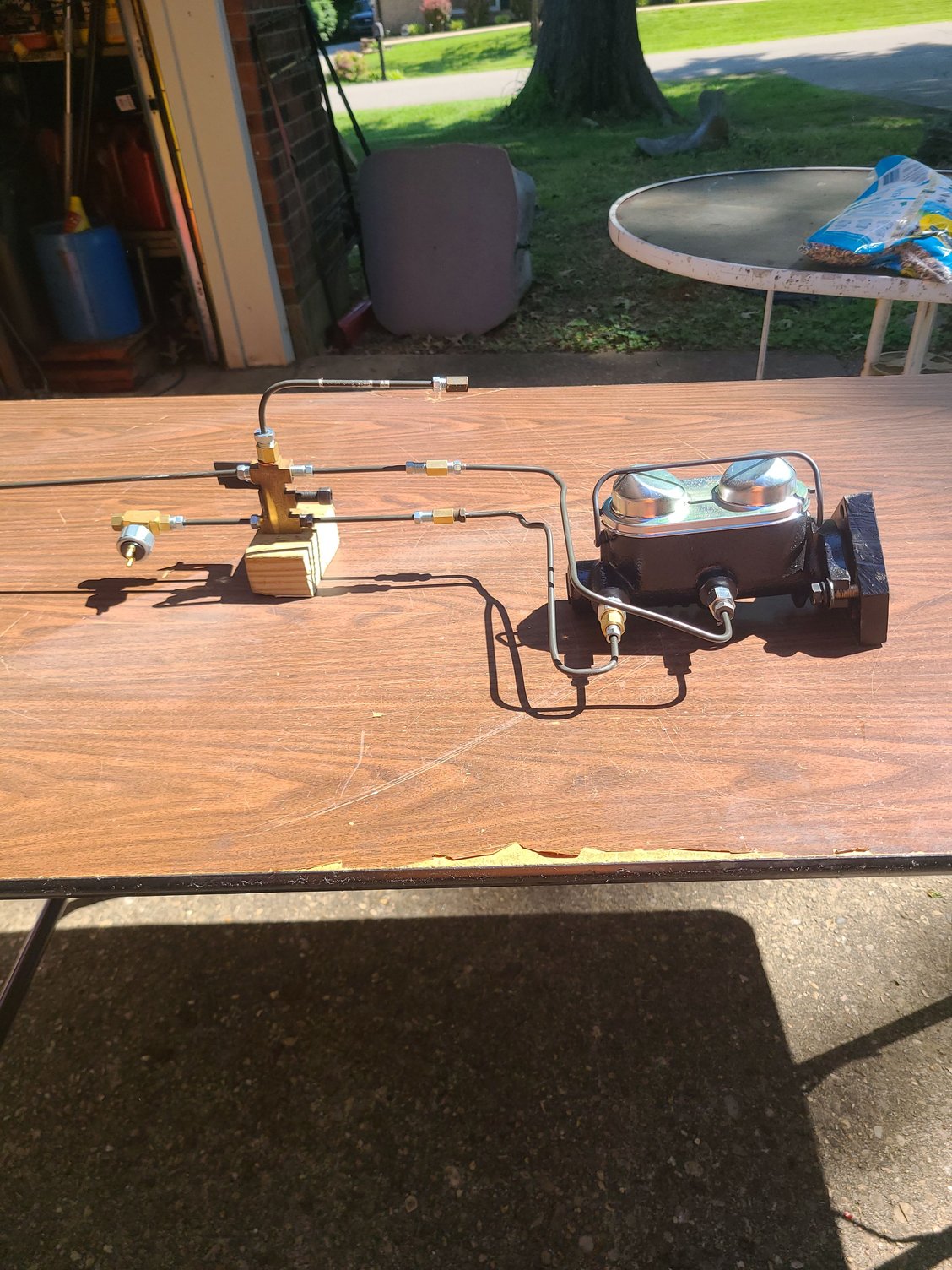

Had to order the residual valves. Mocked up where it is needed to go.
where the Union is is where the Residual valves will go. Then need to fasten them to the inside frame rail. Tomorrow will install MC to verify my calculations were correct. But I know it could still bite me.
Adapter is upside down to keep MC from moving.
Dale J
Ford52F2
Old Yesterday | 04:31 PM
Ford52F2's Avatar
Ford52F2
Joined: Feb 2009
Posts: 172
Likes: 48
From: Louisville, KY
Mounted F2 Adapter and MC. Had to change the hex head bolts on the MC to 3/8-24 socket head.
Hex head bolts interfered a little, couldn't use a socket to tighten them.
Was able to install MC may just bench test it under the truck.
Checked fittings, will need Relief valves to finalize it.
The proportional valve will reach back between gas tank and frame.
Brake switch interferes with fuel tank.
After all Checked for position will need to add clamps to secure everything.
Dale J.
Ford52F2
Old Yesterday | 04:35 PM
bmoran4's Avatar
bmoran4
Parts Nerd Extraordinaire
Joined: Sep 2010
Posts: 4,326
Likes: 1,759
From: Western NY
I believe it looks like you can rotate the T fitting for the brake switch easy enough so that there is less interference.
Old Yesterday | 04:46 PM
Ford52F2's Avatar
Ford52F2
Joined: Feb 2009
Posts: 172
Likes: 48
Just wanted to keep from having an air bubble trapped at the Brake fitting. May swap where the rear line go with the brake fitting. Then do a tight bend on the rear line.
