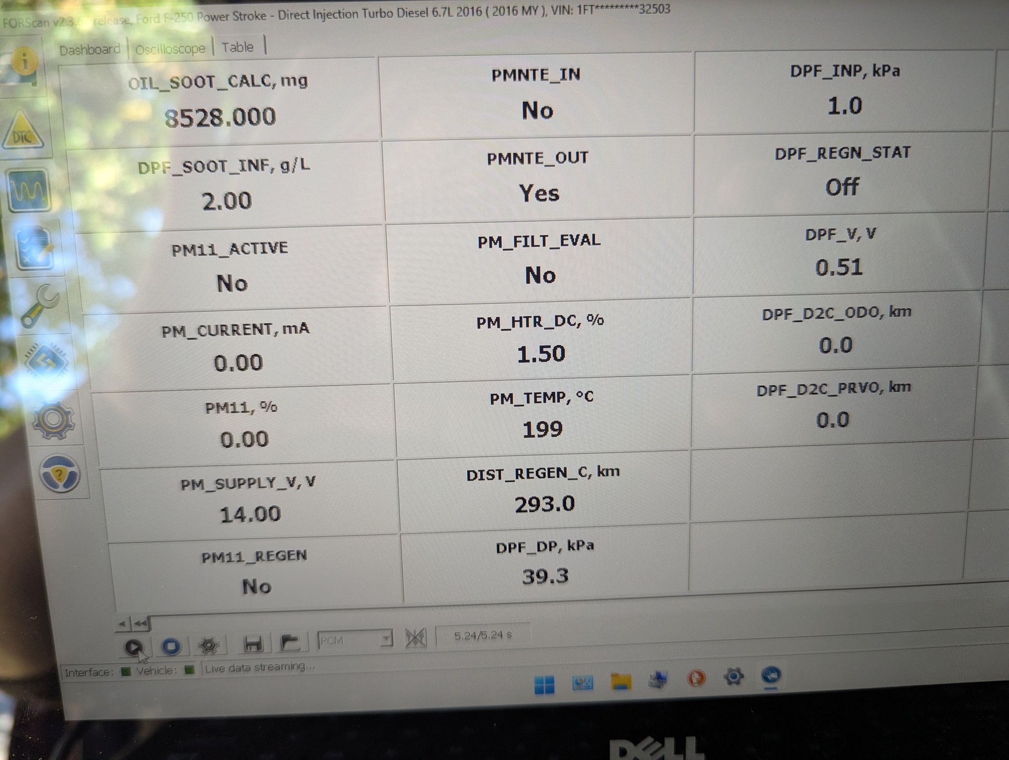

  • Do these values mean the particulate matter sensor is broken?
  • Can I get back to driving my truck - wait and see if the code comes up again?
  • Should I trigger a manual regen before replacing the PM sensor? Might that somehow help?
  • If the particulate matter sensor is broken, then the truck will not kick off regens on its own, right?
  • The code's explanation says the PM sensor might be dirty. Can it be cleaned short of removing it from the tailpipe?
  • Theoretically if I were to leave the possibly broken PM sensor in, while occasionally launching manual regens, then would I be able to safely operate the truck over long distances? Pure curiosity - if this had happened 700 miles away, could I have used manual regens to get home?
As Per ForScan
PM11_ACTIVE = No
PM_CURRENT = 0 mA
PM11 = 0 %
Sometime previous to last week:
I've been driving very short trips. Eventually was able to take a longer one. ScanGaugeIII showed a regen occurring. Watched as the soot % dropped, dropped, dropped, then stopped dropping. Regen remained active. I had to stop the truck. Regen hasn't started since then.
Last Week
Check Engine light on. Code showed P24AF. Manually cleared the DTC codes. Came right back. Parked it after I finished my trip. Ordered a new PM sensor.
This Week
Since then, all the emissions tests have reset. The p24AF is gone. New sensor has arrived. I've not been able to gently coax out the old PM sensor. I'll try removal again once the special line socket arrives.
Photo of metrics shown by ForScan
2016 F250 6.7

Answering my own question using comments found on this forum.
Soot % Open vs Closed
Summary
Open Loop Soot% is a calculation based on many factors. It's used when soot % are high.
Closed Loop Soot% is based upon sensors in the exhaust - such as the Particulate Matter Sensor. On my truck, the Closed Loop % is labeled PM11%. It's used when soot % are low. I take it from @Work Truck Fanatic 's explanation that the Particle Matter Sensor isn't always turned on. This explains why there is a metric of PM_Active - yes/no and PM11=0% when I damn well knew the actual soot% was much higher.
So, no, a PM_ACTIVE = no does not mean the Particulate Matter Sensor is broken
