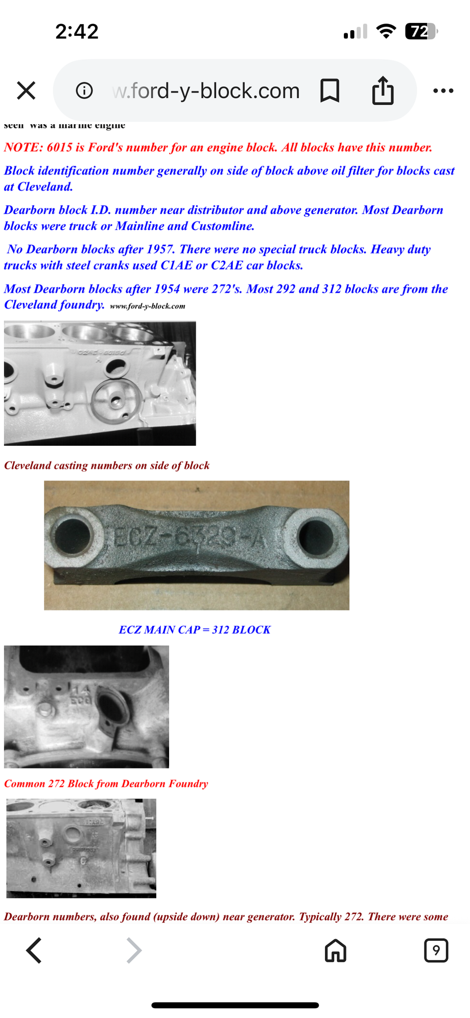

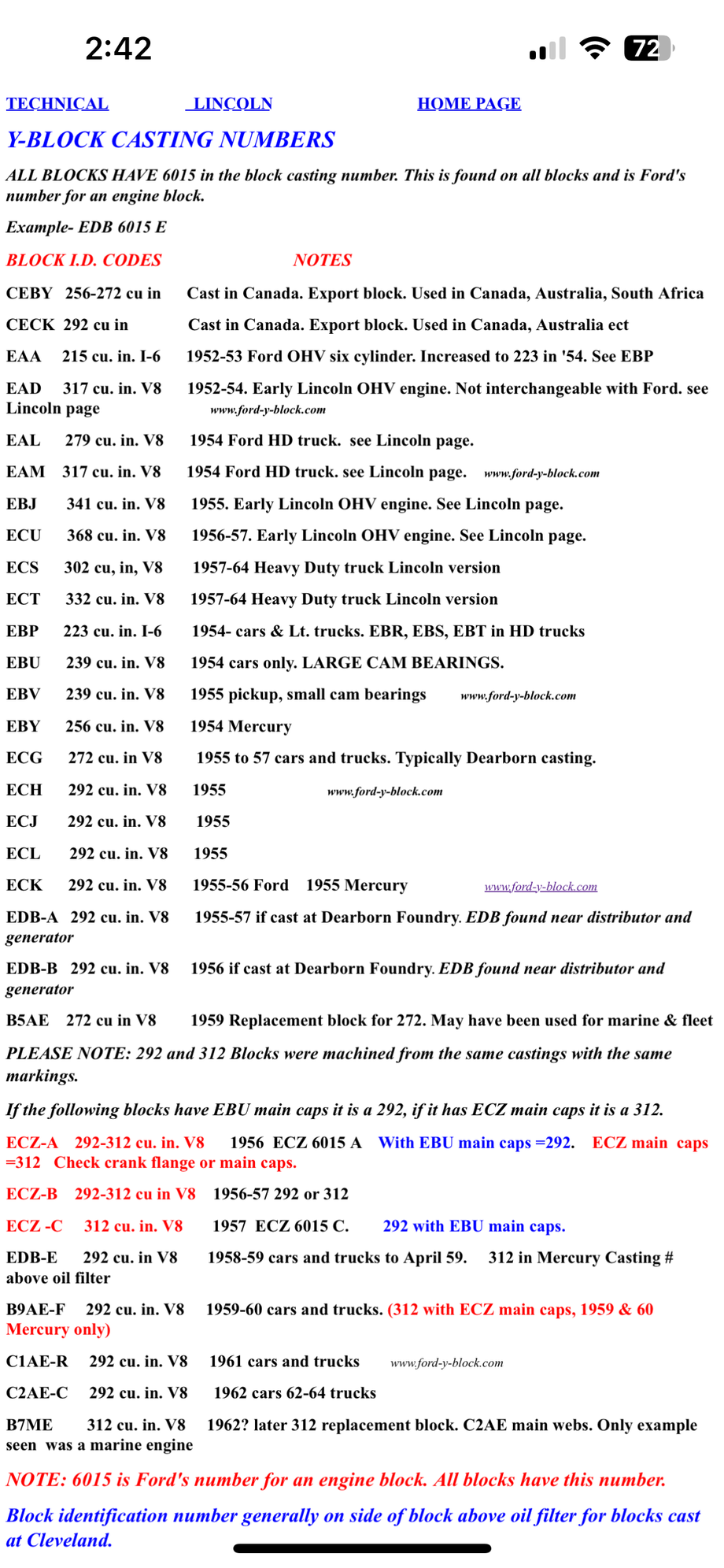

Everything you need to know is in this link
FORD Y

The block casting number, such as EDB-6015 would give information on the specific block application and help narrow in the date.
An engine assembly date can usually be found stamped in the block just under and to the left of the thermostat housing. The first number represents the year, the second character the month, and the last character represents the day of the month.

Cleveland blocks the numbers are in the driver side above the oil filter

Your confusing casting date vs assembly date.
