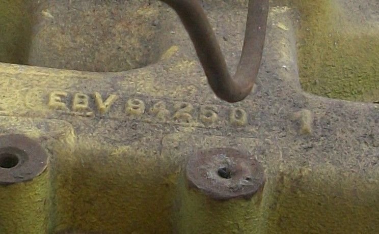

If it is a 239 it was only built in 54 and 55
Here are block casting numbers: TECHNICAL
EBU is 54
EBV is 55

Here is a picture of my intake with the EBV destination
