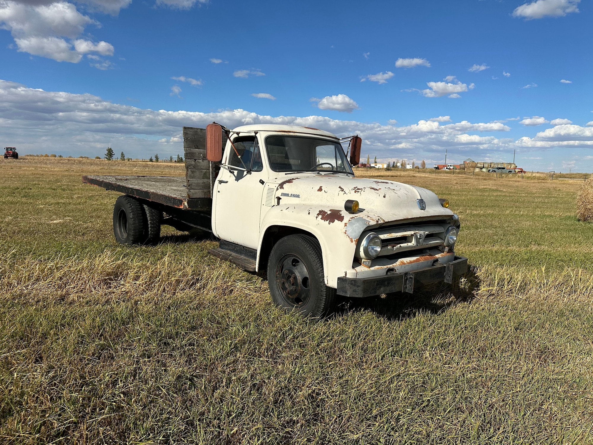

53 Flathead Hard Starting when hot
I got my 53 F600 with a sweet 239 flathead running. It runs nice.
When it warms up, I have stalled it twice and it won’t restart. I’m thinking it’s the coil getting hot so I ordered a replacement.
What are your thoughts?

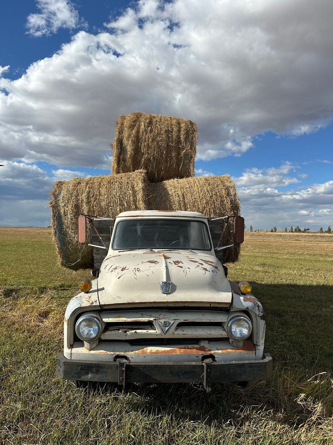

.... and it's great to see an old Ford truck still used the way they were built for!
My brother had a 53 F600 dump he used in his concrete business but that was 15 years ago. He called it Old Blue.
