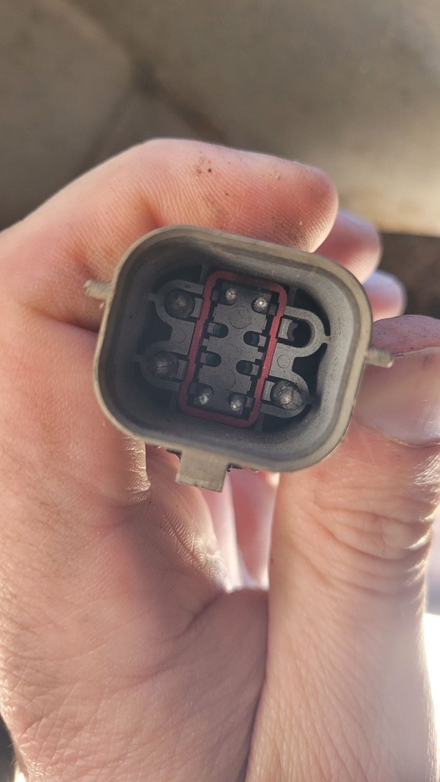

How do I get this red ring out so I can remove the pins?
How do I get this red ring out?

hemostats maybe

it seems brittle but thanks for the suggestion

Show us the sides of the connector.
ot looks like the 4 pin holes in the center , might be retaining tabs .

I ended up getting it apart. But the sides are all closed up. I euped up taking the back cap off and was able to push that red ring through with a tiny screwdriver
