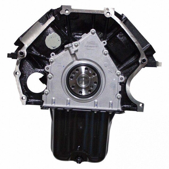

It is very easy to miss the inner hole that lines the sensor up.
Old Oct 10, 2025 | 10:02 PM
Lattaford28's Avatar
Lattaford28
7th Gear
Joined: Oct 2025
Posts: 7
Is it noticeable when installing it to know if it’s lined up correctly?
Old Oct 10, 2025 | 10:08 PM
CCradier's Avatar
CCradier
Joined: Sep 2020
Posts: 36
Likes: 13
From: Magnolia, TX
I cant find a decent pic at the moment. But the sensor will drop right in as it came out and miss the line up hole at the bottom. Watched one of my techs fight this very thing. And of course it couldn't have been that. It was. A flexible camera will show it.
Old Oct 10, 2025 | 10:11 PM
CCradier's Avatar
CCradier
Joined: Sep 2020
Posts: 36
Likes: 13
From: Magnolia, TX
Here ya go.
