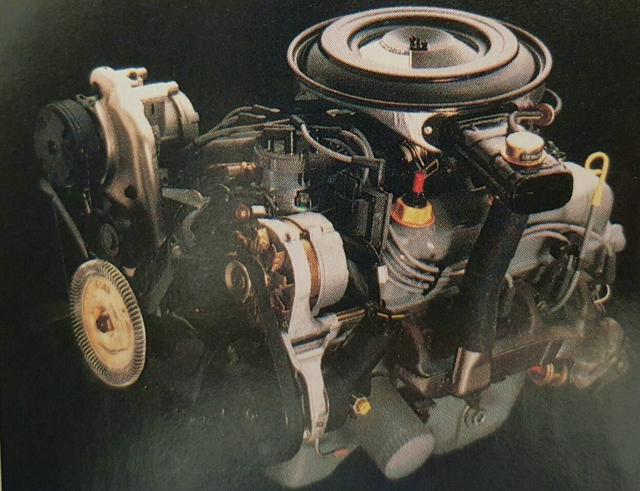

Pre-85 302s with serp belt had the alternator on the left. Search pics of 1984 Crown Vic w/302 and I think you’ll see the similarities.
This is a crappy pic that I got off the interwebs but I think it shows the same alt/ps bracket:

If I'm not mistaken, the OP's setup is not a true "serpentine" even though it's using most of the components.
I don't see any idlers or tensioners, and all the pullies look like they're grooved, with the belt running in one direction only, on the ribbed side. The crank is even configured with two pullies, like some few engines, rather than just the one we normally see in most cases.
And the brackets are cobbled together in some cases. I think this may be someone's early swap over to their own version.
The engine, or at least the front cover and such, are later model, as you can see the "timing pointer" or whatever that loop is called, there on the passenger side. Most definitely late model stuff.
But with the belt going in only one direction, cobbled up mounts and brackets, there's no telling what it all came from. Or even if they all came from the same vehicle.
Looks like they even used the early (standard rotation) cooling fan so that it works with the single direction belt.
