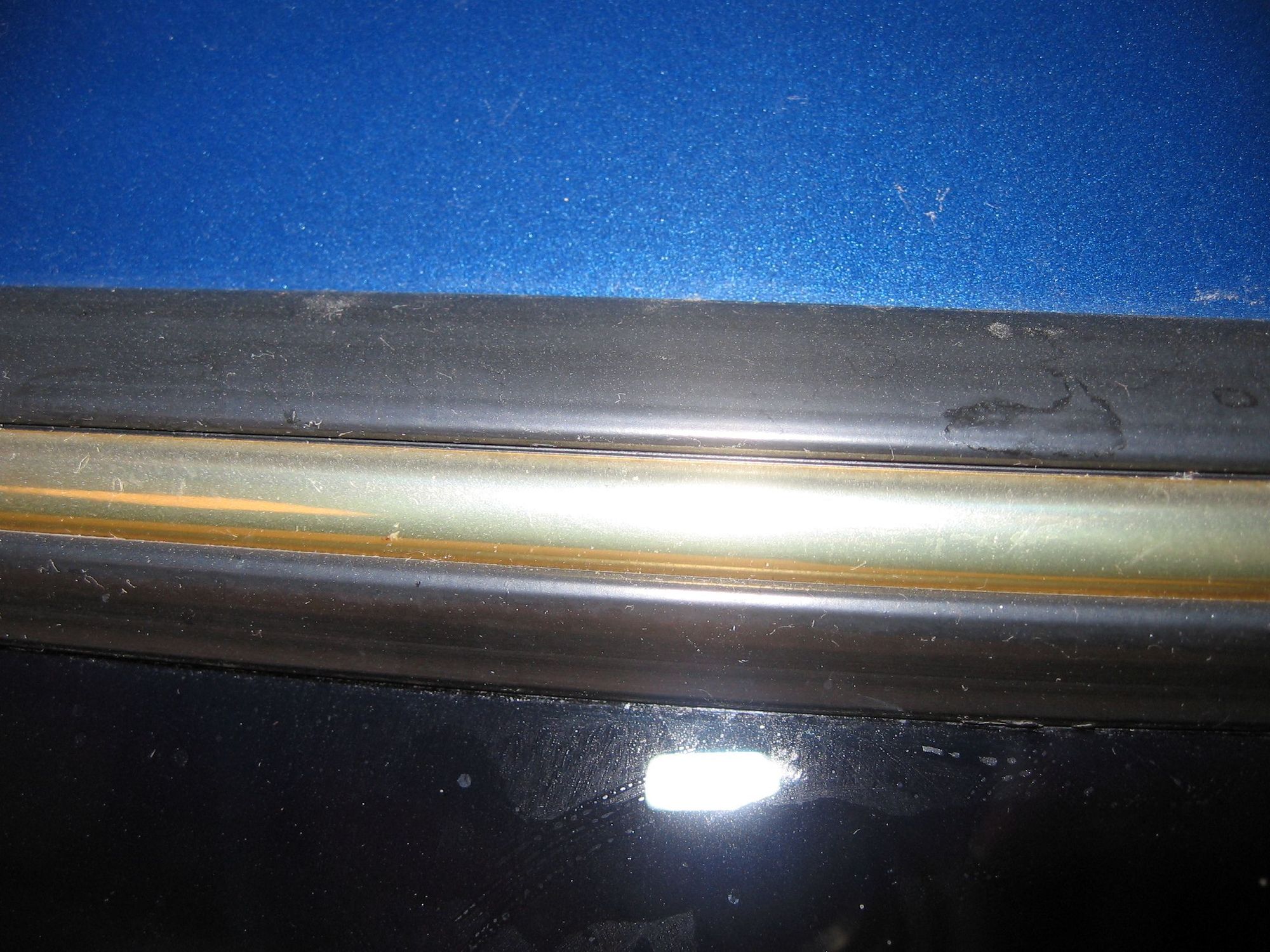

Yes, you have the wrong gasket. The 78 gasket should have either a narrow black or chrome locking strip in it.
Pictured is my 1979 F150 equipped with the original 46 year old gasket Ford installed on the assembly line. Gaskets usually don't go bad here in the rust belt.
Without consulting a parts book, I would guess that there are at least 3 different windshield gaskets for the 73-79 F series.
Exactly!!
Thanks for your input!
