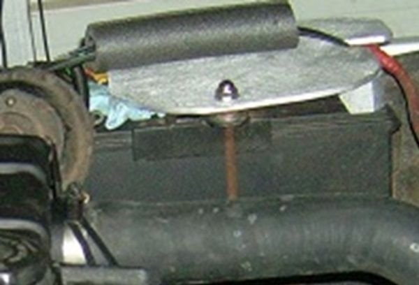

Was in 2015 or so I tested my '77's group 24 battery, it was then over 12 years old, it was testing at 400 something CCA, it was showing it's age but was still serviceable. Next few days I found a used group 65. after measuring I decided it would fit. I removed the cheaply made universal battery hold down set up and made a heavier duty one that fit my new to truck group 65. I put a piece of plywood under it, it really fit good. Was maybe a year later I replaced that group 65 with a near brand new group 65 that a customer insisted on replacing just because he did so yearly. I bought it from the store as used, and it lives in my '77 still. I have group 65 batts in my '07 truck, a '01 Mercury, a '95 T-bird, but back then was two more T-birds in the driveway with them. I have two more group 65 batteries in the basement that are kept charged too, one was the original in the '01 Mercury.
So anyway, I had redone my mounting hold down, etc. Recalling the ease with which a tool or metal can can cause a short I made a wooden battery top cover to hide the positive connection. For a few years, it's been secured by round top nuts that don't pose risk to skin. They can be a PITA to remove though, without pliars, etc. Today I made wooden, easy to turn by hand, ***** with metal threads inside.
The group 24 with universay hold down
Current group 65 with my DIY hold down and longer 5/16-18 J-bolts
My top cover but with the round headed closed nuts still.
The block at rear moves the cover up off the positive cable clamp too, and I can remove the negative clamp with the cover in place.
I know there are clamps now with plastic covers too.

Was just stretching, walked out for a POV over hood shot, lifted the hood too. Really easy to remove by hand / no wrench or other tools are needed, no sharp threads exposed to cut, no accidental shorts from dropped tools or turned over cans of flammables If need to replace a fuse in a fuse holder, fast easy access.. Actual nuts and washers holding battery in place are next under the plywood plate .... the plywood is simply lifted, then turned a few degrees CW and slid out towards the fender from under the strap.
I promise, those ***** are made of layered plywood. The top hex is a very short bolt. It just catches a few threads into the top of the long insert inside the wood. Wood is wrapped with foil tape over silver paint. I might even add short fence like walls to the flat "plate" so stuff (nuts, bolts. etc) doesn't roll off out of sight.
