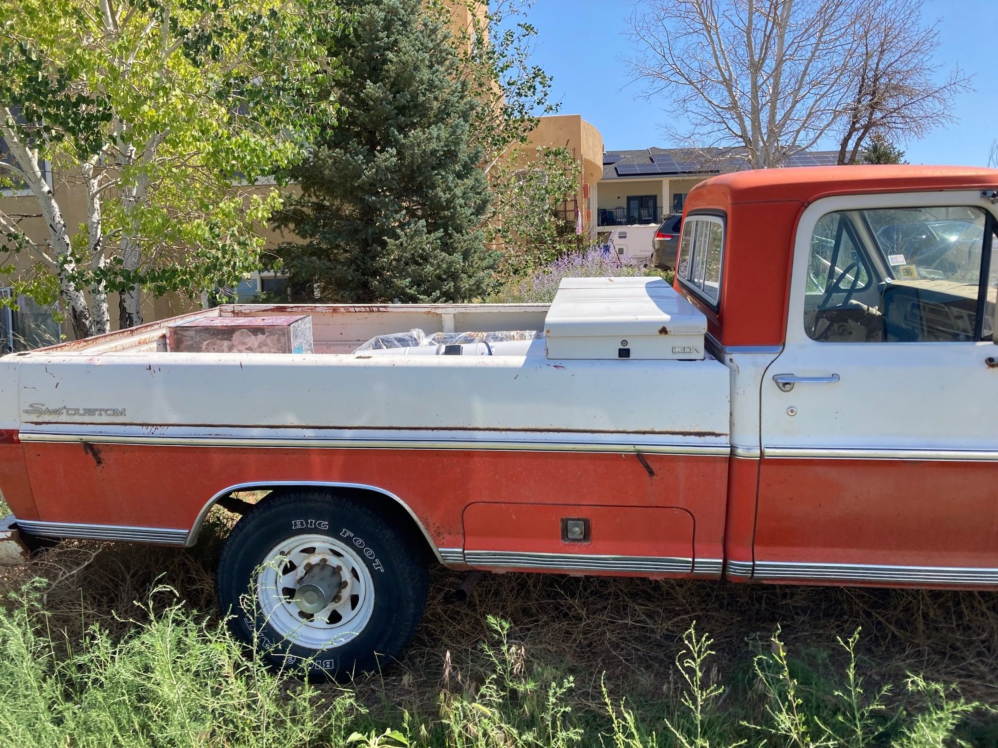

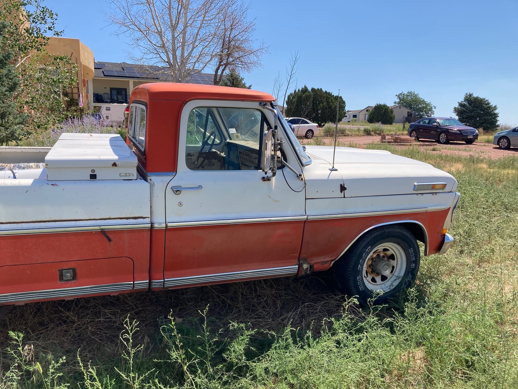

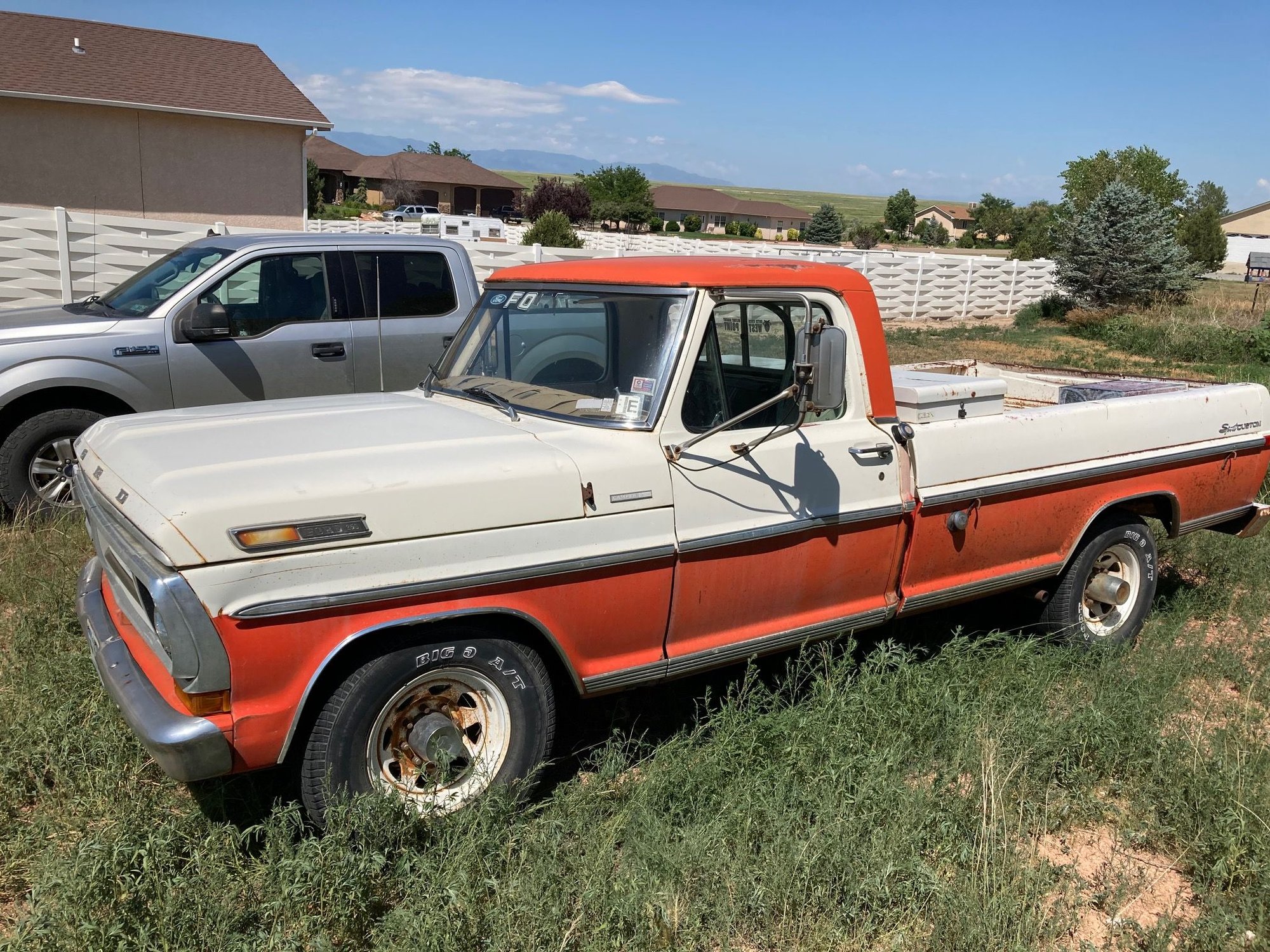

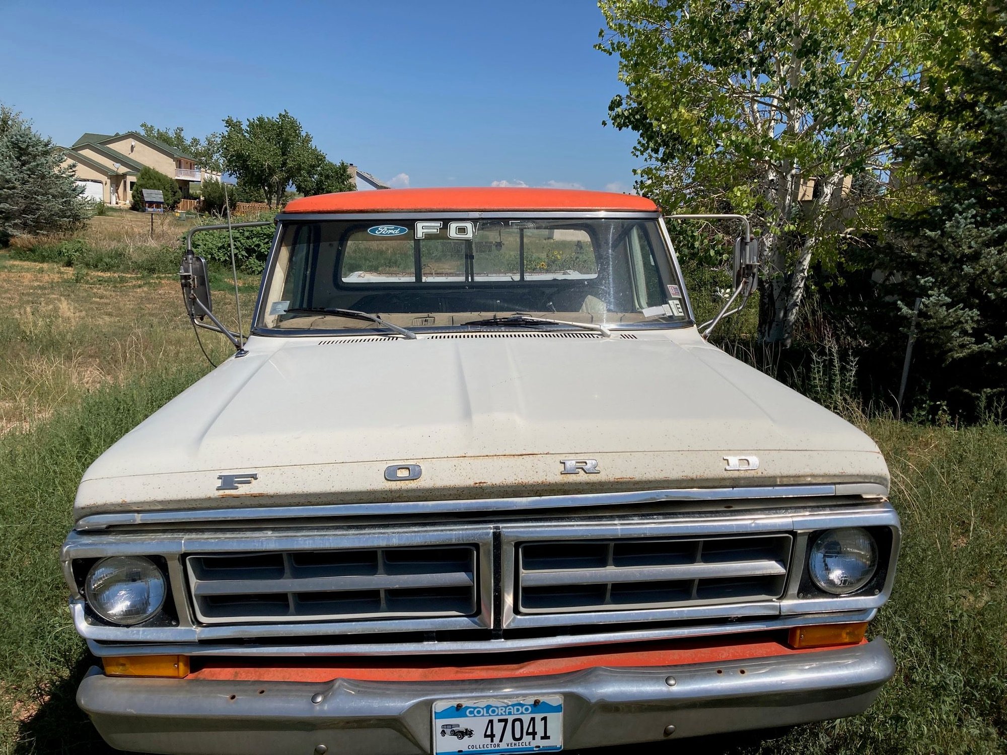

So I would like to start off by saying that I have little to no experience when it comes to working on vehicles. I have changed tires and oil, but never done any real work on a car. On Monday, I will be receiving this 1971 F250 camper special. The car is in working condition except for something wrong in the transmission, not letting you manually put the car in lower gears, but in automatic, it drives fine. I would like to ask for advice from people on this website as to what my first steps should be in making sure this truck doesn't fail on me. Whether it's changing the oil, buying a new carburetor, or what you all suggest. I would also like to address the body rust and how one should go about cleaning that up, or fixing it. In addition to the interior, I could get my hands on new bench seats, dash, etc. I would like to preface that I'm a high school student with a little over $1000 from a summer job, but if it requires more money, I am considering getting a part-time job in order to fund this project. If anyone responds, thank you so much for taking the time to give me your knowledge
I would also like to preface that these images are 3 years old, and when the truck is delivered, I will make another post with updated and more in-depth photos.

That truck looks really good on the outside. First thing to do is the brakes. replace all the wheel cylinders on each wheel and the two front brakes hoses and the one from the rear differential to the frame. Then bleed the entire system to remove all of the old brake fluid. Good luck.

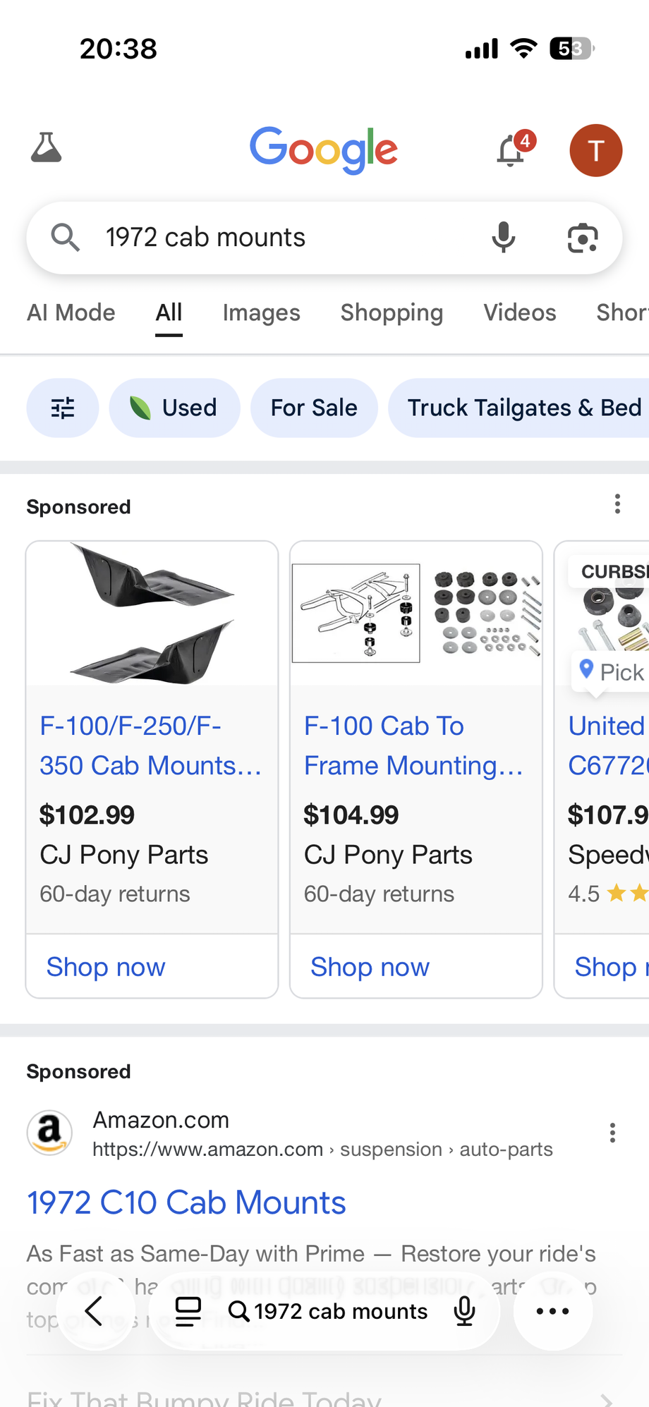

What's the floor of the cab look like? Changing the cab mounts out isn't a terrible process but does take a welder. Actually you likely could just use the new body weld adhesives too. Welders are pretty cheap anymore and it's a good skill to have. Cab mounts aren't terribly expensive to do it right. But you can certainly just scab some steel to them and make it work fine. The 72 cab I scrapped had plate steel welded in place and it did the job fine. Unless that cab is totally trashed (roof ready to fall off, floors totally missing) I would just fix the one you have but pictures mean a lot more there. There's tons of folks that have done it here and some that have done it without removing the cab. Many youtube videos too.
A quick google says they can be had for around $100 for the pair. A usable welder under $200. Look into taking some welding classes at school or your local community college. My kid took a welding training program and coming out of high school would have had 90% of his certificate done if he stuck with it.

My starter motor crapped out, so I need to replace it with my friend. Other than that, there aren't any known issues, so I will probably start addressing the rust holes in the cab after that(I plan on buying a welding setup to tack weld some metal on it, I'll put carpet in eventually, so she doesn't need to look pretty). I can send you pictures of the cab tomorrow so you can actually see it, but what could be found for around $100 for the pair? I don't know what you were referencing.

If you were close I’d just give you a starter. I have a spare or 2 kicking around.
Here’s a screen shot from Google.
