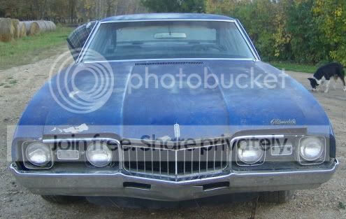

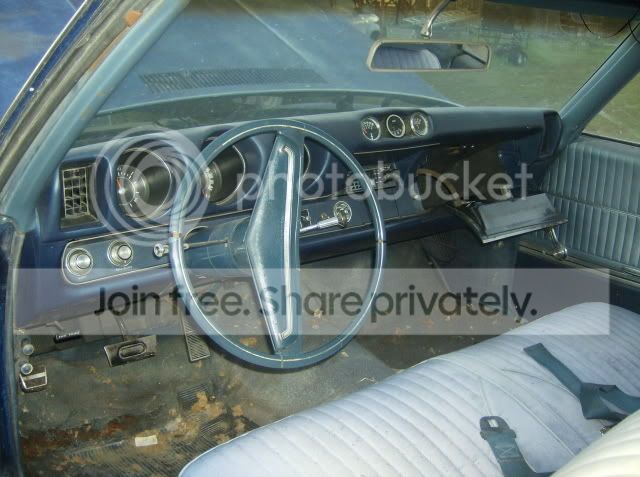

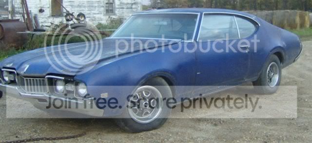

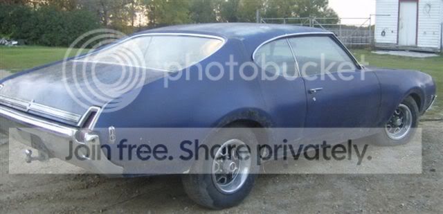

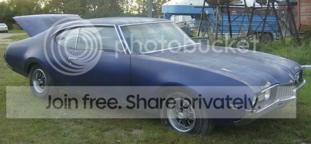

I found a car Im interested in, and I think I might just buy it. What do you guy's think it's worth?
Specs: 68 Olds Cutlass, 455 Rocket motor, Parked for 15 years. I asked about rust and mileage, waiting for a reply. It ran 15 years ago when it was parked.
Pics:
Thx for looking, what ya think?

Try to get some undercarriage pics. So far $2,000.00 doesn't seem too bad. Are you going to bring it back to original condition or "Rod" it?

Hold up there, something is a bit off here. That is a '68 front end (I had a '68 Cutlass Supreme hardtop coupe), but the back is '69. The back end is not easy to change, it require a new trunk lid (different from '68) a '69 only rear bumper, as well as tail lights. Looks like a '69 with a '68 hood, grille, headlights, and front bumper. Or a '68 with a '69 trunk lid, tail lights, and rear bumper.
BINGO!
This is a cobbled up mess.
EDIT: The real thing: ebay # 130165624204
The collector value just dropped to parts car status.
Standard Catalog of American Cars 1946-1975 ~ Page 603 = 1968 Oldsmobile
1968: Taillamps on 1968's are horizontal and are mounted just above the rear bumper. The rear body trim, rear body panel, rear reinforcement, rear bumper and brackets, and the decklid on 1968's are entirely different than what 1969 use.
The 6th digit of the VIN denotes the year.
8 = 1968 / 9 = 1969
Is it really a 455? The engine code in on the right cylinder head. Post it, I can decode it.
I thought something looked messed up with that pic. If it doesn't bother you I'd say go for it, but it seems like either the owner doesn't know what they have or they are trying to pull a fast one on someone. If it was an all origional car with a real 455 Rocket I would be all over that car for $2500.
