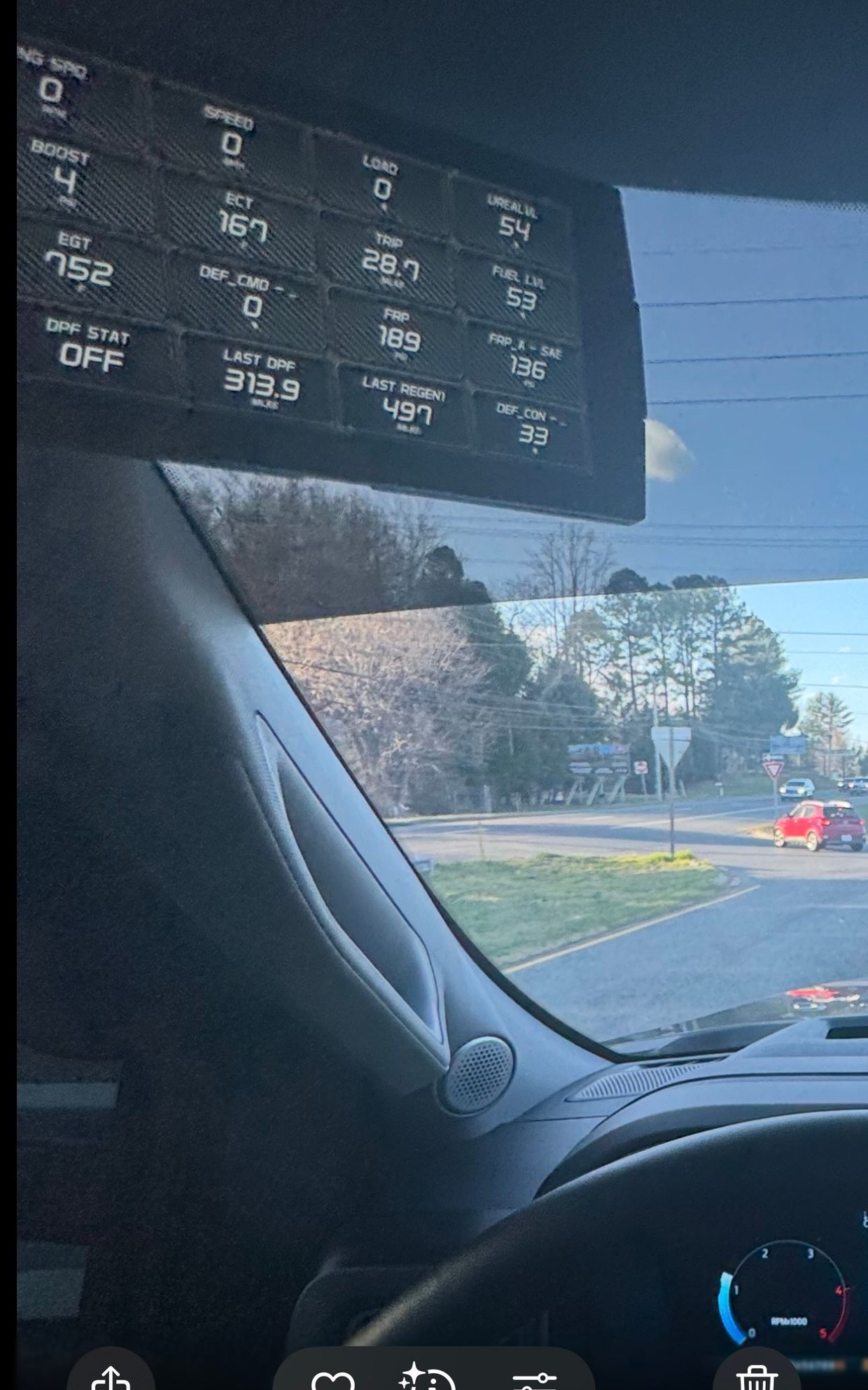

Just the Last Regen.
If you have a 23 or newer 6.7L engine, It will regen every 497miles
See bottom Right Corner on photo below

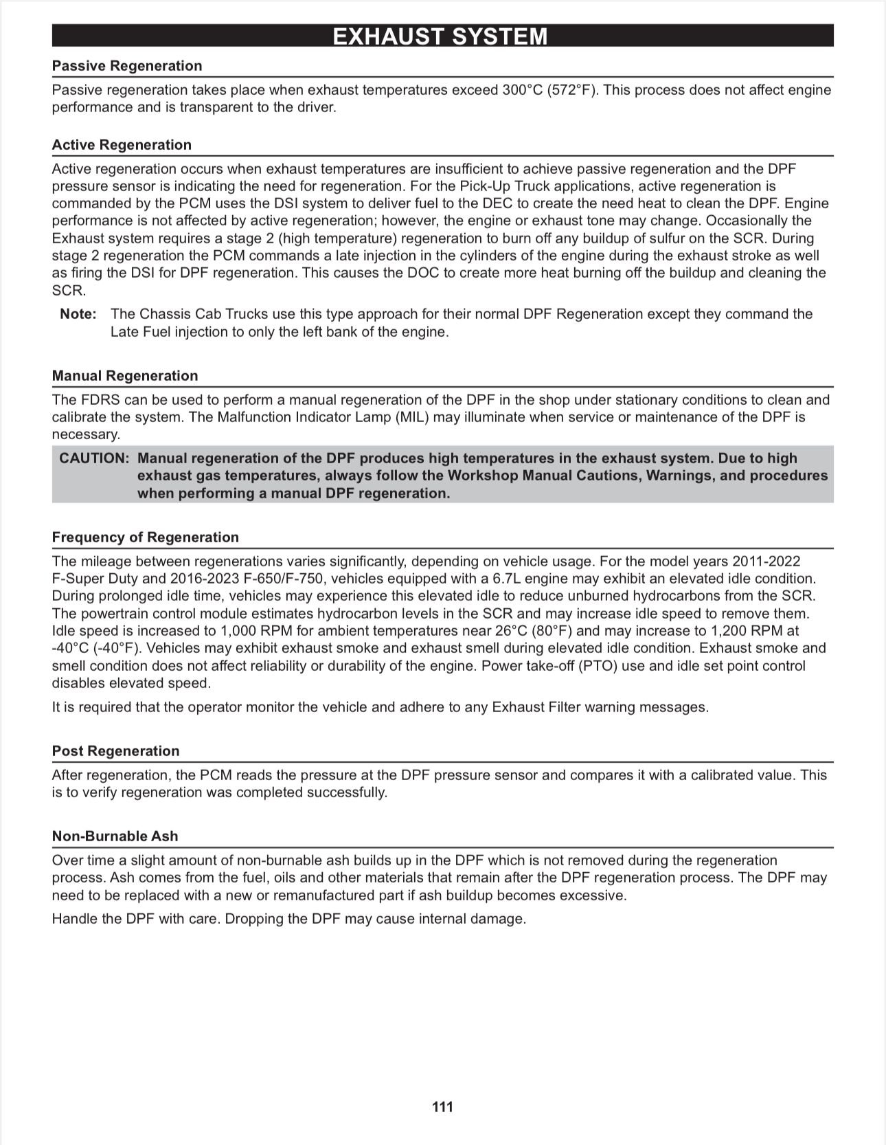

The 2023 6.7 CoffeeTable Manual has the following to say about Regeneration.
The section on Active Regeneration describes a Stage2 (or high temperature) regeneration, which adds fuel to the DPF injector, to clean the DPF, and adds fuel during the exhaust stroke, to burn sulfur in the SCR. I imagine a regular (Stage1?) regeneration under low engine load will not show elevated EGT, but a Stage2 will.
The CoffeeTable Manual doesn’t mention regens at 497miles regardless of soot levels, but my 2024 regens at 497 like clockwork. However, during my first 1000mile breakin period when I was driving very conservatively with no highway miles, the regens occurred before 497 miles. The soot gauge on the instrument console reached 101%. Since the breakin I haven’t seen an early regen and the instrument cluster gauge reads between 40 and 60% when a regen triggers. Presumably the value depends on how you drive.
